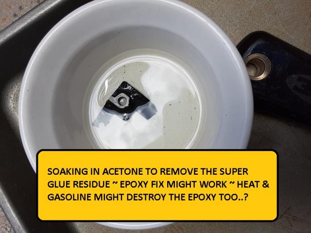

    EPOXY FIX ~ PHOTO STORY
  4. #79
    Your technique is good but I tend to agree with you - I don't think it's gonna like being exposed to fuel and heat simultaneously. The specs on epoxy claim it'll withstand fuel exposure and temperatures from 150 - 300 F but then that'll depend on how it's mixed and applied etc. Looking at the damage it's easy to figure out what happened. Either the wrong length screw was installed or it was overtightened. There appears to be a specific epoxy for fuel exposed parts but it might be subjective. The only alternative I can think of is in the too hard basket - building the damaged area up with JB weld and shaping it back and I have no idea if it'll want to stick to the carb body either. You'd have to be a renaissance master to mill and sculpt that out...

    The pin idea, hmmm (?) The household DIY 2 part epoxy I used is supposedly fuel resistant but it won't hold up to much heat... Google says there are 1 part epoxies good for 600°F and some RTV products that take the heat & fuel emmersion... Plan on spending $1,000 USD per pint or 10 oz tube for these products... EPA regulations require underground gasoline tanks be double walled & fiberglass epoxy type construction... So there are adhesives that can be emmersed in fuels & cooked, but none are in my tool box...
    It would be interesting to install this epoxied carb to see the results but I don't have a fire truck to follow me around...
    It will just be a
  7. #82
    Yeah, don't invite your truck to a barbeque. I don't know if this brittle resin will take to being tapped and threaded either. It's the reason why the brass inserts are moulded into the part. I used to do something similar when I was an injection moulder (I worked production runs on VN/VP Commodore tail light assemblies) and we had to fit metal inserts into the back housings. Nice job

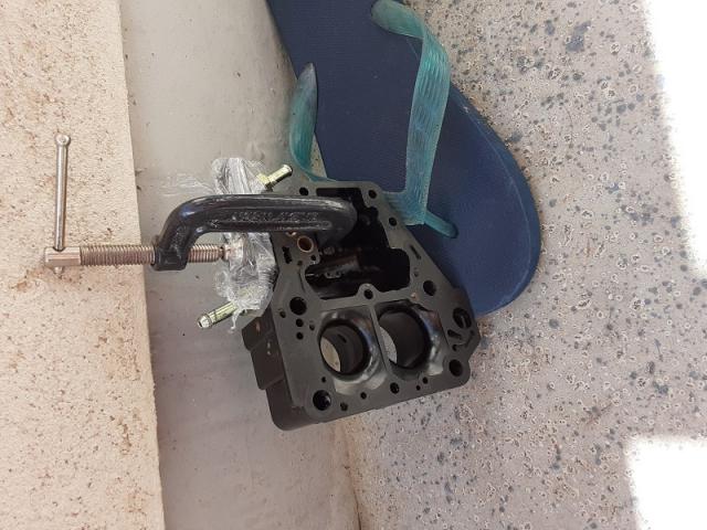

    DRY EPOXY RESULTS ~ LOTS-A-SANDING AHEAD
  12. #87
    The vapour lock thing is a result of not being able to pull a cool/cold air charge from outside of the engine bay. Mitsubishi trucks have an inlet duct on Gen 1's above the right side headlight frame in an attempt to alleviate lack of available dense air to mix for an air/fuel charge. This is why I don't recommend or use open element air intake cleaners. The fact that Toyota still used this forced air charging system means something was up and they didn't have a better fix for the issue. The EFI engine looks like that is nothing more than a standard barrel air cleaner with a MAF sensor in it (Mitsubishi used a similar air cleaner on early to mid 80's cars). I would disconnect the air duct from the inlet and extend it down towards somewhere below the frame rail and aim the end of it towards the front of the truck. The longer air duct increases torque, and being able to pull an air charge from somewhere that isn't getting heat soak from the radiator (hot air travelling up and what-not) should help. You could make the inlet solid using some off-the-shelf pvc plumbing pipe and elbow joins and clamp it down with brackets. Even go the extra mile and maybe wrap it with an insulating tape...
    The new carb fix looks like an improvement over the crazy glue patch up. Hopefully you'll put it back together and not have to rework it

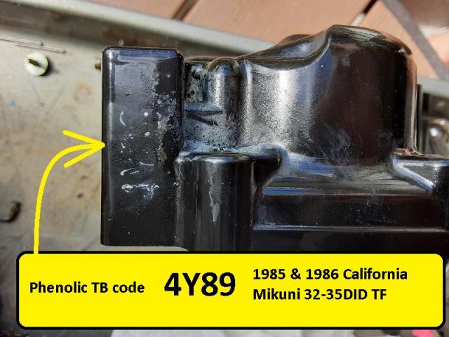

    PHOTO STORY OF TODAY'S PROGRESS ~

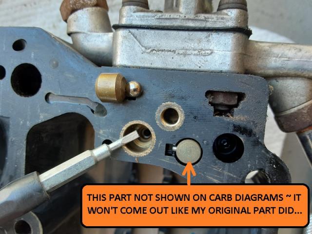

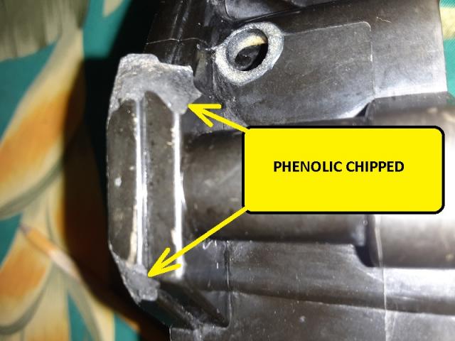

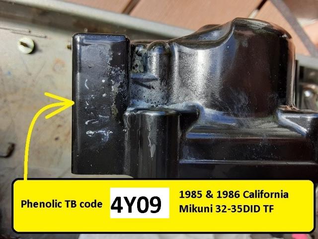

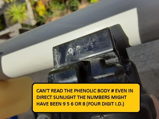

    NEED TO SALVAGE AND USE THE PHENOLIC BODY FROM THIS 1985 CARB TO GRAFT ONTO THE CARB PARTS OF MY 1986 ORIGINAL MIKUNI ~ I'M JUST GONNA LEAVE THE MYSTERY PART STAY IN IF IT WON'T COME OUT, DON'T WANNA CRACK OR BREAK THE PHENOLIC BODY... GOT TECHRON IN THE FUEL BOWL & ON THE TOP OF THE STUCK PART, MAYBE THE SOAK WILL FREE IT..? ANYONE HAPPEN TO KNOW MORE ABOUT THIS MYSTERY PART..?
    KEEPING SAFE --

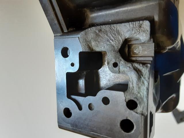

    PROGRESS PHOTOS TODAY ~ 2ND BATCH

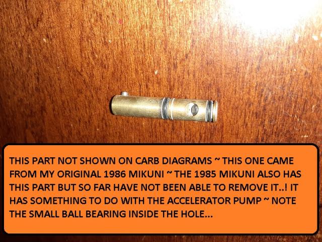

    GOT THE MYSTERY PART REMOVED AND CLEANED THE REPLACEMENT PENOLIC THROTTLE BODY ~ SOMETIME SOON WILL BEGIN ASSEMBLY OF A COMPLETE CARBURETOR (fingers X'd)

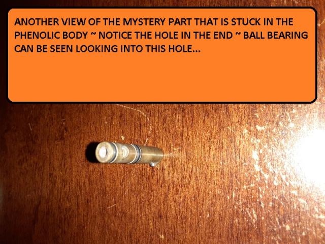

    The mystery part is yet another check valve. If you turn it upside down it restricts the gallery through it so will either shut off fuel. The engine could theoretically still pull adequate fuel through the accelerator pump to keep it running if you end up on your lid. Man, someone was rough with pulling this carb apart in the past...
  24. #99
    1,556
    Whew, almost 6 hours since my last post..! I can understand someone getting a belly full of carburetor work & banging on it, too tedious for my liking..! My wife is trying to get the 2nd super tiny O ring on the mystery check valve, she just got it after 20 minutes of frustration... Good thing we had a carburetor to cannibalize; lost the original float hinge pin... Noticed the J/Y carb float hinge pin fits snug but on my carburetor it fits loose like the one we lost also fit loose... Must be the phenolic body keeps it from falling out, it's really loose... Had to put the needle seat in twice to get the correct shim for float level... In doing so, could not follow FSM instructions to grab it by A not B area, hopefully the needle will not hang up on a burr..? That might be why the J/Y carb needle seat would not open & close dependably..? The float adjustment was way off on it too, fuel level very high I imagine...
    Thanks for Reading & Supporting especially solving the mystery, thanks geezer...
