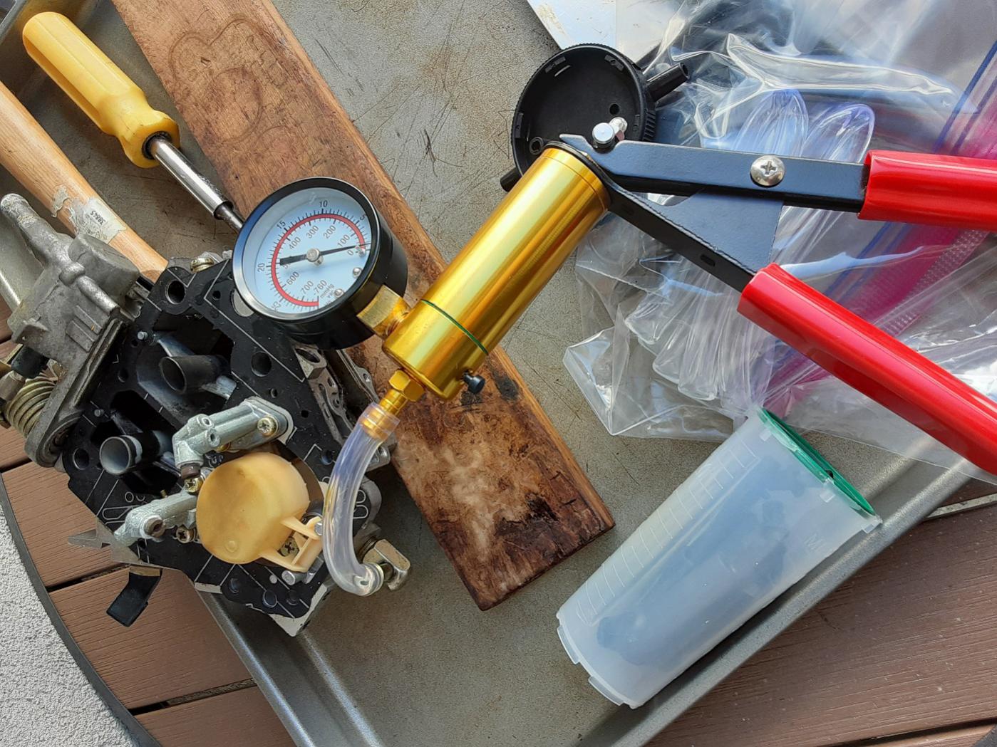

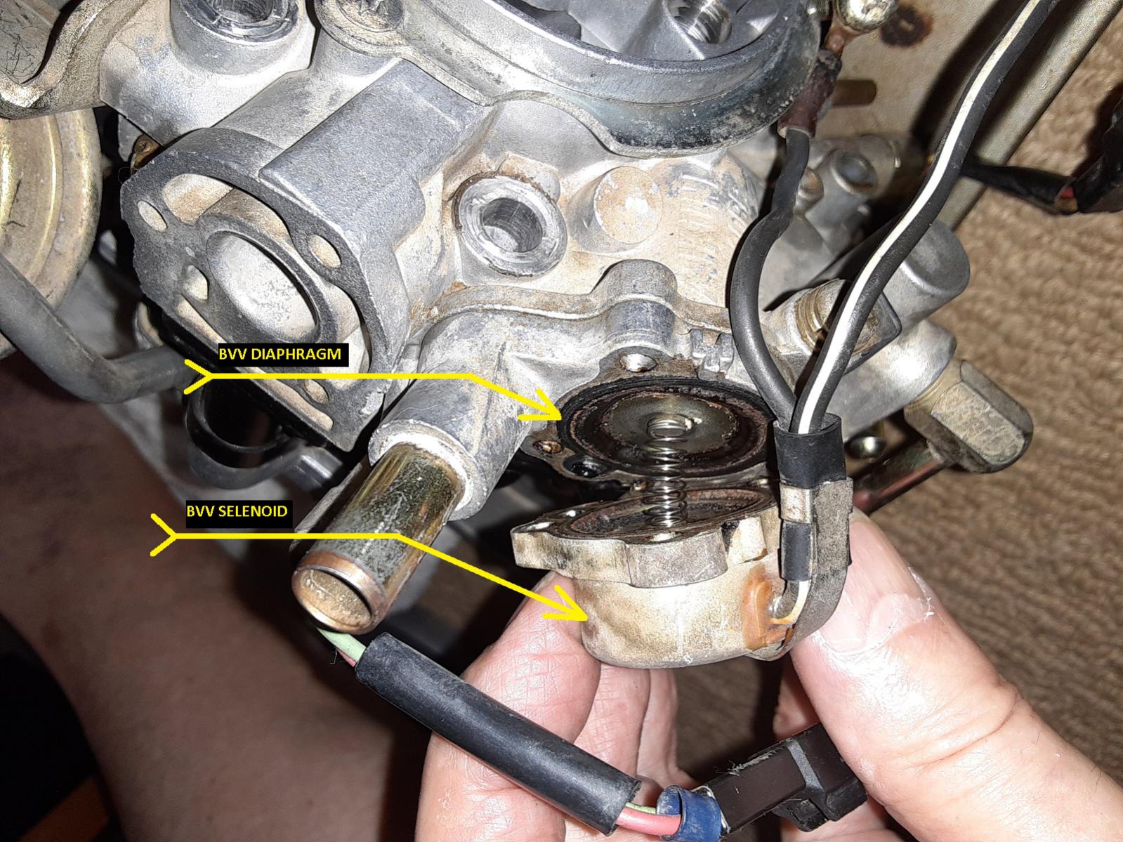

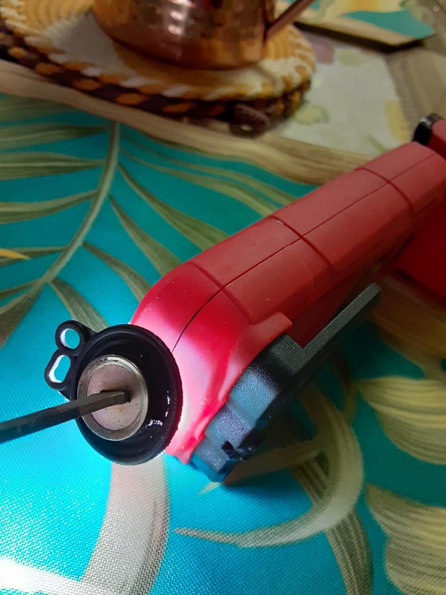

    What is the moving part of the BVV selenoid (?); the little hole that holds the spring OR the larger metal round surface area section, see PIC 3..? If anyone knows how to clean & test this selenoid please chime in... PICS:
    I could use help in knowing how to test any or all the selenoids on the carb; they had cracked "O" rings by the way... Hope I don't ruin the BVV selenoid as it will get cleaned one way or another which I hope does not destroy it..? There is a bunch crud & gunk around the inner perimiter that I want gone... Too bad I don't if PB Blaster OR carburetor cleaner spray would damage it or free up anything that might supposed to be a moving part..?

    The BVV part in your pictures is an electromagnet. When energized it pulls on the metal disk of the BVV diaphragm. At the other end of the diaphragm shaft is a donut shaped disc. The shaft goes through the center of the disc. To access and remove the diaphragm and disc, the top, air horn portion of the carb must be separated from the phenolic mixing body. Chances are the disc has degraded so the float bowl is always exposed to atmospheric pressure and that’s causing the rich condition. Before you remove the disc, note the direction of the slightly tapered end. Fortunately the disc and diaphragm are inexpensive and available on eBay so consider replacing them even if they look okay.

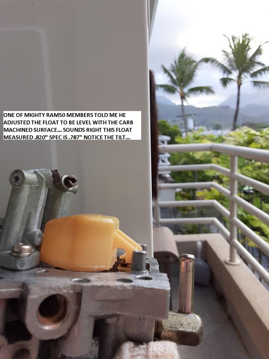

    1) I noticed the new float I got from Rock Auto is not really the same as my original; it's different enough that making the same float adjustment would change the bowl fuel level quite a bit... At this point, I am considering not doing anything to the original existing needle seat filter or float except take the float adjustment measurement and call it good (thinking my poor batting average) Oh, I do have a hand vacuum pump which I think can be used to test the needle seat for any leakage; I should do that too...

    1. If your uncertain about the new float and the old one doesn't leak, use the old one. Inspect the float needle and seat for wear. If none and they pass your vacuum test, you can get by reusing them. However, if the needle is rubber tipped, try using the new one if it doesn't affect the float height and passes the vacuum test.

    3. The ball bearing and metal arms in the float bowl are a safety measure on 4x4 trucks in the event of a roll-over. When you're upside-down, they push on the float thereby shutting off the fuel flow. Like some of the major carb rebuilders, you can omit them without consequence.

    Here are the ebay listings for the diaphragm and cap (I called a disc) I think you need and mentioned in my previous post:
    Diaphram:
    https://www.ebay.com/itm/Mikuni-Sole...UAAOSwO9dfAKzT
    Diaphragm cap:
    https://www.ebay.com/itm/TOMCO-7410-....c100005.m1851
    And here's a listing for the entire BVV that might fit:
    https://www.ebay.com/itm/NOS-Mitsubi...gAAOSwZ8ZW~Itk

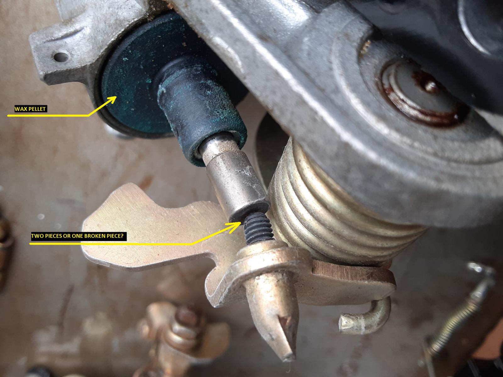

    The trapped ball in the bottom of the float bowl is a roll over ball to cut the fuel off.
    The best stuff to clean carbon in any EGR is Techron. Just get a bottle from the local parts store. It melts it with in seconds. What ever is left over you can dump in the tank.
    As for the thermal wax just place the carb in hot water from the stove.
    DO NOT DO IT UNLESS YOU HAVE THE CHOKE SPRING IN PLACE AND THE CHOKE WORKING.
    It will expand if it's good. When that takes a crap you are screwed. or if it pops out because you didn't have it contained in place by the choke spring. (I found that out the hard way.) It's not available anymore. If you remove it there is an O ring that seals the water that flows through the carb. (I found that out the hard way.) Pulled it out and water shot out. The spring that pushes on it, is super strong.

    Wax pellets are nearly extinct. Did find this though - https://www.ebay.com.au/itm/MIKUNI-S...-/202047203128
    Anyone got a spare $154.50 AUD lying around for one?

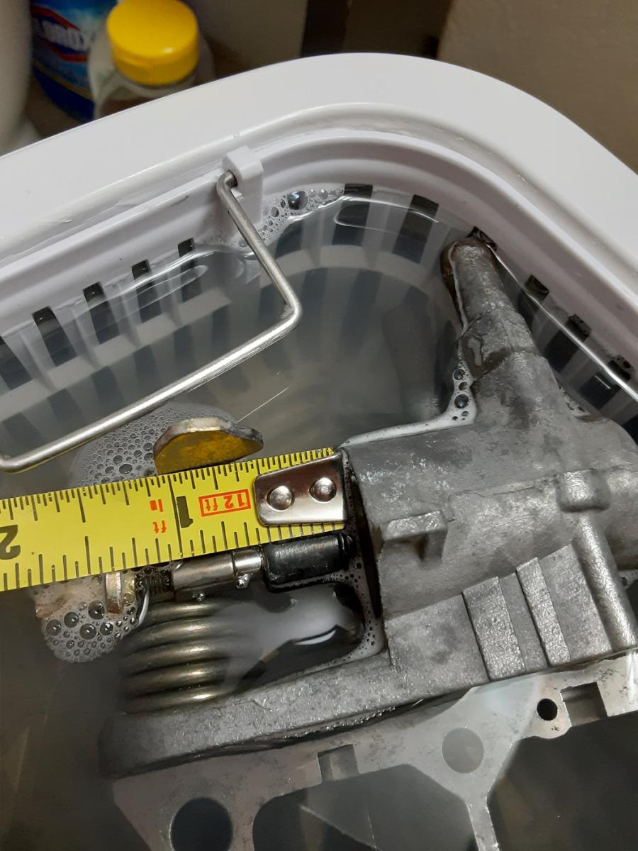

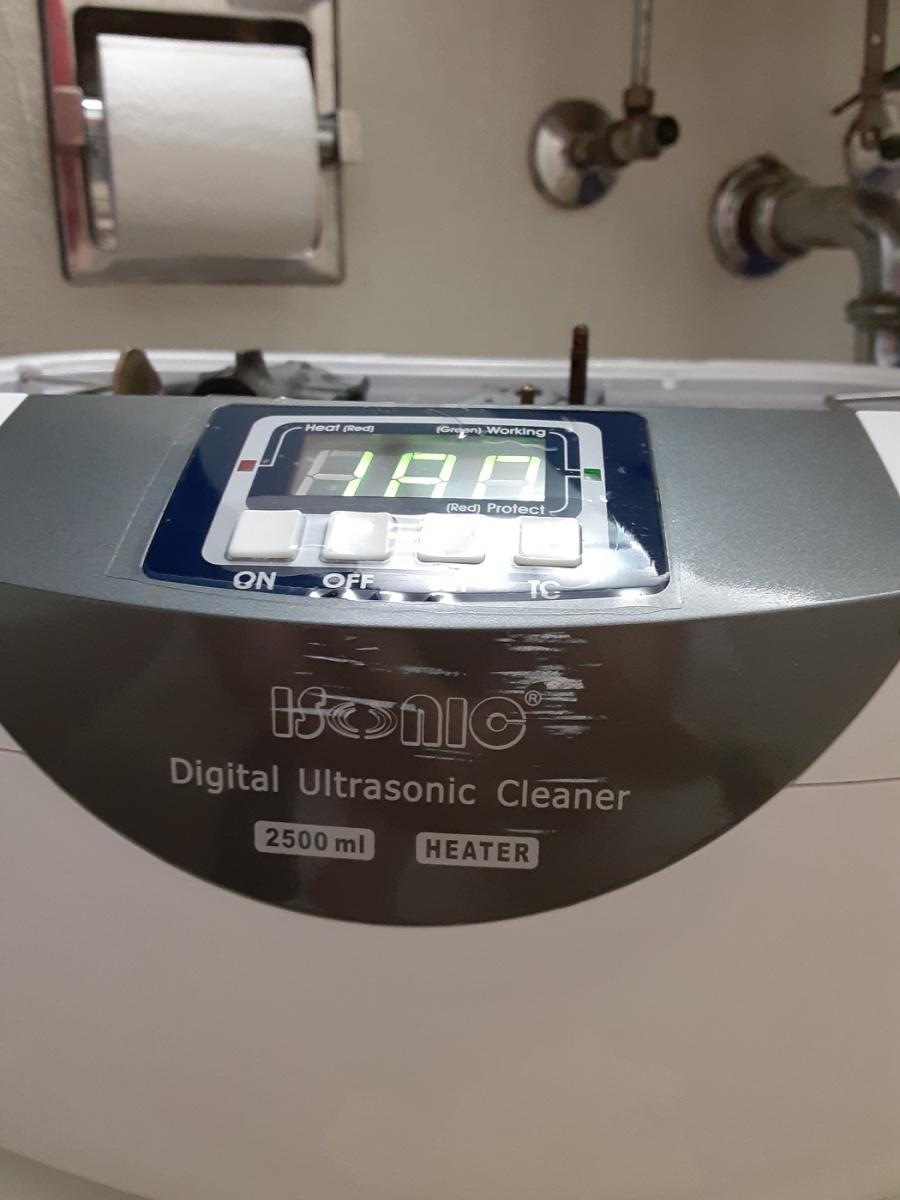

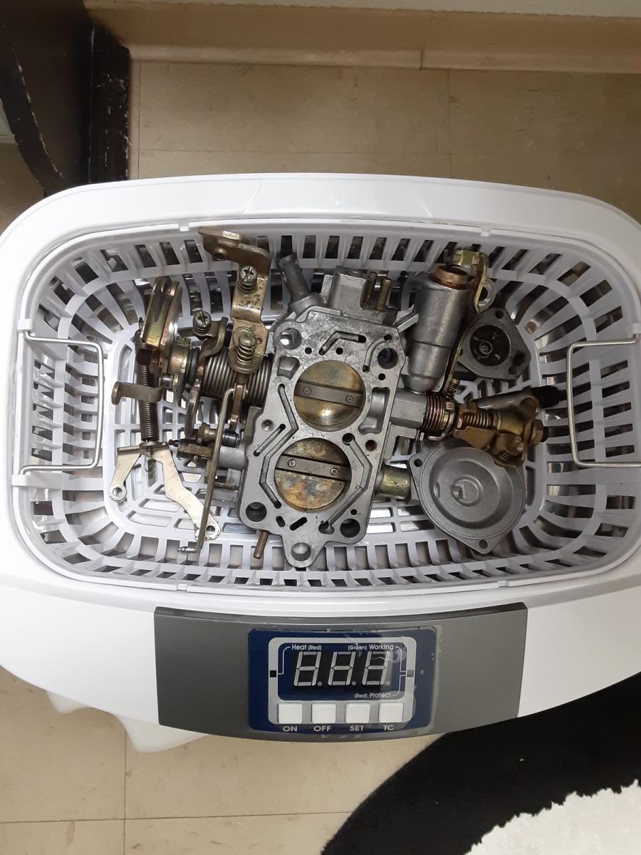

    The ultrasonic cleaner won't remove the black crud or carbon, carb cleaner and brushing/scraping takes it off... But the bath water does get dirty so it does clean somewhat... Am hoping the other parts will fit into the tank as well as the bottom carb section...

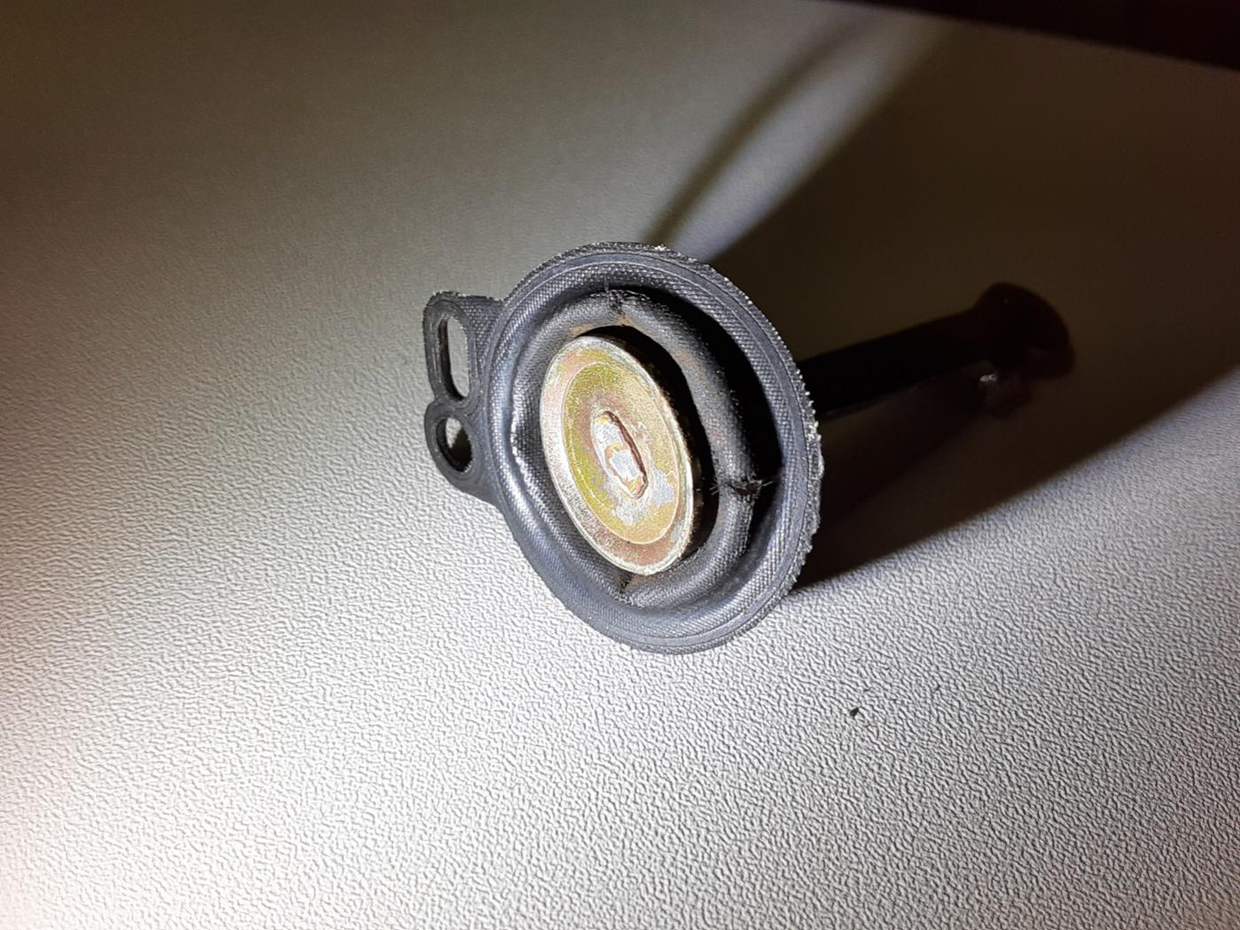

    The auto choke release assist will also cause internal vac metering issues when they fail. This gadget is like $35 AUD by itself (when you can find one)

    Maybe (?) vacuum metering issues could be caused if any software part under vacuum were to leak (?) (O rings diaphragms valve disks vacuum hoses etc...)
    Ordered a new choke breaker diaphragm from ebay: https://www.ebay.com/itm/333644647956
    So far these software items leaked vacuum in my original carbydisassembly visual inspection, vacuum test & engine operation confirmed):
    1) Secondary throttle actuator depression chamber (did not open the secondary butterflies)
    2) Choke breaker pull off diaphragm (rottened, did not operate the choke butterfly)
    3) Three of the four DSV ESV JSV selenoids had broken O rings (not sure the effect)

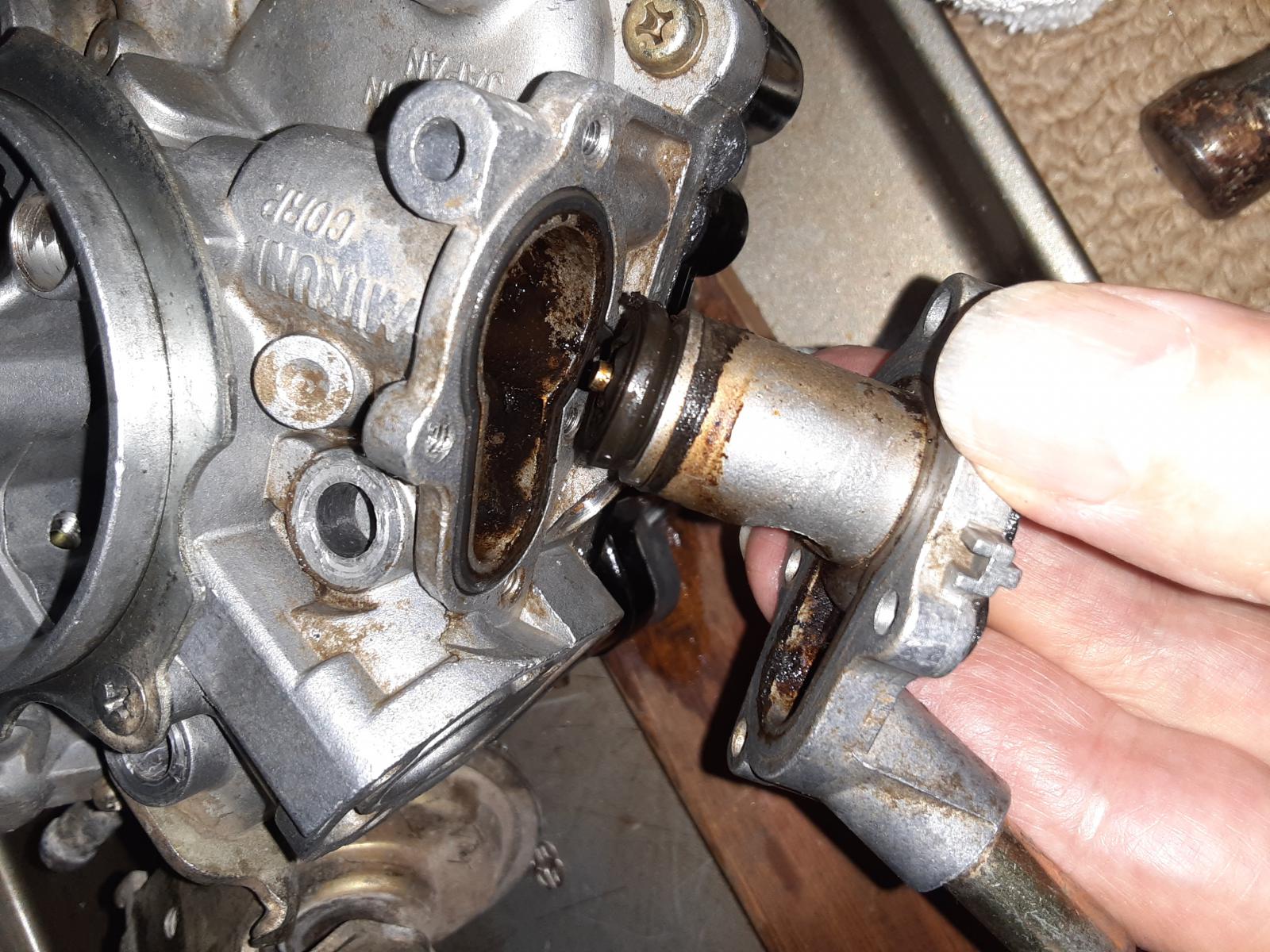

    4) The BVV bowl vent valve O ring (totally shot 'n gunked up the BVV diaphragm)
