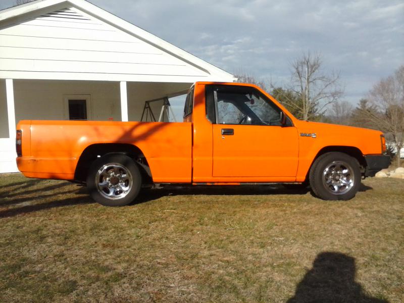

    So I bought my truck this past Friday for only $500. she has 192,303mi. on her. the guy wanted $750 but it didn't take any haggling to get him down. After an hour at the DMV and a few minutes at State Farm, it was officially mine and legal and good to go.
    What I've done so far:
    changed out vacuum lines
    changed air filter
    new spark plugs(had 2 dif. kinds, 2 weren't screwed in and 3 wires weren't even connected)
    changed some blown fuses

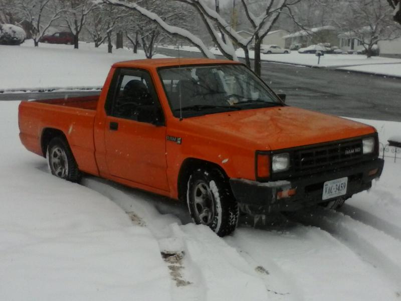

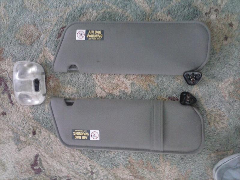

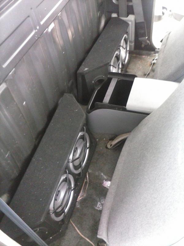

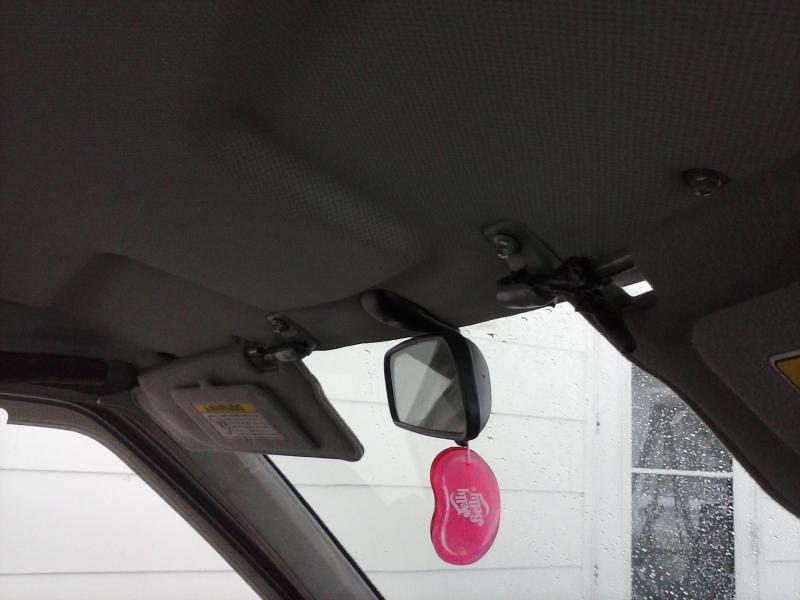

    Im pretty sure the head liner isn't stock because it doesn't seem to fit, and the interior light is small and crummy and my visors are held up with zip ties, my dads ranger blew this past weekend and the scrap yard picked it up Monday so I snagged the visors and interior light from it to put in mine.
    1,273

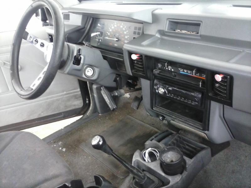

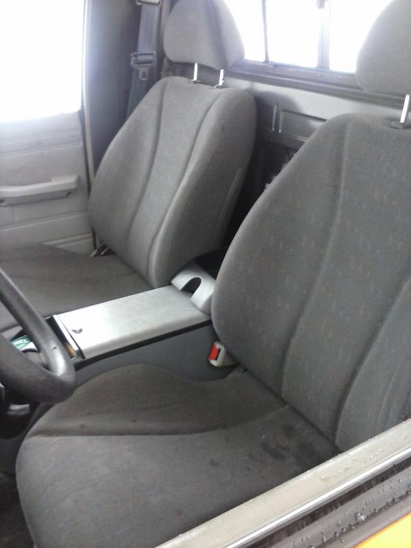

    Awesome! I am envious of the bucket seats and console...but those will come to me, some day. (Along with the sports cluster).
    Trucks amazingly good on that snow, isn't it!?

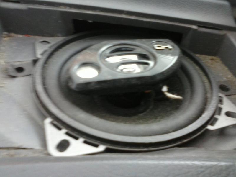

    With those speakers placed there, you'll never have problems with constipation!
    You might appreciate an after-market, windsheild-mounted rear view mirror.
    Looks in amazingly good condition, RamBam...nice find for an excellent price!

    thanks, seats are from a dodge neon, there's a small tear on drivers side you can see right when ya open the door but hey it beats the bench IMO and there not too bad for a big guy(6'2").
    yeah the speakers came with it, theres some kind of 4" in the dash too but never heard of that brand either. ive got an amp floatin around somewhere ill eventually throw in it.

    also the console is at Walmart I believe
    1,273
    Thanks for the bucket seat info: I'll know to look for Neon seats.
    As for the console, I'll eventually fabricate my own out of wood. The one I have now serves its purpose, but I'm looking forward to utilizing the space buckets seats provide. Should I happen to find an original stock console, I'd likely use it to keep the truck stock. Consoles can be worthless catch-alls, and I try to minimize the clutter that accumilates in such a small cab (in the F-150, too). My neighbor cleans his vehicle out once every Mayan calendar cycle: he has McDonlad's bags that the Smithsonian has wanted for years.

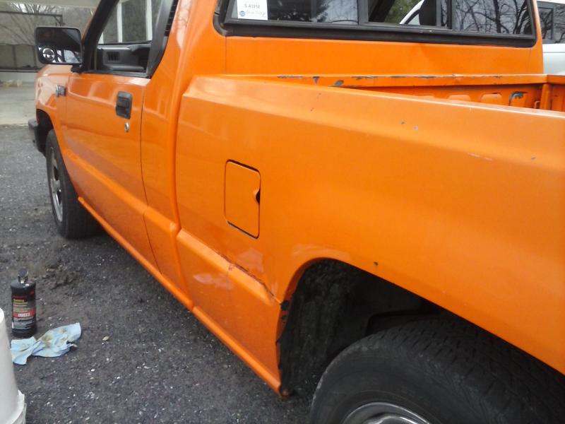

    ok now that my daily "hate my truck" rant is over, I did wash her up and get her clean. so I have pics of that so you can see how dull the paint is. and out in the building was the front valance of my dads ranger he had and it will fit nicely on mine.

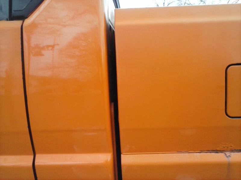

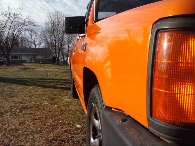

    I painted the ranger valance today and finished doing the whole cab with the 3m compound, and then turtle wax. I took a pic that compares the bed(havents done anything but wash it) and the cab after compound and wax.
    Your truck looks fine, don't give it a bad mojo by talking mean to it. Every time I look at it I think of orange juice.
    Be sure to put that valance on tight. I have had one fly off on freeway on another car.

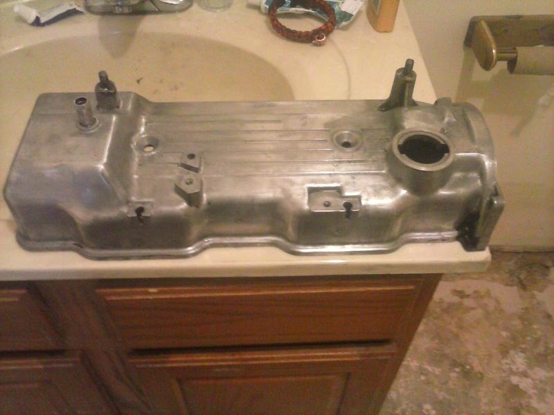

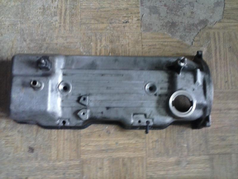

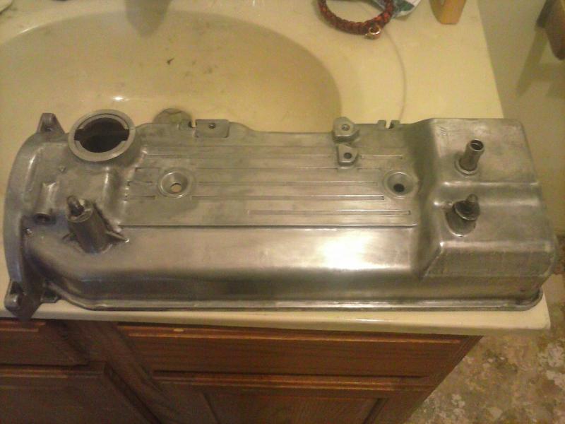

    You were admiring how shiney my valve cover is: just use the one you have, get the job done. I have one here you can take your time to clean up, and swap later.

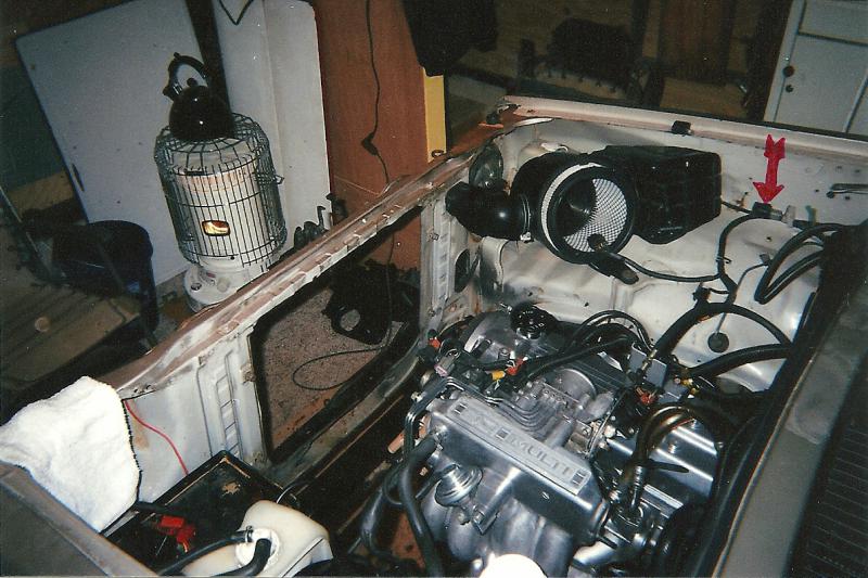

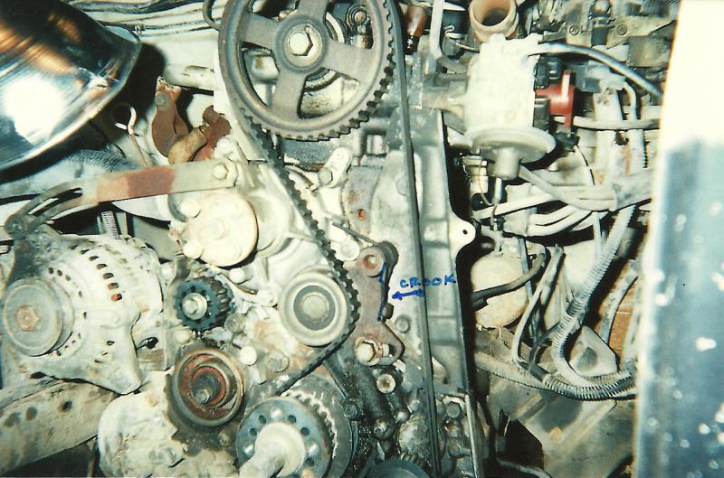

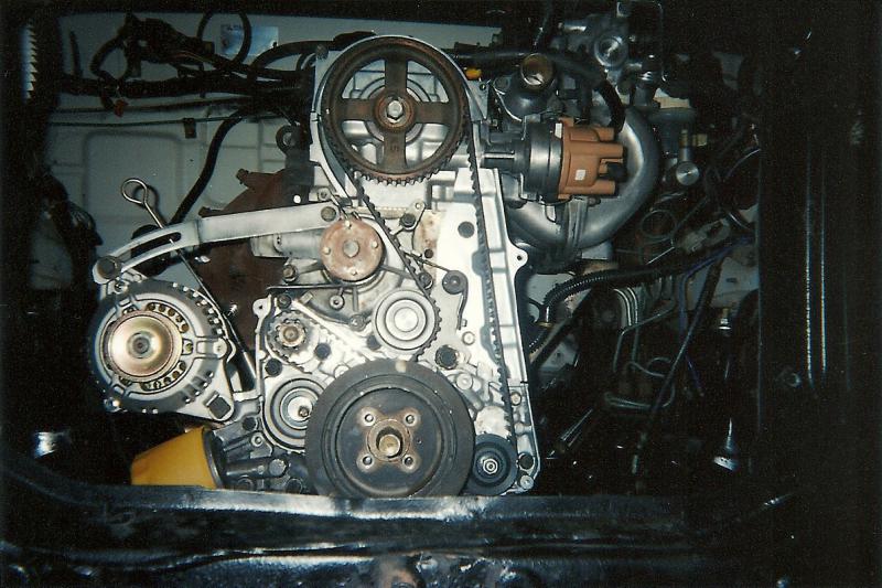

    A couple photos for referrence.

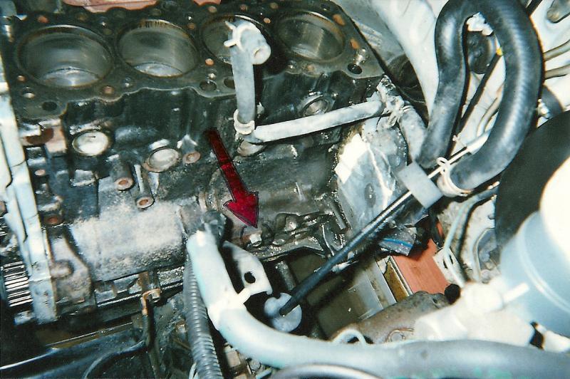

    Red arrow shows you the silent shaft plug. BE SURE TO REMOVE YOUR SCREWDRIVER when you finish, and put the bolt back.
    (Left) "Crook" shows spring placement: (Right)Red arrow shows the jumper connection for timing, remember I showed you on the parts truck. Manual has info, more details at Roy's Garage.

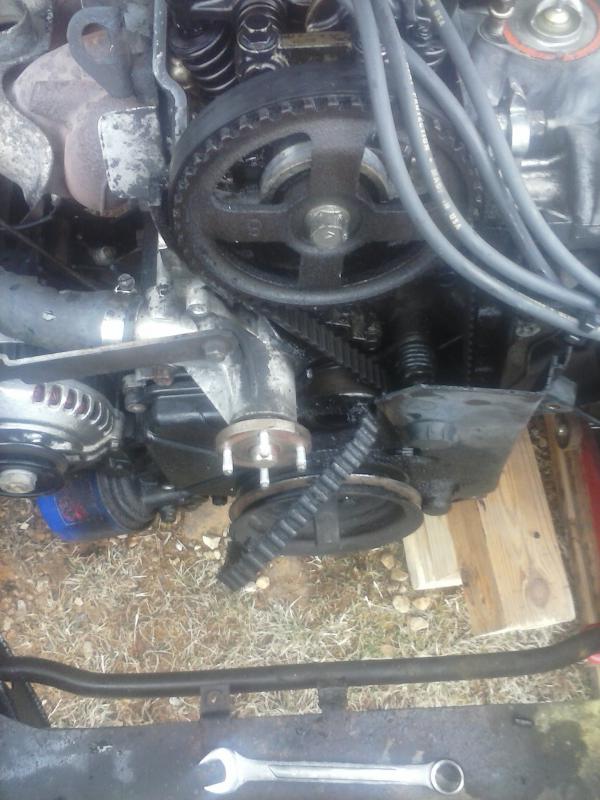

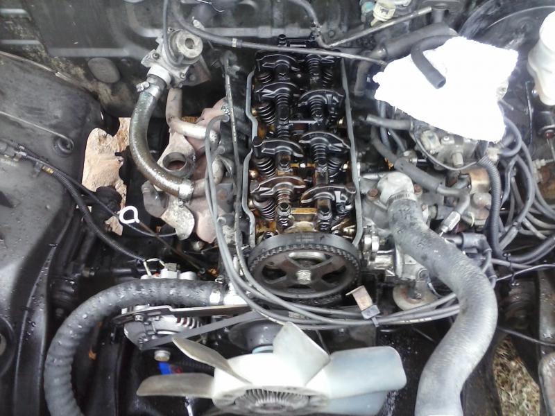

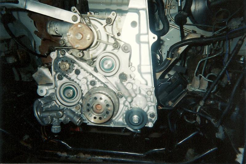

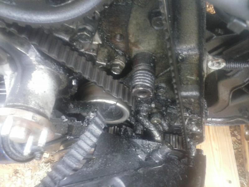

    so far today ive gotten to the point of almost gettin the harmonic balancer off, however, theres one last bolt thats decided the socket wont grip it and its starting to round off :/
    also the smaller timing belt i found just chillin in there shredded to hell. along with a years worth of oil and grease and plenty of shavings and crud down in there. i wont know how bad the situation is fully until i get the balancer off to get the cover fully off. and for now this is as clean as ive gotten my valve cover, ill get some clay and a drill attachment tomorrow maybe and get her lookin like a mirror along with the thermo housing and if im feelin spunky enough later this week to get the intake mani off i might polish that up too. after i go put some PBblaster on the balancer bolt ill prolly call it quits for the day and go ease my mind of these troubles.

    Put the straw on that PB Blaster and get some dribble-down from the upper bolt hole, above the stubborn bolt. Once you PB Blasted the bolt good, get the other three bolts back in tight, and tap on the stubborn bolt lightly, to cause some vibration, so's the Blaster can get in there.
    I'll be bringing you the gear assembly from my 2.0 and I'll bring the bolts for the pulley, so you don't have to use the old bolt.
    There is no question about the timing issue...what's the right-side of the timing belt feeling like? I don't doubt that with the broken belt and all that grease, it's slipped time a tooth or two, and the tensioned-side is slack. Though the existing belt may be in good shape, please DON'T attempt to re-use it. Once you get it off, i bet you find some serious damages to it.
