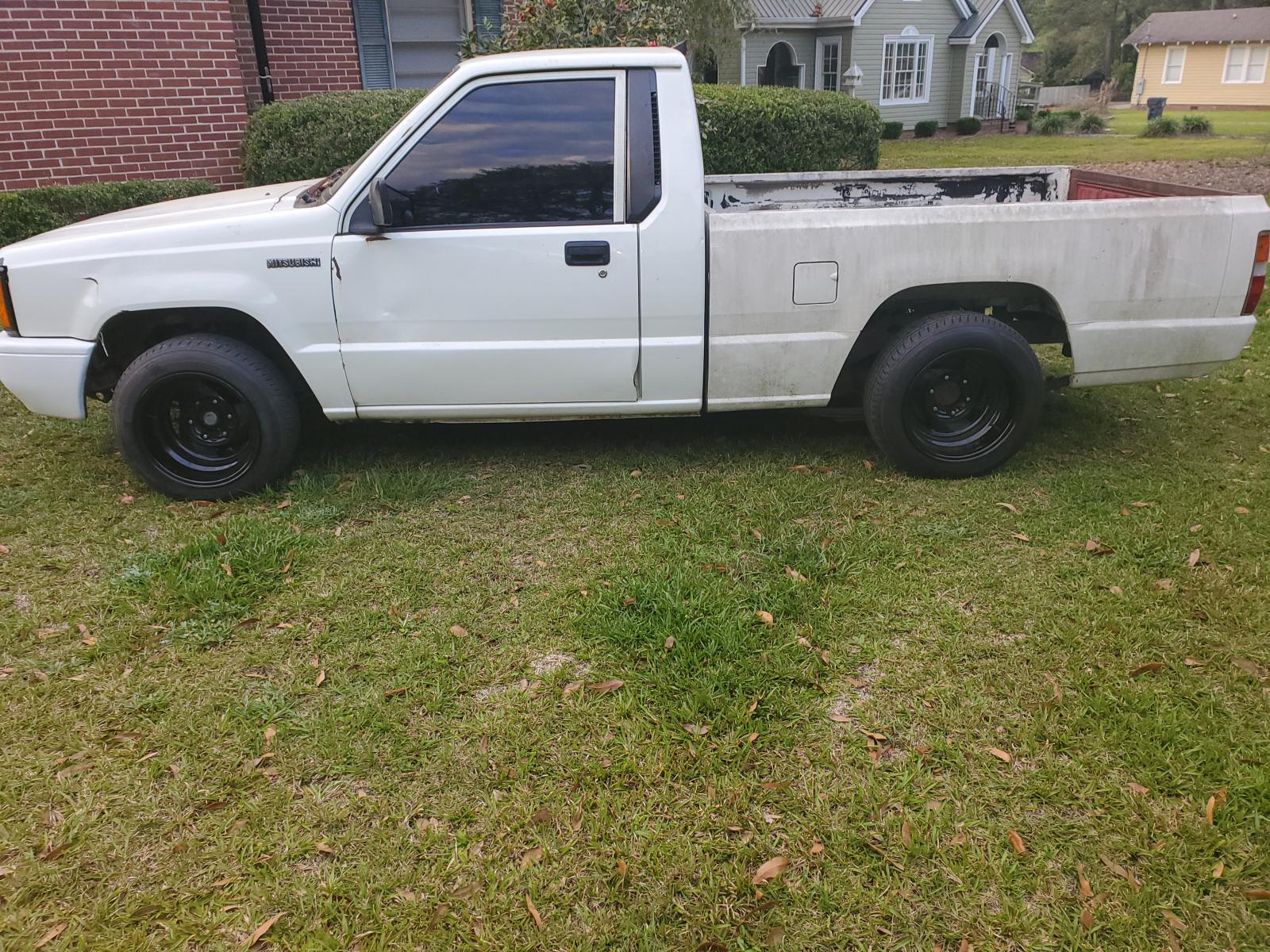

    New Wheels, Old Bumper, Bigger Tires
    New wheels, smaller tires, lowering blocks, new bed, and new painted bumper. (It's dirty and I need to figure my fenders out for larger tires.)
    The wheels look great. IMO you're gonna need flares on it (some pretty crazy ones too) but the contrast between the gloss black wheels and white bodywork really stands out.
    1,222
    some pretty wild offset on the front there. Might pay to keep an eye on your wheel bearings

    Geezer101 thanks! Yeah me and a bud are thinking about doing some custom fenders/wide body to blend into the body. I really want to do sheet metal. I know most people use fiberglass, but I'm not really too worried on weight. I'm still debating.
    Tortron, yeah luckily when I changed some studs I found that the wheel bearings were new with fresh grease. I'll be routinely checking them and my ball joints every other oil change for wear. I just really like the offset, and a little faster wear on parts is fine with me on it.

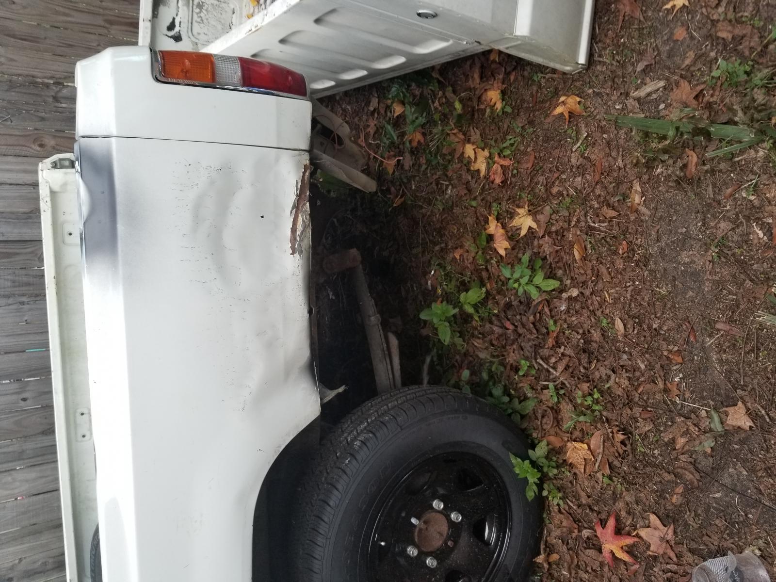

    Yeah unfortunately they salvaged it out for a messed up bedside and bumper years before I bought it.
