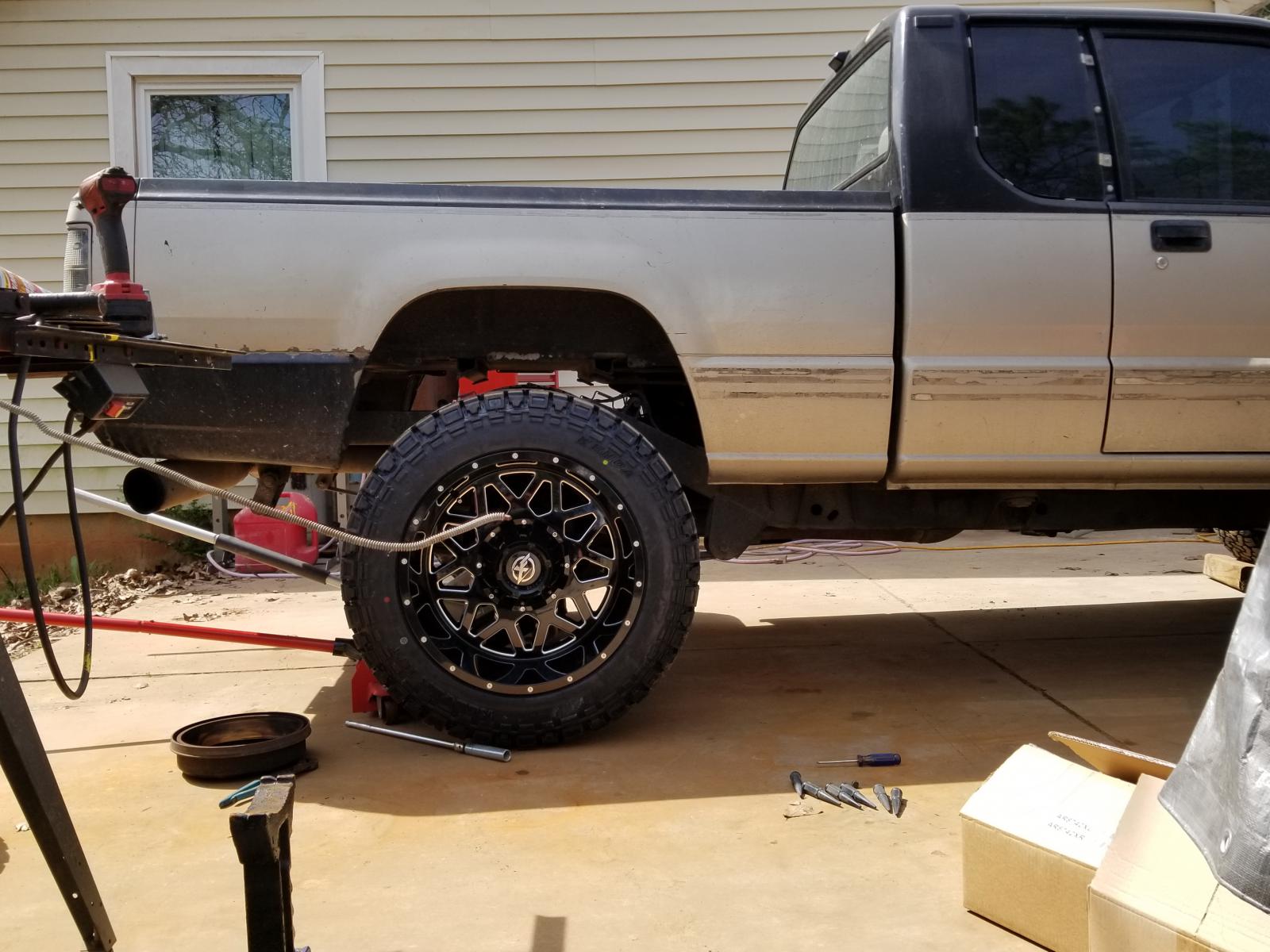

    Gotta see those mounted to your truck! They look tough as

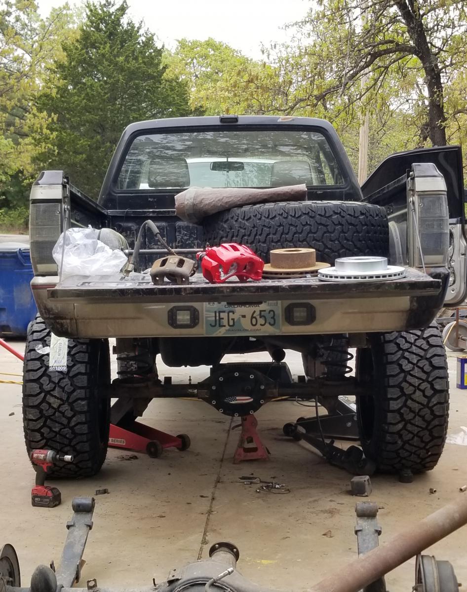

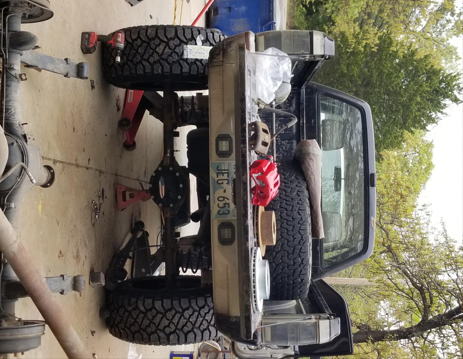

    I'm working on it!! Trust me it caint go any faster! Just got the rear end done,knock out the front gears then it's time for the good stuff!20200327_150535.jpg20200327_152709.jpg

    I recieved my brakes today... this is why jeep people with older jeeps do the WJ knuckle swap! 3 reasons I know of to start
    #120200329_134852.jpg bigger rotors!
    #220200329_134946.jpg dual piston calipers! Number three will show up when it's time for steering
