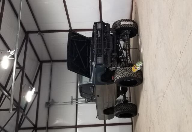

    Well,its been awhile since I've been able to do much to the truck. But here is an updated photo of the progress so far.20201129_220639.jpg

    Looking nice!

    Nice SAS!
