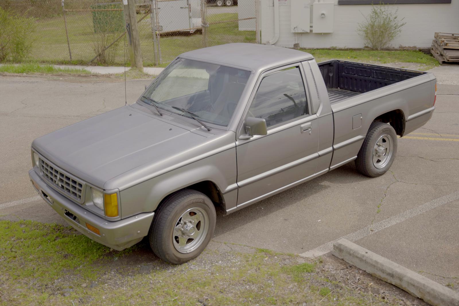

    Hello! Picked up a 92 auto, with about 80k on it!
    Now I'm experiencing the adventure of out of production exhaust manifolds and a series of rusted bolts and broken studs, hooray! Truck runs pretty good otherwise, gets me to the hardware store and back anyway.

    Howdy, and welcome to the forum!! Do be sure to post some photos of that truck - we always love to see 'em!!
    Hi and welcome to mightyram. I believe the aftermarket headers for the G63B will bolt up if you head is a paired port in/ex. There are other options - I think the headers for a Montero sport (?) will work. Someone will chime in on that to confirm. Aftermarket headers will be a nice upgrade anyway over the stock cast manifold.

    Jrecee, welcome & thanks for posting pics of your straight truck, looks good You have a blank canvas to work with
    May I make a comment (without malice) as a senior citizen with poor eyesight & slow reaction time; it would be a challenge (for me) to see your truck on the road... Especially on overcast or cloudy days it blends into most backgrounds; I often miss seeing silver colored cars... My ex wife had a totalled silver colored 1994 Toyota Corolla; the guy that hit her said: "I didn't see you"... It would help me to see your truck if it had, tire shine, polished wheels, bright lights, racing graphics (any color other than silver) just saying, ok... I've started to make a habit of turning on my headlights because just driving scares me anymore; other drivers dart around so dang fast... Hope they see me..?

    Ha! I'm with you on that, my other car is orange. Normally I'd never buy one in this color but the price was right! It's growing on me.
    I have spent hours digging through the forum on manifold solutions and did come across the guy in California who has built the customs in the past, I am considering that since I know it would last a lifetime. The issue right now is the disintegrating seals. The main leak is right where the stud broke off, unfortunately I'm quite sure with their condition, that the others will break as well when removal is attempted. I have a quote to remove and repair it around $300. I suppose I could just go for that and once studs are repaired swapping with the custom header at a later date would be pretty easy.
    DG no longer makes that header - lack of demand.

    Thanks for the info! It looks like the manifold gaskets were successfully replaced and the manifold isn't cracked or anything. Hopefully I'm good to go for a while!
