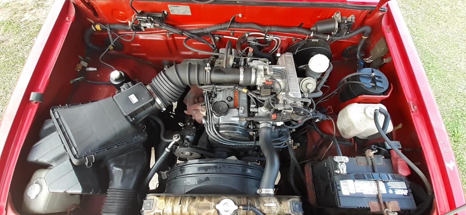

    Names Kevin, Ive been a long time reader and its time to get my feet wet with a build this coming summer. I've read just about every thread within the 2G section and have a good idea of what Id like to do. I'm curious to what direction you guys would go and want some feedback. I have a clean slate vehicle with no modifications made. Nice to meet everyone and looking forward to this project.

    Ive drove it daily for about the last year and during that time I replaced both timing belts, waterpump and had the starter rebuilt.
    Hi and welcome to mightyram. I wouldn't worry about anyone else would do with your truck - like you said it's a clean slate. If you want to keep it reliable and easy to live with but get a little more out of the stock engine, I'd source headers for it, an exhaust upgrade to maybe 2.25/2.5" and retune the ignition and replaced anything that is getting tired (ignition coil, suspension, brakes etc) The paint should bounce back after a good clean and a couple of layers of wax polish (if the paint feels grainy and rough, a clay bar will make a big difference) The engine bay is nice and clean! Post pics, keep us up to date and ask questions!

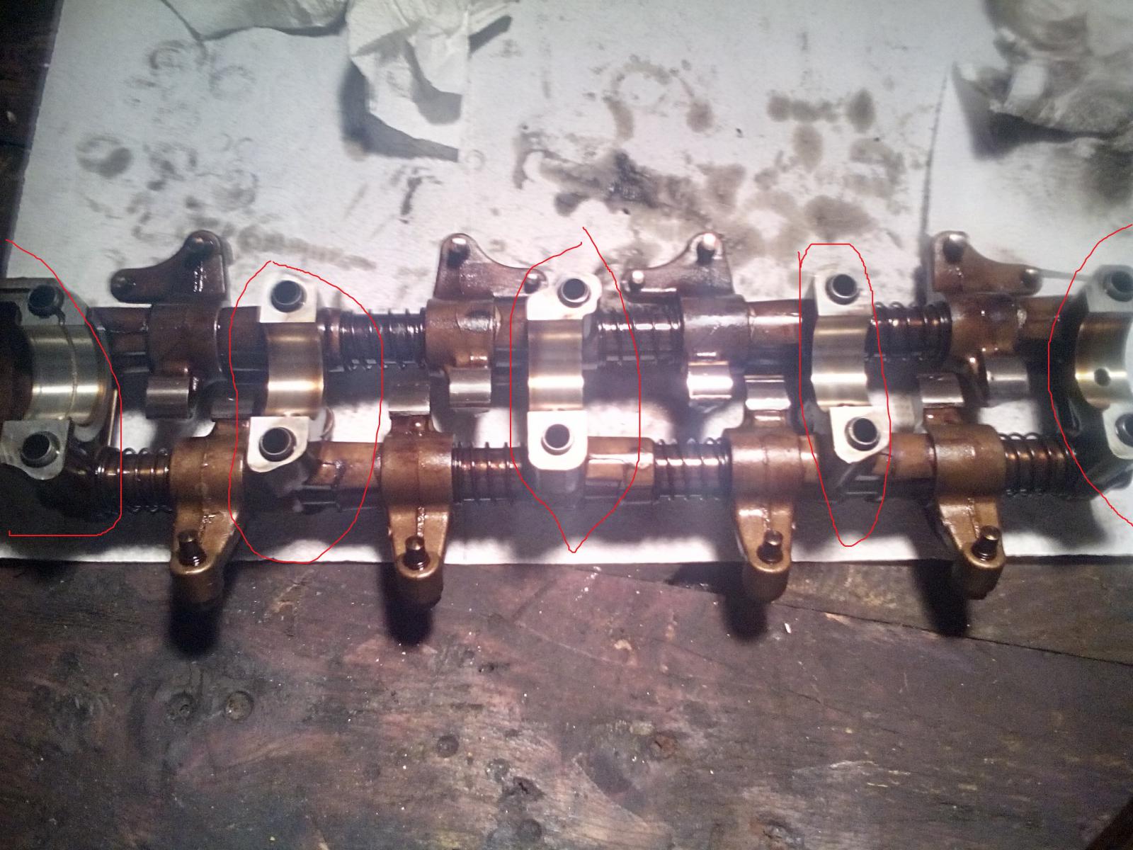

    another mod witch i believe is worth doing is swapping the lash adjusters for a set of manually adjusted ones. the truck will sound like a little diesel but makes more power and gets better gas millage. this is one of the first things i did to my trucks. also replace the valve stem seals while in there. next thing you should do is replace the fuel filter on it. try and get a good filter and not the cheapest autozone brand.

    Mechanical lash adjusters/lifters have advantages over hydraulic. You can get them to run quietly but you have to throw the rule book (or in this case, the workshop manual) out the window by adjusting them hot by feel. It'll take a little while to get it right but you can get them to run near silently. I am not sure if you can just 'swap' the hydraulics for mechanicals though - the heads on these engines are oil pressure eccentric and might do weird things - what did you use for donor parts finalfighter (what was the original engine application, rocker ratio etc?) 90% of Mitsubishi engines using oil or blowing smoke especially at take off from the lights is caused by bad valve stem seals so that's a good call from finalfighter. You can retune OBD I/II engines without a timing light (other than to check base timing) by running the engine @ approx 2000 rpm and gently swinging the distributor between advance/retard until you get the engine rpm to spike by itself. Find the sweet spot, lock the distributor adjustment up and you should find some useable extra torque and throttle response (I'd advise regapping the plugs to 0.85 mm and use premium fuel as well)

    for the lifters is get them out of 84 and under 2.0l mm/d50s. i use all the hardware except for the parts circled. for those i use the ones that are already on the the truck.
