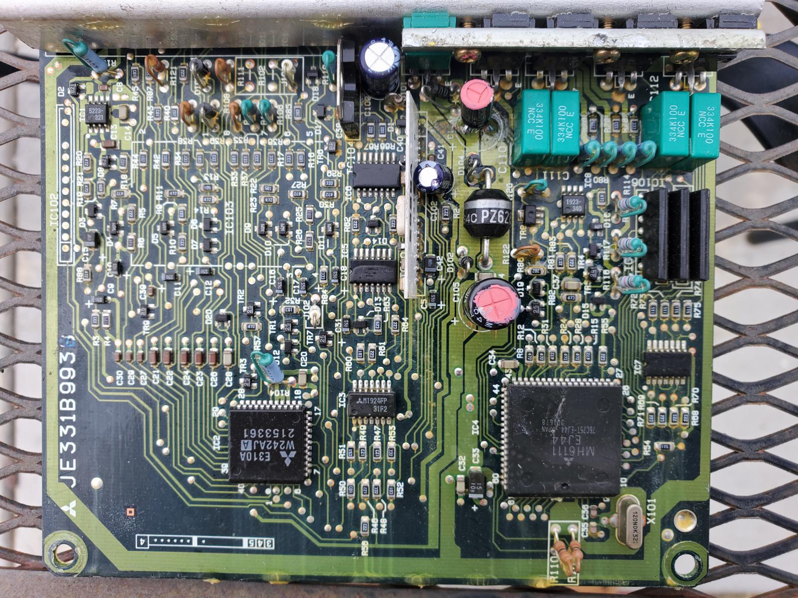

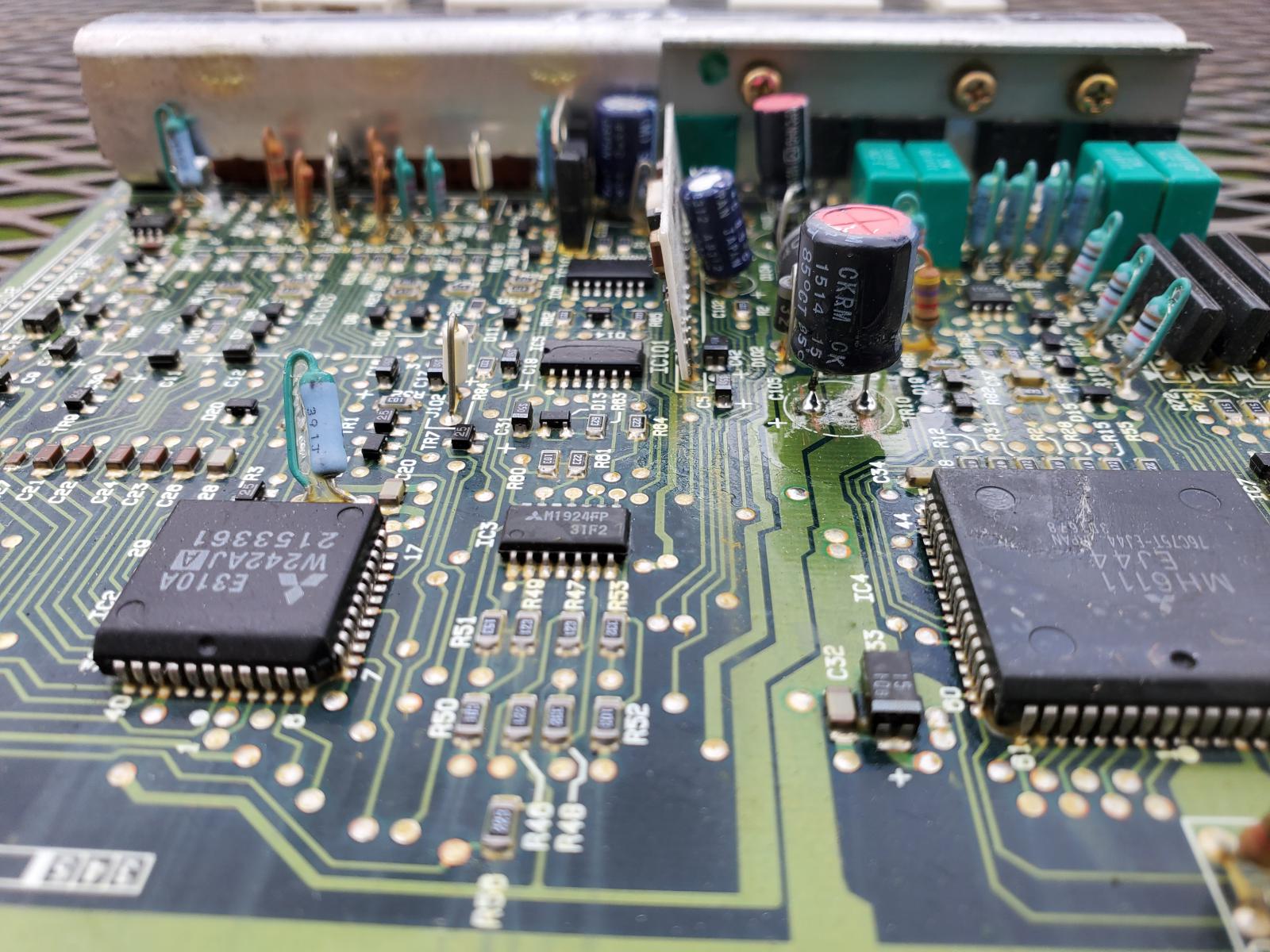

    Definitely a rebuild ECU. Pics below:

    so they rebuilt your old ecm and sent it back to you? its possible the ecm coil driver went bad and it just wont work even if the caps got replaced. if you are getting fuel the distributor should be working. the ecm uses the signal from the distributor to work the injectors and the ignition. sense you are getting fuel its not the distributor.
    it looks like you need a new ecm. grab this one https://www.ebay.com/itm/1991-1992-M...wAAOSwPqleKYmd

    I don't know what other members' opinions are of those pics but there's a lot of brown funk on some of the soldered joints and the board appears to be scratched up under the caps. Are you able to pull codes from it?

    as for the ecm, thats pretty normal on theses when exposed to lots of moisture. it usually does not present a problem. ive seen worse.
