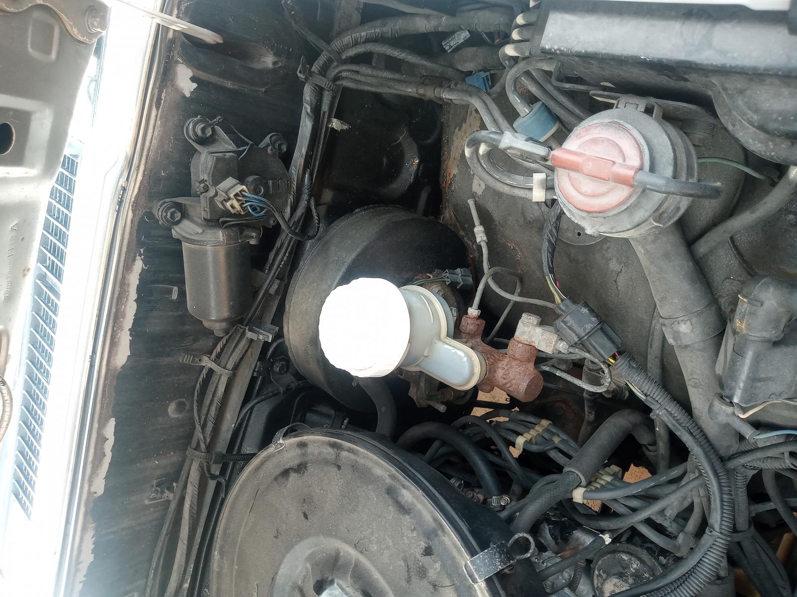

    Hi everyone ..newb 87 mighty max owner here..went to check clutch fluid level and found out it doesnt have a clutch master cylinder where its supposed to be. It still runs fine but wanted to know how? Im gonna order a new one and install it but before i did wanted to know if this was some kind of mod the previous owner did...thanks.
    Hi and welcome to mightyram. There's something going on here as AFAIK all manual transmission trucks are cable actuated clutches. Any chance you can post a pic of it? This will indicate that it has also undergone a possible transmission swap...

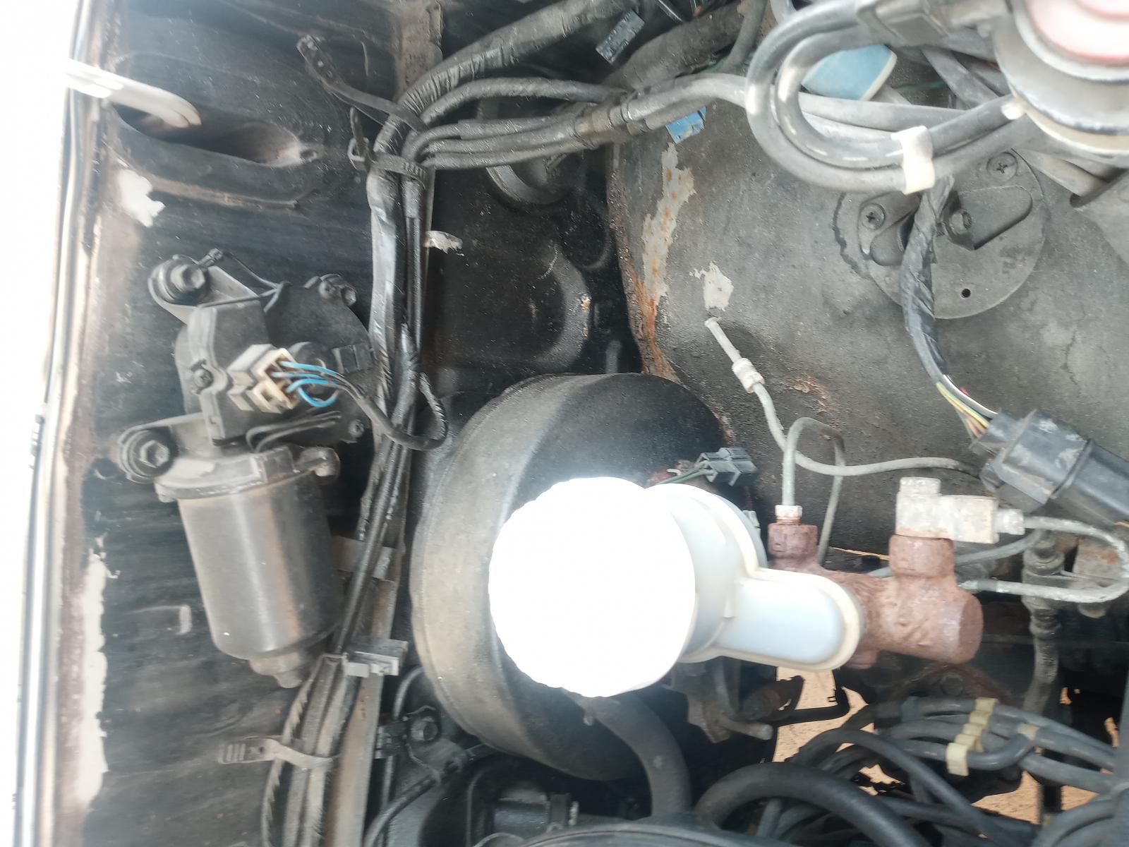

    Thank you for the help...here are some pics...when I pressed down on the clutch to see what moved it looked like the brake booster was also connected to clutch...20200319_170238_HDR.jpg20200319_170215.jpg20200319_170156.jpg

    By the looks of things you have a cable clutch. I did see a clutch master cylinder on Rock Auto for the 87. Can you remove the aircleaner I think the cable come out the firewall behind it and you will be able to get a better idea. And rock auto has a picture of the master cylinder if you need that to find out.
    Yeah it's a factory cable. The cable is tucked in there by the brake booster hiding below the air cleaner box.

    On a different note, why is there a disconnected brake line resting on the fender well next to the brake booster?
    Ohhhh, I didn't even notice that. Yeah there is something not right going on there

    Checked the line and where it went and it llokks like it would have connected to where the original clutch madter cylinder went. Didnt see it go to the brakes...but ill get under it and get a better look. I really think its a combo booster (brake and clutch) like one of the earliest posts suggested.(well I hope it is or oof...)

    I doubt anyone would go through trying to reverse a hydraulic clutch set up in one of these trucks. And I have never personally heard of a dual brake/clutch master in a Mitsubishi before. Maybe someone did a BMC swap for some unknown reason and had to change the front brake line joiner to something mounted to the firewall (some had a splitter on the master cylinder and some have a line splitter on the firewall IIRC)
    1,222
    my guess is that a brake line was damaged and they didnt remove it when they put a new one in.

    I agree with geezer101 that the disconnected brake line probably went to a splitter. I can't tell from your photos, but I bet it is (or was) attached to the booster below the master cylinder.
    Can you determine to what the other end of the disconnected brake line is attached? If it connects to a flexible hose that's bolted to the fender well and descends down toward the frame, that's one of two lines to the rear brakes. Either you have no rear brakes or if you do, I bet someone deleted, modified or by-passed the load proportioning valve that's located on the frame above the driver's side of the rear axle. If that's the case you can get by with that, but it's not the safest. If a front hydraulic line failed, you'll have no brakes at all instead of only the rears as designed.

    A picture of the chassis termination point of the mystery brake line ???
