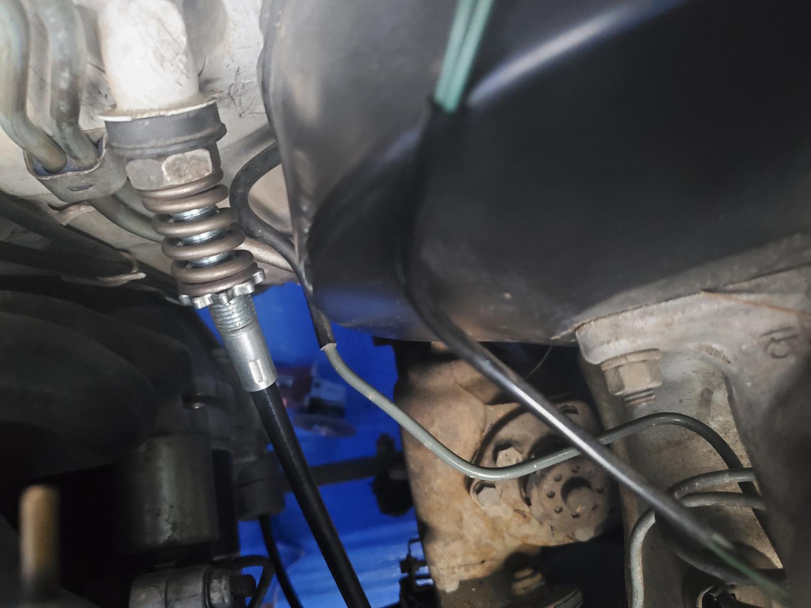

    Brand New Clutch Cable Problems
    Previous owner used a spring and nut for a spacer on the old cable. I figured it was stretched and ordered a new one, but the new cable can be adjusted all the way up easily and still not disengage the clutch. I temporarily put the spring and nut on the new cable to be able to get it into gear. It is adjusted wayyyyy out and still not working normally.

    The shifter bushes are still available new - they were used on Mitsubishi and Hyundai and are only a few bucks tops. The clutch cable tensioner spring is a long ass thing that is about 2-2.5" long when installed so that indicates by your picture that the adjustment is out of whack.

    There is suppose to be a spring there? I thought it was just suppose to run up to the rubber grommet on the firewall with just 1/8" of play.
    I have it adjusted to move it around and put it on a trailer for now, but it is virtually working like an on/off switch with little room for slippage.
    The truck goes to inspection this week. It will pass as is, but I still need to figure this out. The cable tightens to the point where the threaded end isnt even in the rubber grommet on the firewall anymore. Is there suppose to be something to hold the cable down to prevent it from moving?
    The spring is pretty lightweight - I doubt it offered any real resistance. The spring hooks through the teeth on the adjuster and the other end locks into that cut out on the seat so the adjuster doesn't wind itself back in.

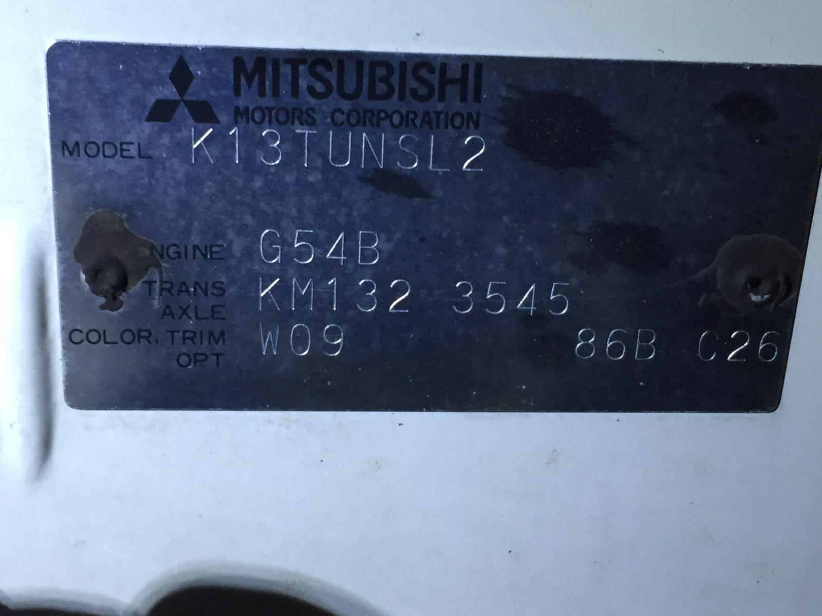

    By the way, what model are these 5 speeds? I haven't found anything really on them and was curious.
    01-31-2020
    103
    Kent, WA
    Quote Originally Posted by Low9Life4 View Post
    by the way, what model are these 5 speeds? I haven't found anything really on them and was curious.
    The transmission model is shown on the ident plate, front of the firewall. Mine is "KM132" for example. Also a 5 spd manual.

    I didn't even think to look there! Thanks! I plan to cyro treat the internals of the spare and now I can check for goodies that may be available.

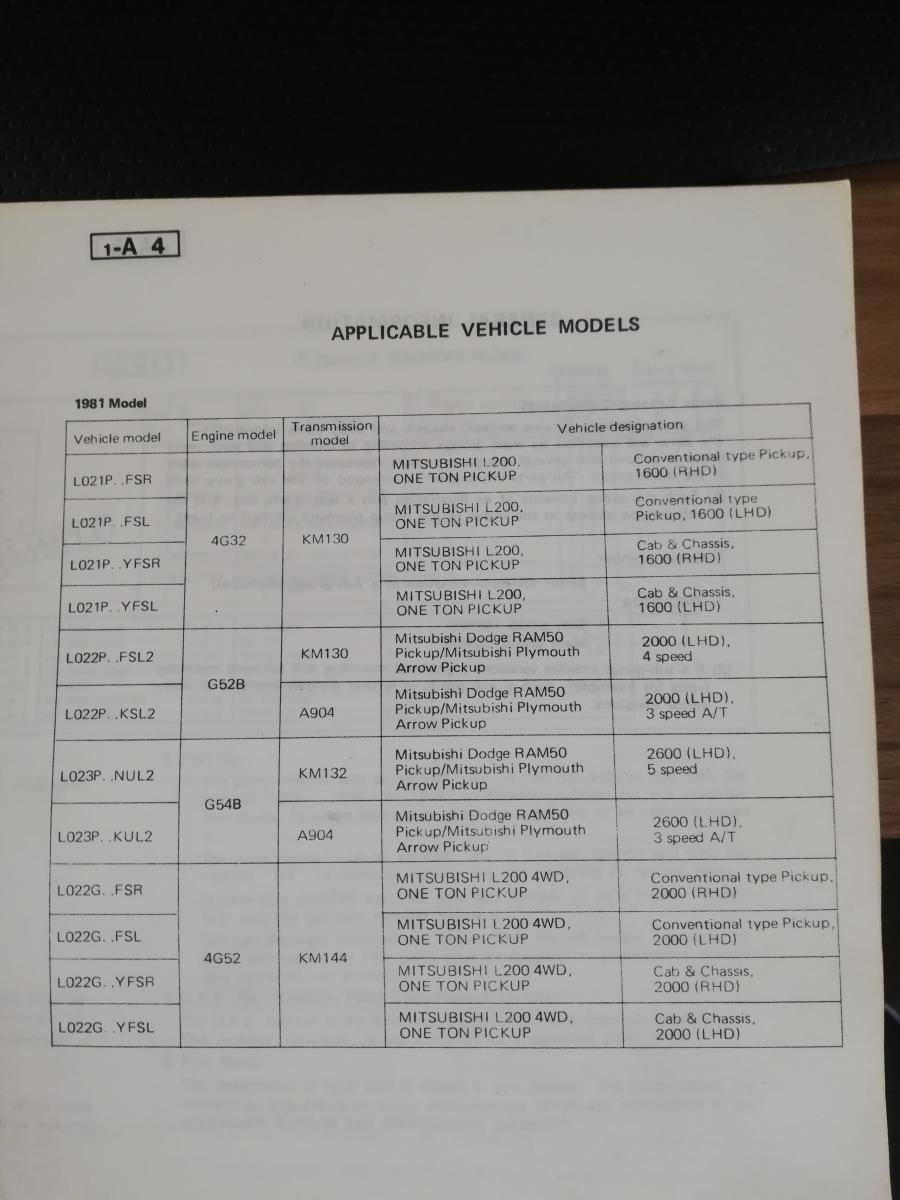

    1,222
    I have the following part numbers and applications for first gen
    excluding 4wd
    part number UPC number - model applications (type/description)
    MB012460 - 30570 - L021P / FSL YFSL, L022P / FSL2, L023P / NUL2
    MB012461 - 30570 - L021P / FSR YFSR
    4wd models
    MB012475 - 30570 - L022G / YFSL
    MB012464 - 30570 - L022G / FSR YFSL
    To make sense of that the following codes relate to model, engine, and trans il post a pick of the model decode
    1,222
    1,222
    https://www.megazip.net/zapchasti-dl...ro-strada-4374
    Lots of parts diagrams here, but im only seeing MB527073 as the part number until 3rd gen. May not be a complete list i guess,
    Scratch that i did some more digging
    MB527073/MB598411 is 870mm eye to eye and has a sheath length of 654mm
    MB598411 on rock auto has an eye to eye length of 889mm
    looks like theres a bunch of too long ones being sold as standard?
    might be less leg work to remake the bracket

    Torton,
    Thanks for the 'legwork', -all needed info on first gen clutch cables & added bonus of 1'st gen? model decode chart
    Pennyman,Thanks, please do post the numbers when you find them
