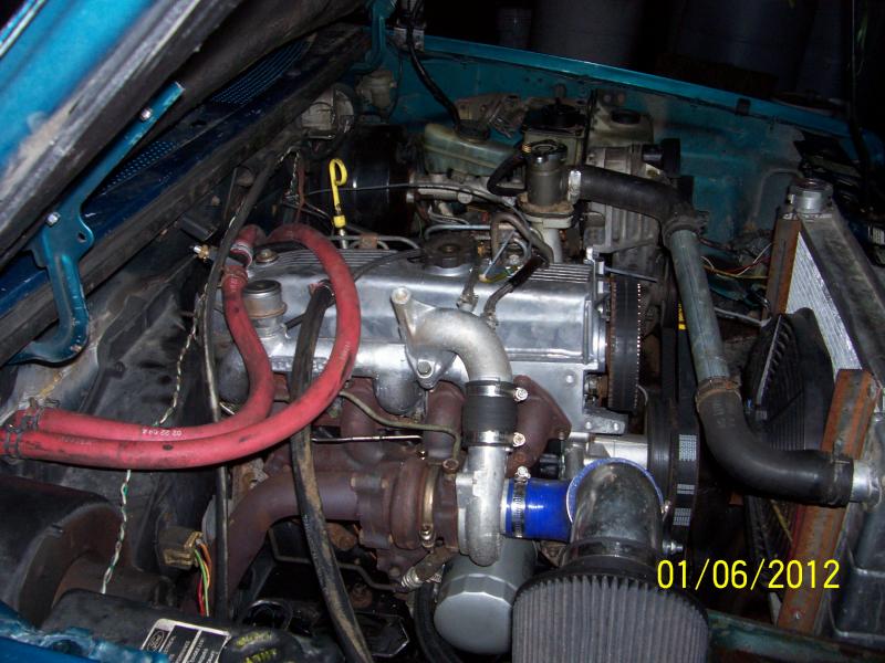

    shouldn't be as far as I know. I have never seen one where the lower rad hose is the out flow. You did put the thermostat in so the sensor was down, right?? On the water pump does it have a replaceable base plate. I know on some Toyota engine the pump and base plate are separate. If the base plate is warn they won't pump enough water.
