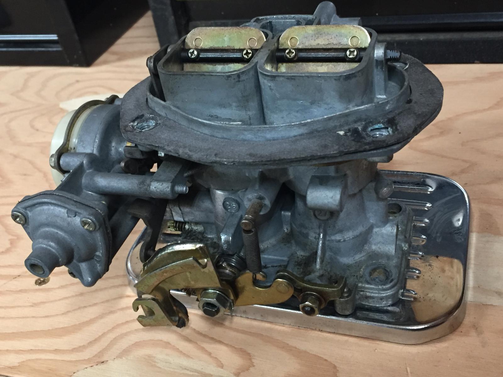

    My throttle usually doesn't return to idle when I let off the gas pedal. So far everything I've tried has made it worse. The Weber 32/36 DFAV carb has a rotary return spring on the main throttle shaft; I've tried repositioning it and winding it extra tight and it does not like that at all. (causes more binding with no benefit of returning it to idle)
    There is also an external return spring, I assume it was there for the stock carb before the weber was put on, and it basically doesn't help. It seems like it's positioned wrong.
    So tonight I've got an idea to fab up a couple steel brackets and install the external spring in a position to work better. I'll post pictures of it below if this works.
    If anyone has solved this problem or would strongly suggest I don't do what I'm doing??? I'll check this again before I start drilling.
    Cheers
    c.j.
    The stock return spring on the carb is not strong enough to return the throttle plates to idle, as you know. You need to have an external return spring to get the carb back to idle, and have it aligned for max pull with the least amount of tension so you don't need 2 feet to push it down. I use a universal double carb return spring on Geronimo's 32/36 DGEV and I have no issues.

    I think this worked. There wasn't a good place to hook a spring (at either end) so I added a bracket onto the throttle lever and another on a manifold bolt to anchor it.
    Before:
    After:
