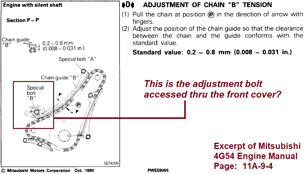

    The one issue you can run into is timing chain stretch. You can check your chain through the little 2 bolt cover on the timing chain cover - it is there where you can adjust the main chain guide to take up chain slop, but don't go to far - binding and chain guide wear or breakage can occur if you tighten it up too much.
    Pennyman, I don't want to doubt you since you've owned your D-50 for 40 years and I'm barely coming up on ... 40 days.
    But it looks to me like the *timing chain* has a self-adjuster controlled by oil pressure and not user-adjustable. And then there is the *silent shaft chain* which has an adjustment, shown below in the manual. That's the one you adjust thru the little 2-bolt cover. Do I got this right so far?
    Since the manual tells you how to set the silent shaft tensioner with the whole front removed, one can only guess how much to tighten this if you only have the little 2-bolt cover off. (like you said, don't go too far) Should I assume that going clockwise on the "special bolt B" is the way to tighten it?
    I'll definitely be checking the timing chain and guides more (per the post from Mr. FMS88 above).
