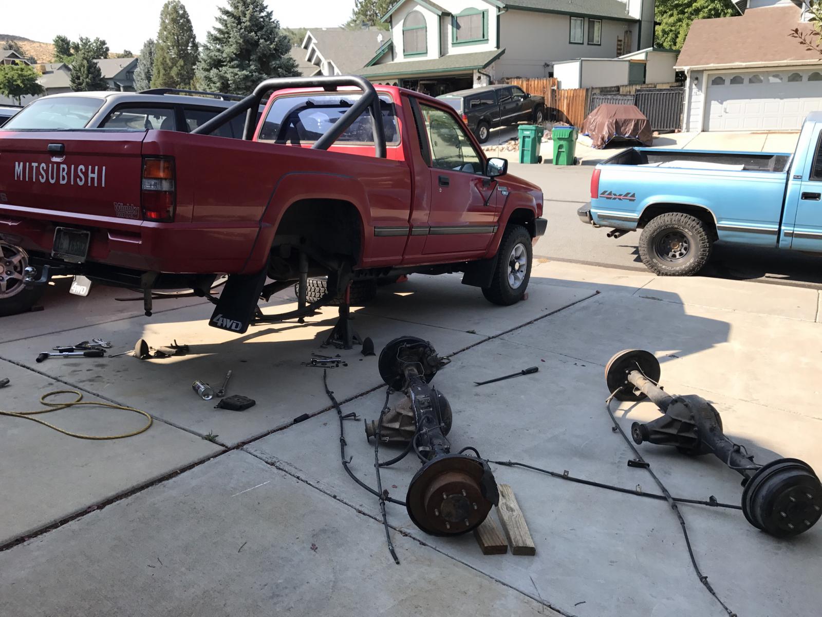

    Performed this swap several years back. Took a 97 Montero 9" Disc Brake Axle and installed my 4.22 LSD in it. So far its been good and reliable.
    Anyone else perform rear axle swaps? How are they holding up?

    I swapped in a Dana 44 high pinion and GM 12 bolt axles with 4.56 gears and lockers in my 82. Haven't broken them yet even with 38" Super Swampers.

    No 2.4, I swapped in a GM 350 and drivetrain years ago.

    Thanks for the shares. Baldy yours is quite unique. Let’s keep them coming.
