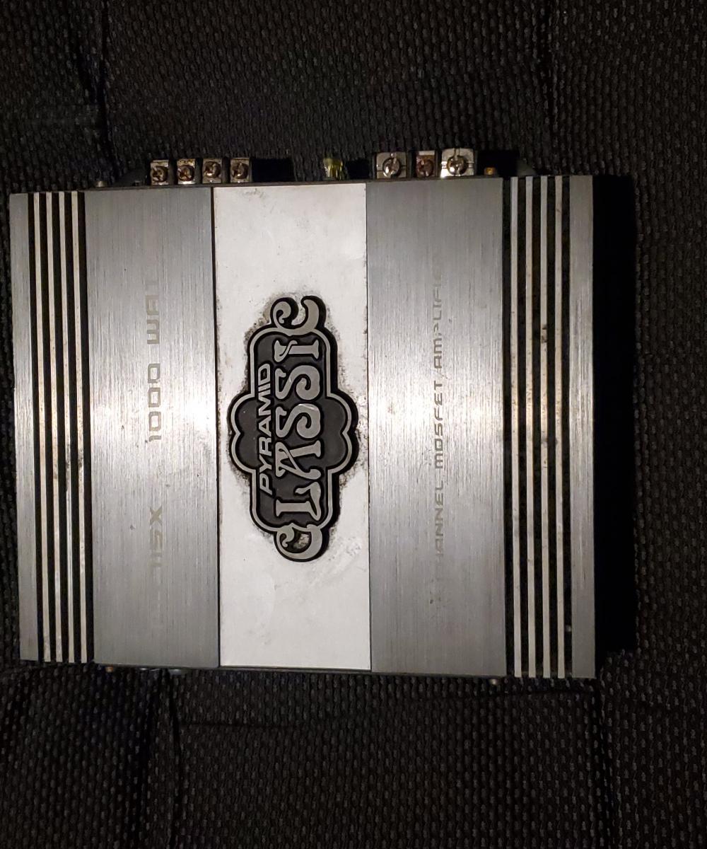

    So I need some opinions. I picked up a 1000W amp recently and I figured I would go ahead and show off my audio that's going in my truck. It's a 12" punch sub and 4 6" truck boxes going behind the seat a 6x9 in the center under the dash and the 2 speakers you see (one has a LED frame though I have 2 I need to extend the wiring on both) all to a custom bluetooth chip that powered the lights and speakers with LR audio (sub and 6x9 are wired to both speakers so that it plays constantly) and I also have led ligjtbars for the floor too. What do yall think?

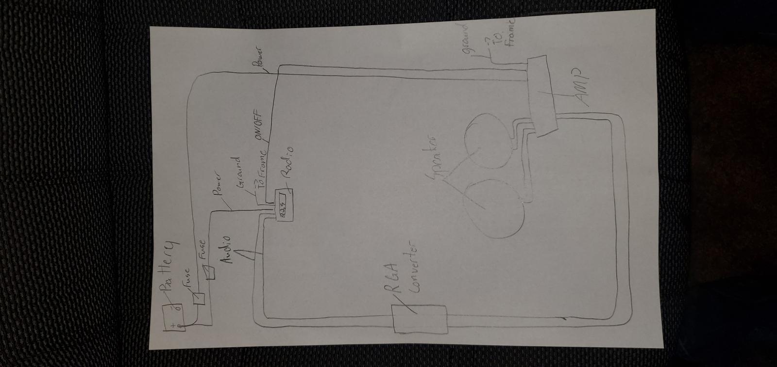

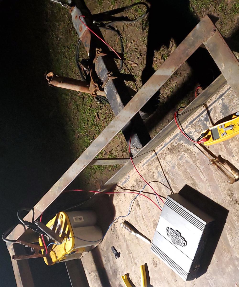

    My truck is a Power Ram 50, the 4x4 Ram 50. I have 2 5: speakers in the dash right now and that's it. I have a kenwood radio that's getting swapped out for a pioneer bluetooth radio. And pioneer in american is actually good. I picked up my 1000 amp from my freind in trade for 2 super 10 mufflers barely used. So yeah good deal lol. I have made a diagram to my understanding of how this works so correct me if I'm wrong.
    1000 Watt amp
    How I rigged ti test if it worked
    Diagram
    For the head unit Red = 12v+ accessory power, Black = ground, Yellow = permanent power for memory, Blue = amp remote trigger, White/blue = power antenna. Do not use 12v+ power for the amp remote trigger - it will roast it. Everything else is just speaker channels or RCA's - pretty easy. Hooking up a sub - take one channels' +ve connection and -ve for the opposing side channel to bridge it. Make sure you have the wire polarity right on the sub or it'll sound like crap (like any other speaker if you mess up the polarity lol) I would also make the Punch 12" sub removable for those times where you need the space. I'm using something like this so I can take out my 12" sub tube from the cargo are of my wagon -
