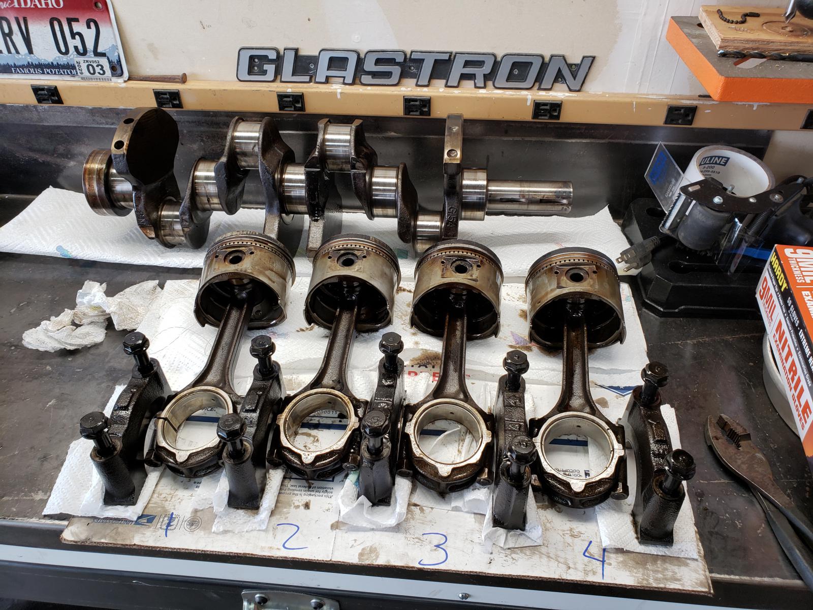

    I took the engine apart this weekend. The main and rod bearing surfaces all looked really good. The pistons pushed out of the top of the cylinders without any snags so I don't think that there is a ridge around the top of the cylinders. The bores all have a faint sign of hone marks, so I am optimistic that I may get away with a hone and re-ring. The bearing on the rear of the upper balance shaft had a slight amount of scoring, so I am glad that I took it apart. I plan on replacing all of the bearings and probably the piston pins as well.
    I have heard that there are counter balance shaft eliminator kits, but am not sure if that is a good idea or not. I am getting a non-jet valve head for it, and I can see the advantage of that modification. Do the eliminator kits cause any issues long term?

    There has been fierce debates over balance shafts - to delete or not to delete. From factory the rods and piston assemblies are within a few grams of each other so getting a die grinder out and shaving a little metal off the heaviest assemblies will bring everything to near perfect without machining and balancing the crank/flywheel assembly. There are plenty of engines that don't have balance shafts in them and were in production up to early 2000's - they don't try to knock themselves apart or massage your legs under throttle...
    Pros - rotating mass reduction. Improves throttle response, adds horsepower. Eliminates balance shaft bearing failure and deletes the secondary timing chain (balance shaft bearing failure leads to catastrophic oil pressure loss and RIP to bottom end) Subsequent improvement to primary oil pressure.
    Cons - some people have experienced secondary harmonic vibration in certain rev ranges, to the point where they felt it was unlivable.
  5. #55
    you can take the Crank,Harmonic balancer and Flywheel to a good machine shop and get them 0 Balanced for a for between $100-$200, then have the rods and pistons weight matched. Doing this the engine will perform better and you can eliminate the counter balance shaft with no problem. I have done this with the old Dodge 2.0Lengines and the newer 2.4L. What I don't understand about Mitsubishi is the Canadian engines didn't have a balance shaft in the 2.0 and the 2.6. that I have taken apart (79-84)
  6. #56
    Some early Astron engines didn't have balance shafts, 2.0 and 2.6 forklift engines didn't have them either. The shaft design itself was integrated into Mitsubishi engines when they produced the Astron 80 but where they were implemented is a bit of a mystery. Astron II engines appear to have all been designed with balance shafts.
  7. #57
    * get a cheap pair of digital kitchen scales, weigh each rod assembly 3 times individually to get the average weight then shave some metal off the heaviest ones. Unless you're building a high RPM range engine, I don't think the expense of fully balancing the bottom end will yield any worthwhile results. I'd also DIY cylinder head porting. This will make the engine idle smoother, improve throttle response and make it more efficient. Nothing too wild - just clean up the ports, match the intake side and radius off any sharp edges in the combustion chambers and the backs of the valve bowls. Only basic tools are required (don't go chopping away at it with a carbide tool and an air die grinder - that is a bad mistake) A rotary die grinder like a Dremel, a cheap tool accessory kit to go with it, a flexi drive on a regular power drill and drum sander attachments that will just fit inside the ports. And do the port work before sending the head off to avoid damaging fresh cut valve seats

    Thanks for all of the great suggestions! My plan is to have a local engine builder do the final measuring and any needed machining/balancing. He has a good reputation for building race engines and is the good friend my friend. I trust that he will treat me right.
    I had read here that the two common mods to these engines was to delete the jet valves and balance shafts, but wanted to hear what you all had to say about it. I am not looking to build a high performance race engine, but I do want to make any needed improvements to make it reliable and simple to work on.

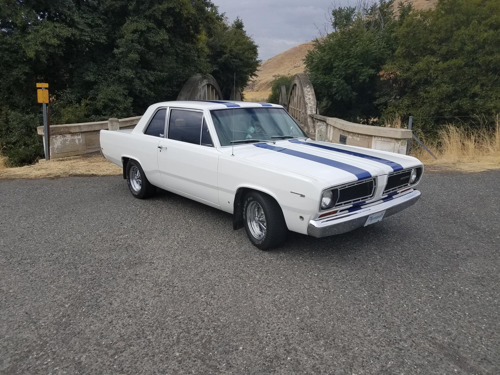

    I have more pix of my Valiant than would fit on this forum. I have owned the car since 1992, and before that it was my mom's car. She got it for high school graduation in the spring of 1968. It was originally a slant-6, three on the tree, bench seat car. After my first year of college, I put the 318 V8 in and a heavier 3 speed (floor shifted) and an 8-3/4 rear end with the same small bolt pattern axles. It is still all manual drum brakes and manual steering. The summer after I graduated from college (and before we started having kids) I did the body work and we painted it in my buddies garage. Hard to believe that was 22 years ago... I also switched it over to a bucket seat interior out of a parts car. Currently, it resides in my garage under a cover and gets driven on nice days and to a few cruises/car shows each summer.
    MOPAR is in my blood... and my D50 fits right in with all of my other Mopars. (2004 Dodge Stratus - current daily, 2008 Ram 1500 4x4 Laramie)
