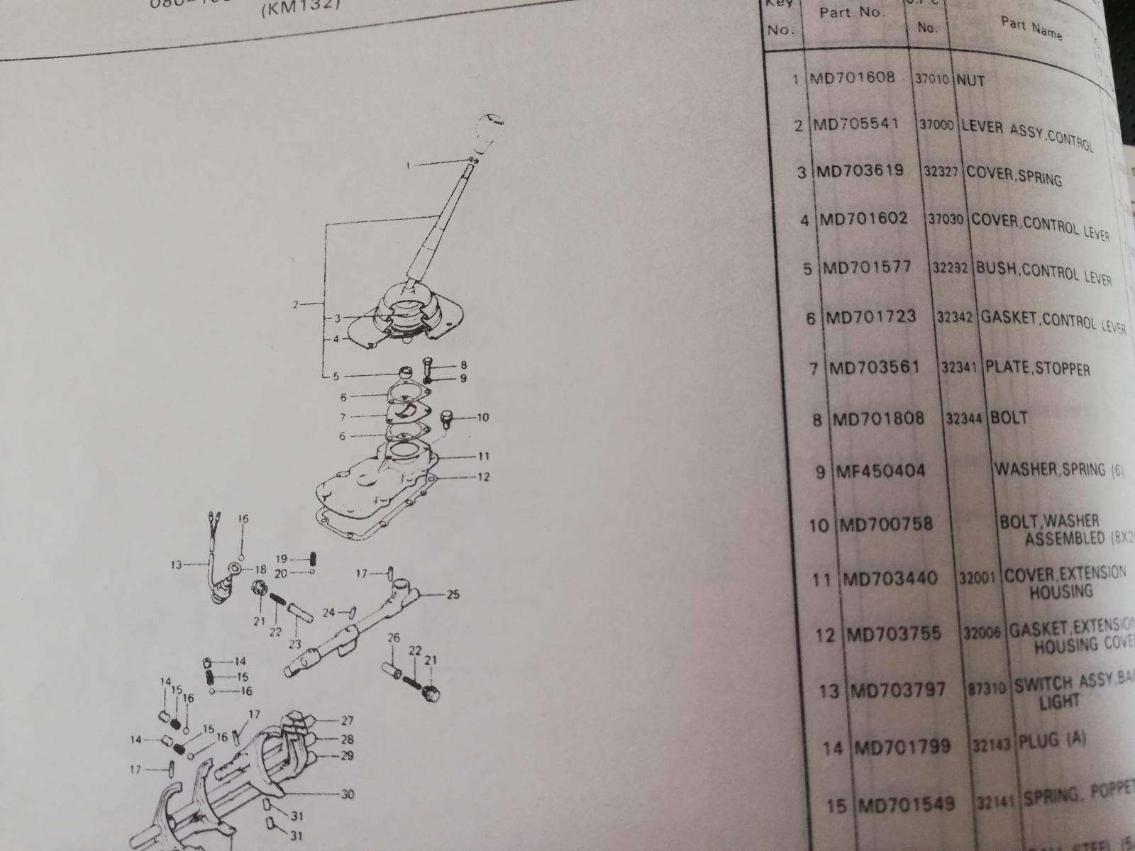

    I got the shifter removed, and it appears that it is completely missing the upper plastic ball with 2 holes. I have the shifter completely disassembled. I have found the bushing and ball parts on ebay for a Mitsubishi Mighty Max. Looks like they will work. I do still need the inner spring cover boot. Does anyone know if it is still available somewhere? Looking on here I found an old post with a diagram, looks like the part number is 23127. If I'm not able to get one, I'm going to try to make a cv boot for an atv work instead. 2 of the 3 bolts for the shifter where stripped out.. so will be doing some heli-coils there as well. I can't believe that the gal that had it was even able find any of the gears... she did a great job of burning up the clutch as well...

    1,222
    https://www.ebay.com/itm/Shift-Gear-...EAAOSwOdpX0P~v
    This boot? im not seeing any other rubber boots in my parts manual for the shifter. but im not real familiar with these ones
    Same part number for km130 km132 km144

    The part that I need is the "spring cover" it is the inner boot that seals the shifter to the transmission. It is safety wired to a metal flange that bolts on with the shifter. On your diagram it appears to be part #3.

    My D50 is a 2wd manual transmission. It uses the 3 bolt flange as depicted in the diagram above.

    #3 part number is
    [top]MD701602, which is the shifter rubber boot in the ebay link. i guess theres an unlisted boot that goes under that?
