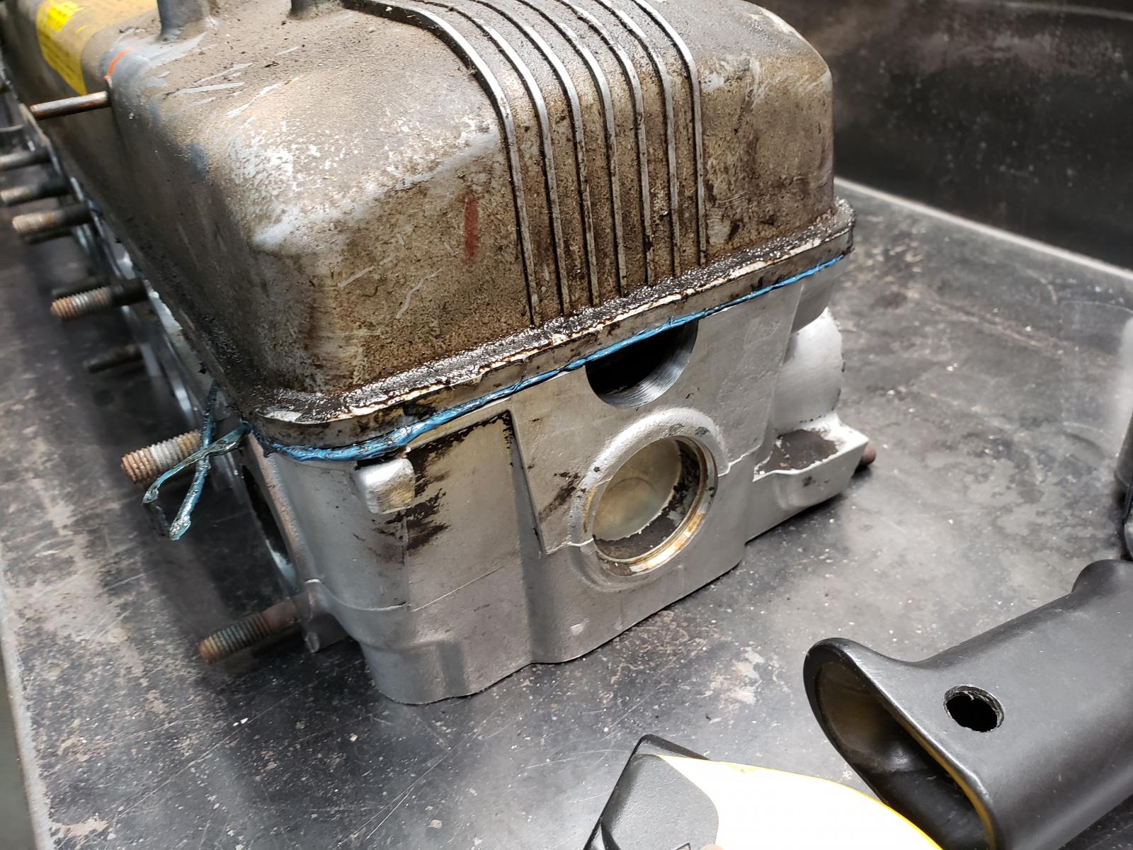

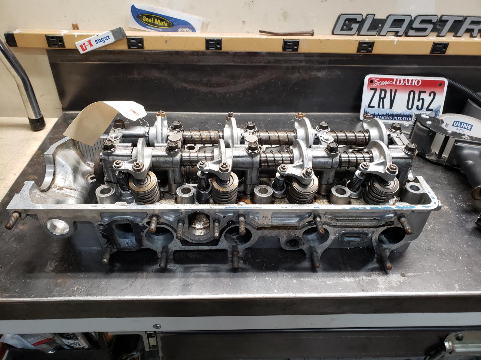

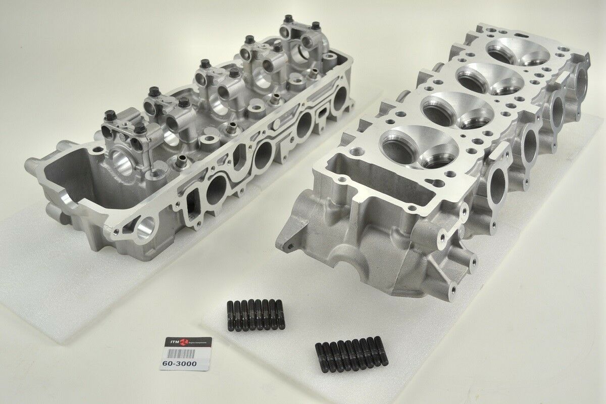

    So, ITM Engine Components has responded to my email about the cylinder head that they offer on eBay.
    https://www.ebay.com/itm/13293544992...84.m1436.l2648
    They said that they can't see where the 2.6l was offered in the 1980 D50. I assured them that I do in fact have a 2.6l engine. From what I can see in the only picture in the listing, the rear of my valve cover will not work with the head they offer... has anyone else ran into this issue with the flat valve cover and the half circle openings for the cam install?
    There doesn't seem to be any newer style valve covers available on eBay or anywhere online that I have been able to find.
    Jeremy
    There are different variants of the 2.6 - G54B, 4G54B, 4G54 (Astron I/II). I do know that you can't interchange rocker covers from early to later engines. Putting an early cover on a late head will cause the rockers to hit the inside of the cover (not good...)

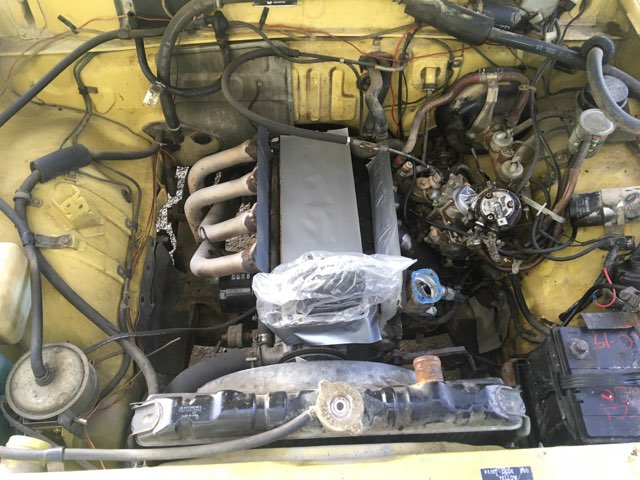

    I think someone has been playing musical parts.. all of the under hood decals show 2.6l and G54B. I need to get a better look at the engine this weekend. This is how I received it:
    Yes, that is a header, which makes sense for a 2.0 head swap. The mechanic that was trouble shooting for the gal that I bought it from just removed the head and left everything else attached under the hood. I am planning on a full removal so I can evaluate what I have. I hope to find a head either 2.0 or 2.6 that I can use. At this point I can't be too picky. I just need a head and valve cover, of course so far that is proving very difficult.
    The headers and intake manifolds swap between the 4G52 and early 4G54. So the headers will work either way. If that is the correct image for the head you are looking for - it's a later head design. Your intake manifold isn't going to bolt up to it as the stud pattern is different. If I'm wrong someone will step in and part with their wisdom
