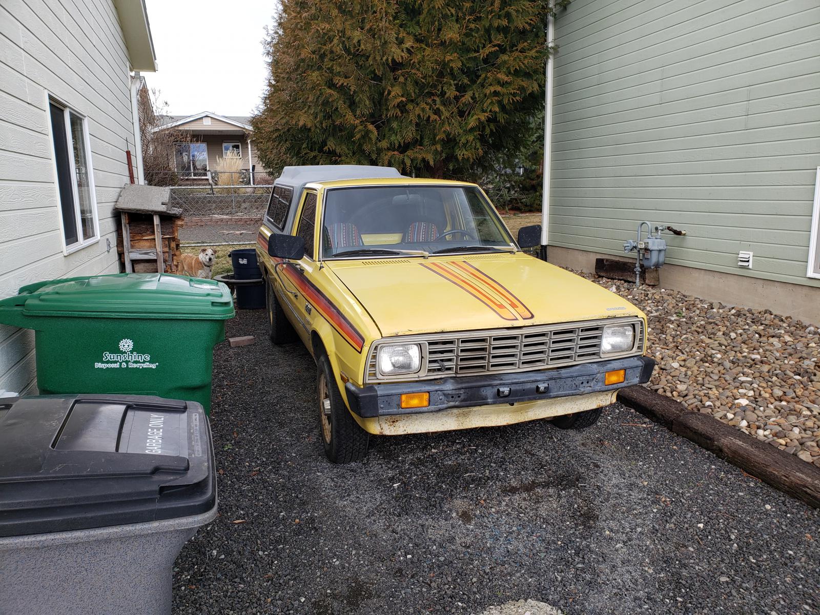

    Just bought a yellow with full stripe package 1980 D50 Sport today. I got it from a young lady going to college, who blew the head gasket/cracked the head (3 valve head) on a road trip. She could not afford to fix it, so sold it to me. It was already disassembled by her mechanic so I got it with the head removed. It appears to have had AC at some point, but there is no condenser. Looking on here, I see where the AC systems were an add on by dealers/importers which is probably why it looked less than factory. I am guessing that the condenser must have been removed by a previous owner after hitting something, as the grill is barely hanging on.
    She claims that the pickup only has 41k miles, but looking at it, I am guessing that it is probably 141k. Either way, I plan to pull the engine the rest of the way out.
    Once I have passed my "nube" probation period, I will post some pictures.
    Thanks, Jeremy

    Feels good having that truck & the forum support... We are happy too, welcome... The constitution says something about pics photos etc...
    The doggy looks happy too

    Yeah, out of my whole family, I think he is the most excited for the new pickup...

    Really nice truck for Northern Idaho. Shame the wheels are different and not all the sport ones.
    I wish that they had kept the single headlight set up as time went on with the 1st gen trucks.
    All the best in looking for parts, and welcome to the forum.
    Thanks!
    Luckily, the last owner has the stock rear wheels and I am getting those later. I plan to repaint/powder coat the stock wheels back to a better yellow. The rear wheels are Nissan/Datsun wheels that are 15" and the tires are way too big and really old. They are an accident waiting to happen. I won't be driving it on those tires.
    1st Gen single headlights are my favorite as well. Couldn't pass this one up.
    It's interesting that there were 3 headlight combos for Gen 1's. The dual round headlights seem to be the rarest... You might get lucky and find the multi spoke sport wheels to make up the set. What's your interior like?
    The wheels were part of the deal, just waiting to get them.
    Don't know that I have ever seen a round headlight version, very interesting...
    The interior is in pretty good shape. The usual cracks in the dash pad, headliner is falling out, and the everything needs a good cleaning. The driver's seat has boards put in under the pad (old man fixing) and it feels like a bleacher when you sit on it. My plan of for the time being is to swap the bottoms of the seats so that I can stand to drive it, and find/repair the springs in the bottom half of the seat and remove the boards. The stock radio and speakers still function, and since my plan is to use this as my daily to work and back when the weather is not motorcycle friendly, the AM/FM is all that I need. I guess if I really get into longer drives, I will get one of those FM modulator things for my phone. The carpet is in really good shape as well. This truck is really in pretty decent shape. Just needs some tinkering and an engine overhaul.
