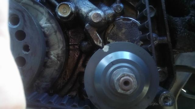

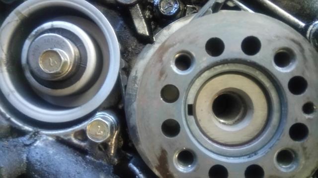

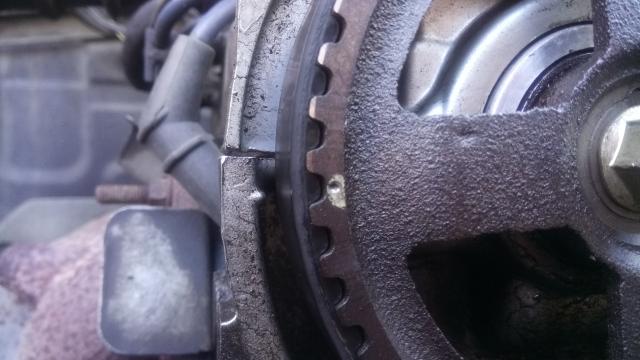

    Here they are, long over due. Though these are from the Single and nor from Macro they are both the same. I just did not take pics from the latter one.
    Only timing I did not take a pic from is the balance shaft on the passenger side.

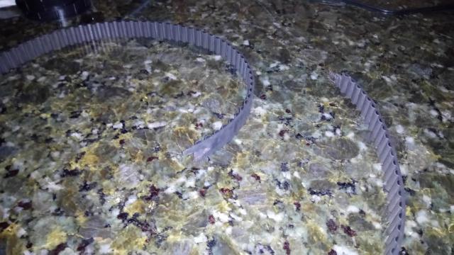

    Well,
    I found the cause the engine stopped running. The cause here does not really worry me, lucky engine for being none interference.
    The reason for it "snapping" the way it did though has me far more worried.
    Not fully confirmed yet but I think somehow the oil pump seized up. Belt got stuck and well. Snapped there as the crank is wwwaaaayyyy stronger in pulling then the pump is in stopping, are the closely matched. Well.
    The timing belt becomes the weak link in that and then you most likely get something like this.
    Timing belt is only about 8000 miles young and the oil was replaced about 500 miles ago. Had something odd at that time already.
    Work taking up too much time and the neighbourhood thinks that having an outdoor dog here is a crime....
    Wife car still needs a radiator flush and I have 2 extra cars in the unfinished drive way.
    1 day needs 50 hours. 1~10 for work, 8 for sleep and the rest for ones self!!
    Picture of the timing belt after the facts.

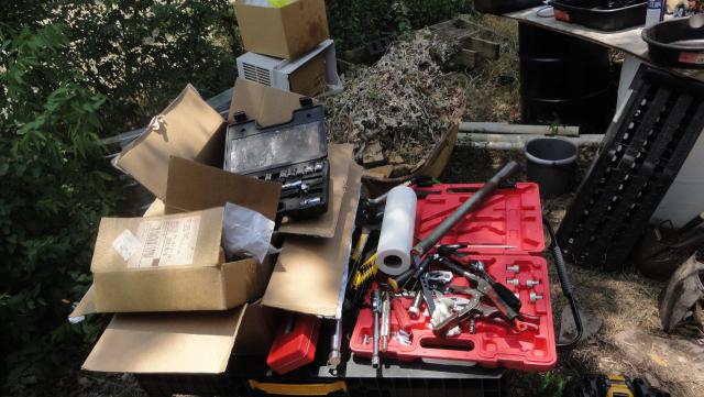

    But not for something more "on topic" Macro cab.

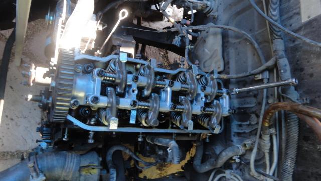

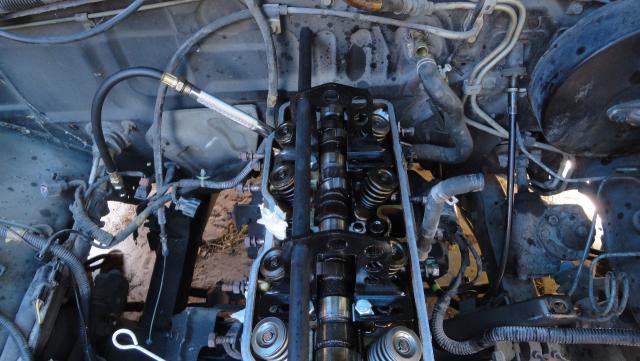

    I finally got time and puff to do something. Texas heat it limiting me a lot though, working out in the back yard at 100+ heat, I would rather work in the snow for I am from way further North then this. Macro had issues of running and driving but almost no power. Lots of possible causes here. Pulled the exhaust, that went rather easy for it probably never having been taken appart since build some 30 years ago.
    Some stripped bolts and nuts made putting it back together take a little longer.

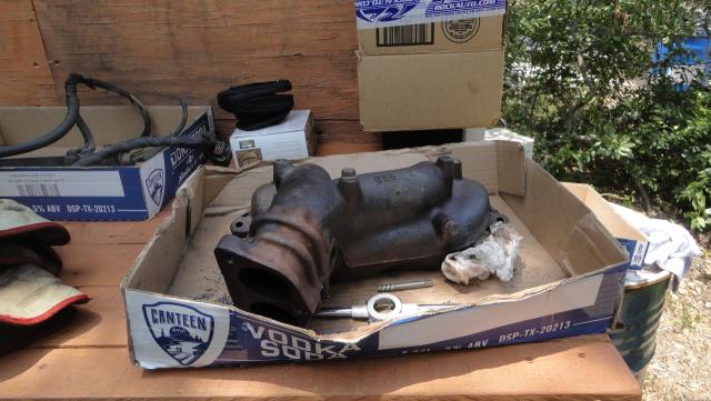

    CAT plugged with carbon build up. Ok, found at least 1 cause of low power and not I also have to search for what cause it to plug up in the first place.

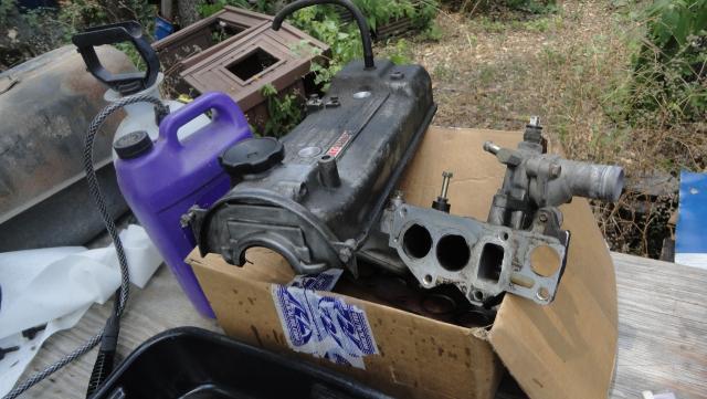

    I did all this work in the course of several days. The next morning I found oil on cylinder 4 exhaust valve stem. Well, new valve stem seals and while doing that I can clean the valve train.
    Sure need some cleaning, also checked the intake valves and put new gaskets on there to make sure there are not intake leaks. What a pain removing that 30 year old stuff.

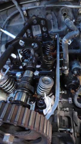

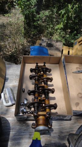

    Here you can see the clean springs in front and the yet to be cleaned ones in the back along with the spring compressor tool ( or at least part of the tool ).
    And here, not enough space for all that I am doing at the same time. Fixing an A/C, working on the engine and who knows what else I was doing to make that mess of tools and parts.
    Time for the followers!
    Looky, all sping sparkling clean.
    Even got the valve cover mostly clean.

    New gaskets on all exhaust parts, new CAT and new O2 sensor

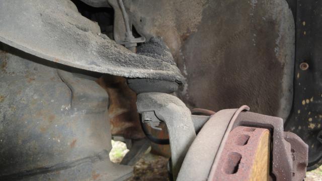

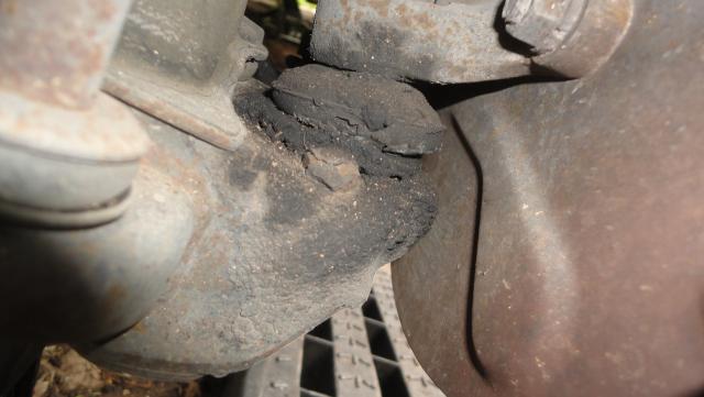

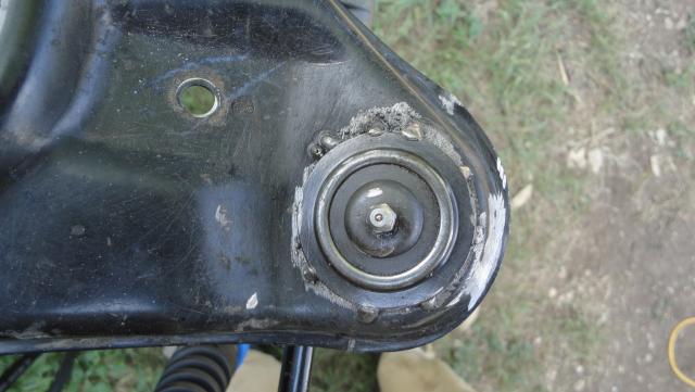

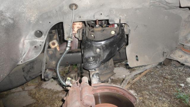

    I found some damage on the upper arms. Seems the arms are weak ( likely a form of metal fatigue ). The holes for the ball joints are not able to hold them in place and the safety clips on the bottom are preventing from falling off all together. Nice to know they are there and strong enough to hold the weight.
    Quick solution to that problem. I have welder, arm and balls are metal. Conclusion : next time I will need new arms either way so they are currently fused as one unit. Welding job is holding but steering is still out of whack. As I am forcing work on my other pick-up currently I have not further looked at this one. Last guess would be the lower joints. I remember that the bolt holes on the arm and ball joints did not allign fully and I cheated. Having thought about it for some time now my "cheat" was probably just a stupid thought that it would work. I am searching for a little luck to have time this weekend for as busy as its going to be to be able to at least confirm my thought on one of the lower arms.

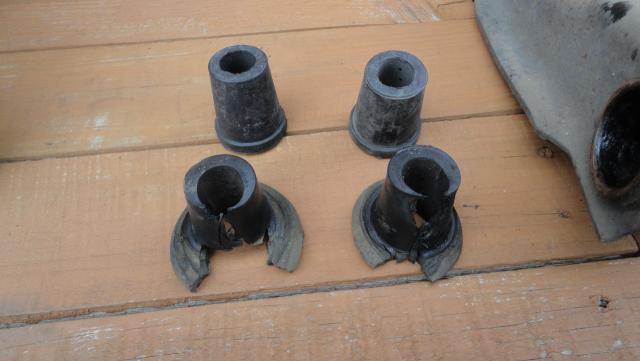

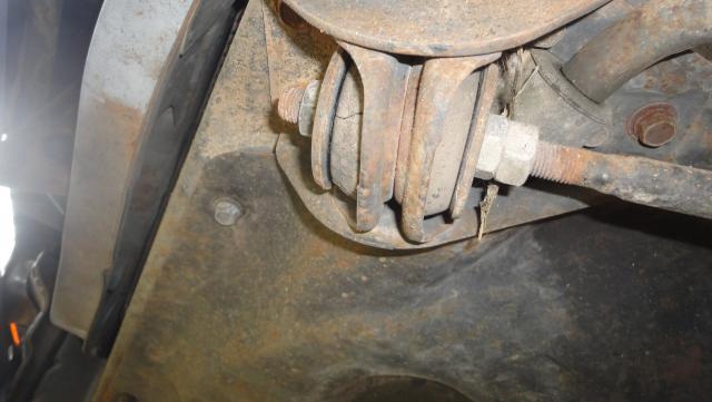

    Why the parts got changed
    Only a little dirty. Of only that was the problem though it be easy. They had way too much play on them when I got them of.
    Cracked rubber. Single has cracks here too but does not have issues steering yet. So for Macro they are being replaced.
    Lower arm bushings. The new ( top ) VS the old ( bottom ). They look just fine right?.......
    Here I got a little stupid or the steel from the upper arms is just too weak for press fits. I pressed them on at first and checked them after all the steering issues I still have. They where resting on the safety clips. Not good. They are not moving anymore now though :D
    Still having steering issues as is though. Checking all my work again and also working on getting new upper and lower arms. I have not been able to find any real play anywhere anymore since the welding but cant get the wheels to stay straight either. I might also just put the toe wrong on purpose to see if that helps. Its off way much though. Wore tires down to the steel in about 100 miles.
