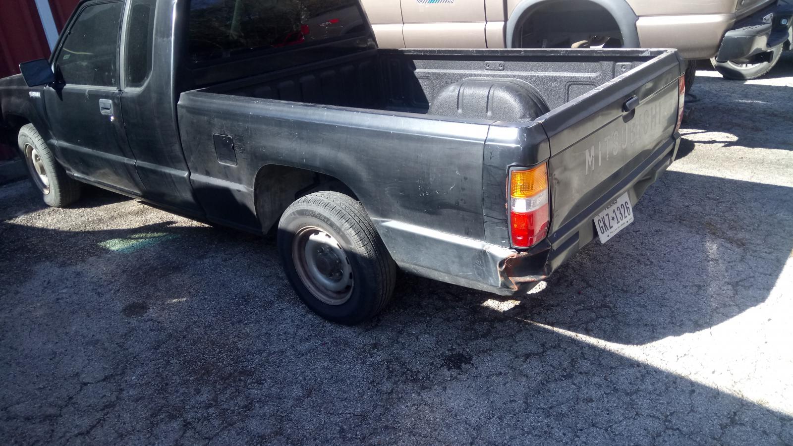

    The "nice" rework the fool did to the left side of the bed.
    Cant miss a shot of a nice rear :D

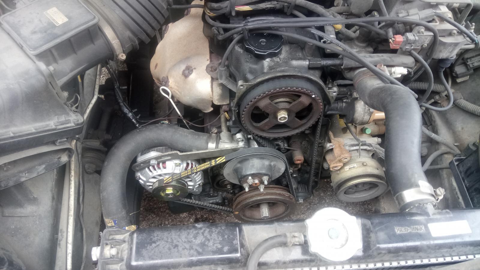

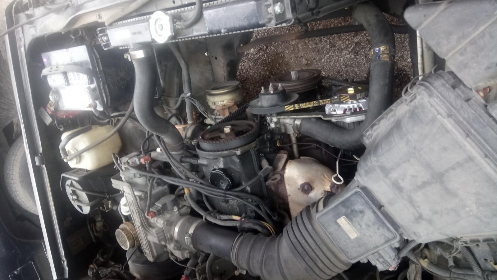

    The engine bay after I re-timed and did a small test run. I know, no fan but at near freezing a short drive wont harm.
    Here I also installed the larger altenator ( Think these are front he V6 models ) The grove is larger and it has 2 bolts for tension instead of one and it a little larger but fits just fine. I drove 10 ish miles with it on a bad battery so it works
    Here an other engine shot

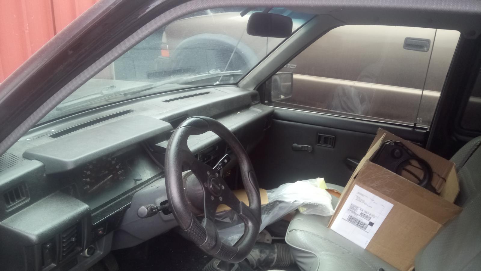

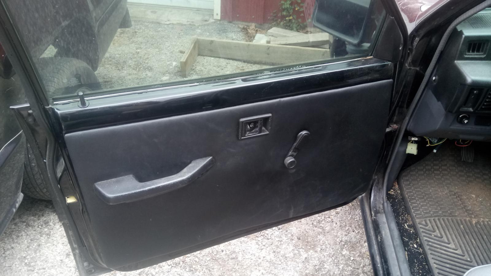

    The interior was altered, painted all black and dark. Windows got a tint also. Needs some more fine tuning and such but I say it still looks nice.
    The door panels have been taken out to install the auto lock/un-lock. The panels got done with a black cloth of sorts. The space from the window to the start of the solid part of the panel got cleaned up and left "blank". I say it looks nicer without the cover of fabric or other something material on there.
    The last picture I may also do with my single cab. I like the doors better that way, maybe I will also add a item holder to the front of the door when I do that for ice scraper of other things that I used to have in the doors.

    Installed new timing belt and idler rollers. now makes a squeeking noise, have yet to find the location.
    Found an oil leak ( and will probably find plenty more ), oil sensor exploded. Ordered and installed replacement already.
    Also found 1 of the squeek causers. The idler roller for the main timing belt from the brand new kit has a bad bearing in it. Put the original ( old ) one back on and that is resolved. Listened to all other bearings that I could get to easy and it sounds like the oil pump bearing may also not last very long anymore.
