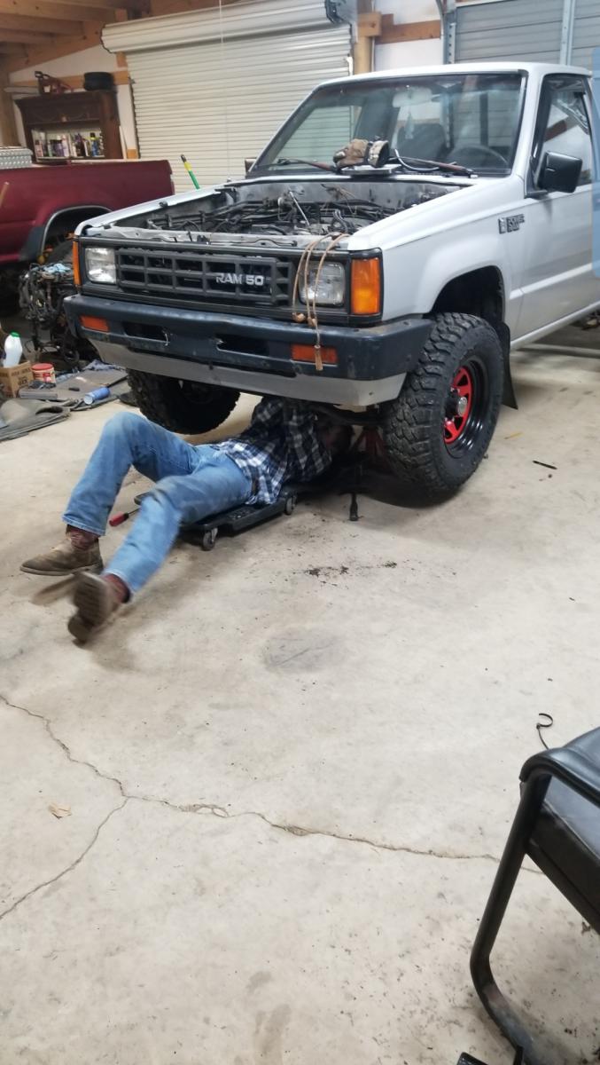

    Oh, I am not using that truck. I am using a 87, the motor in it was bad so I am swapping the 82 motor out. I am keeping the muffler, cutoff or no. Here is my truck that I am driving. The way it is on Jack stands with me under it is how I want to to sit when I am through with it. Looking online 2 1/4 is perfect size for a single pipe and a 200hp motor. I am hoping to achieve that down the road with a turbo, intercooler, twin carb, and a head upgrade with towing cam. What did the factory star fire turbo engines make? If I can get a hold of one I'll strip it if everything except the fuel injection and I will run it.
    Don't know if it's been recommended to you, but use a Starquest/Conquest 2.6 turbo engine. It'll save a whole lot of headaches. Turbos and carbs are not easy to get working together and the turbo 2.6 can make power easily with a few mods.
