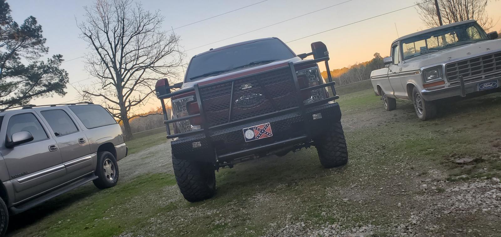

    Here are some ford trucks we have. 2 F150 2 F250. 2 same gen (78 79) 2 close (08 17)
    The 79 is 4x4, 460 granny gear 411 4" lift on 35's
    The 17 is 4x4, 10 speed diesel, 430 and 6 lift on 38's
    The 08 is 4x4, 5.4, automatic, 391 and a leveling kit on 33s
    The 78 is 2x4, 351M, 3 speed auto, 272 and 235 75 15

    Traitor..! I see a Chevy in pic 1 of 9

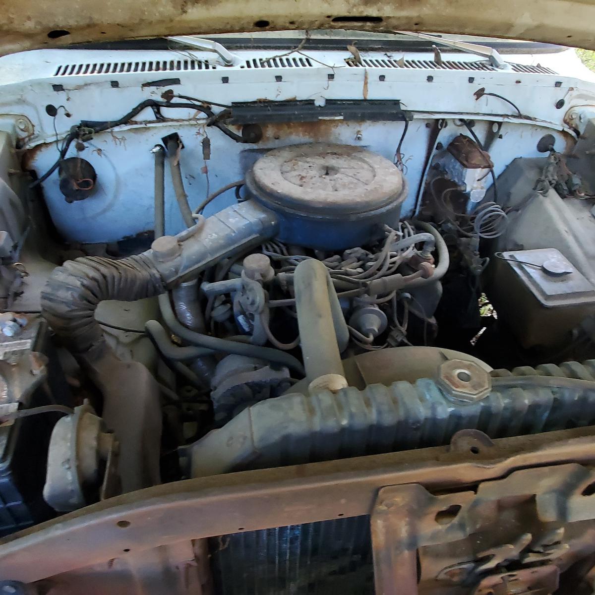

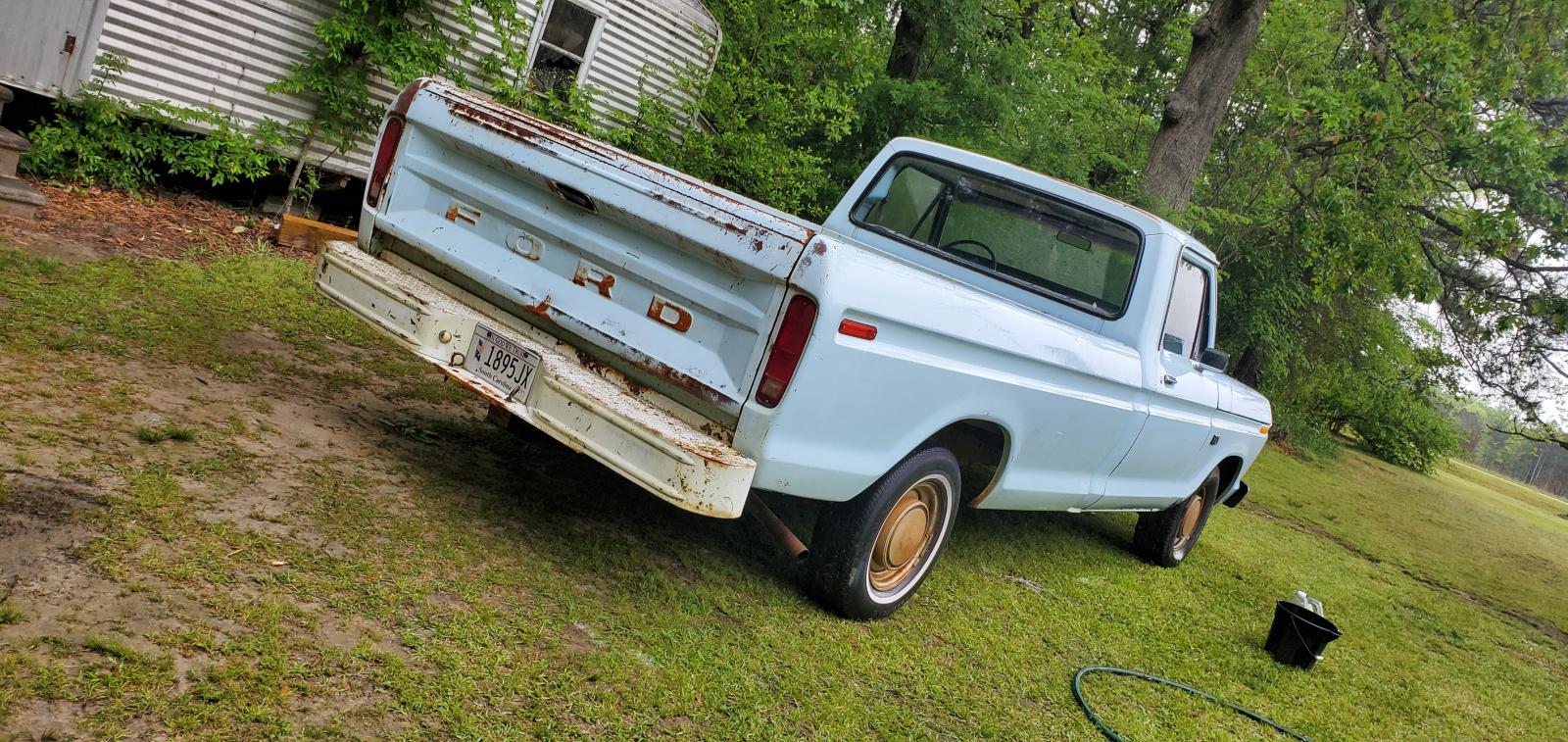

    1976 Ford F100 Custom. It has absolutely 0 options, even a base model had a cigarette lighter port, which this one doesn't have. It's absolutely the cheapest. It was a giveaway truck back in 1976 at a raffle at a private school. The guy I bought it from is my neighbor. His dad got it and drive it hardly ever. My neighbor inherited it in 2012 and has drove it twice. Ford 302/3 On The Tree Manual/3.00 rear end.
    My plan is to lower it, get an exhaust and an intake on it, higher compression pistons, GT40 or Cobra heads, X303 cam and firing order swap, and a radio in. And clearcoat the current paint to keep that nice patina to it. And put carpet flooring and LED lights in it.

    That's an extremely clean old pickup! Here in the Pacific Northwest, that thing would be Swiss cheese. Those are still one of the most popular pickup (body style) in our area. The 76-79 Ford pickups really seem to hold their value. Great find!
    Hummmmm..... Crown Vic front IRS, 4 Speed AOD, Flip rear axle,Rust repair, body work, repaint 3.50-373gears...................
    Ok here we go... you can't use a roller cam (B-303,E-303,X-303) in a none roller block. You have to go with a retro fit cam or a 84-85HO cam. Then use a set of roller rockers. The GT-40 heads need to come off a pre 96 Explorer the GT-40P heads needed a special exhaust manifold that was only made for the explorer. If you are doing a piston swap than go with the 86-93 5.0L Flat tops.Use a 67-71 double roller chain for the timing gears (pre smog so not 4deg retarded). Ditch the Carb and go with an EFI set up (FI Tech, MSD Atomic,etc.), MSD 6A box with a recurved distributor. Nice set of shorty headers (better for low end grunt) you should be able to push just over 300hp with a set up like that.

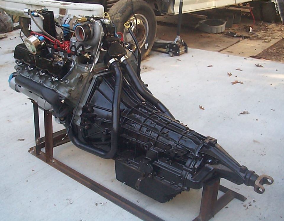

    1984 F250HD Centurion Conversion Dually
    Bought this with a cracked block and I had just swapped out the 6.9 IDI/C6 for a Turbo 7.3IDI/E4OD when my agency closed their Huntsville facility and I had relocate…. It has been sitting ever since, so I still have a LOT of work to do…
