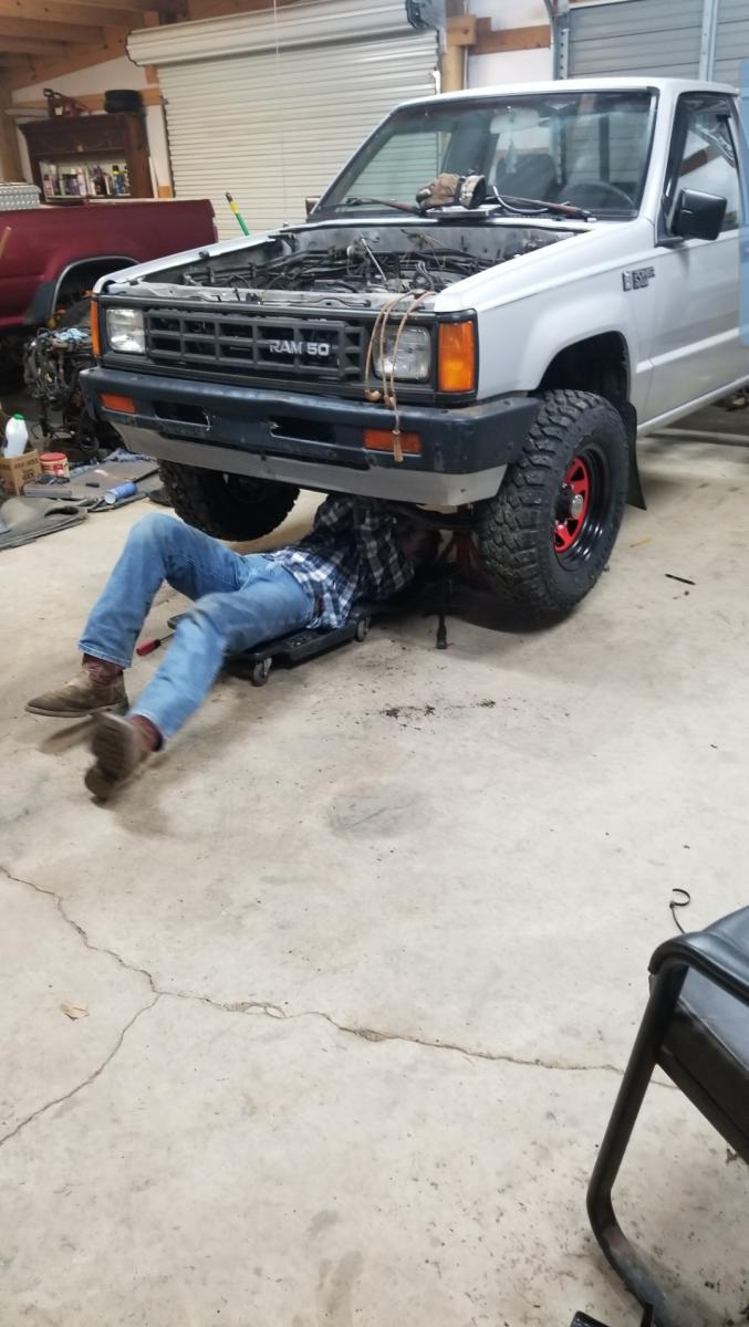

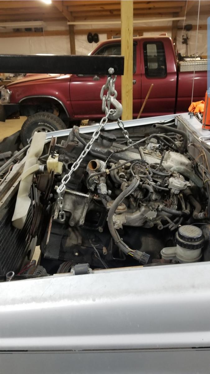

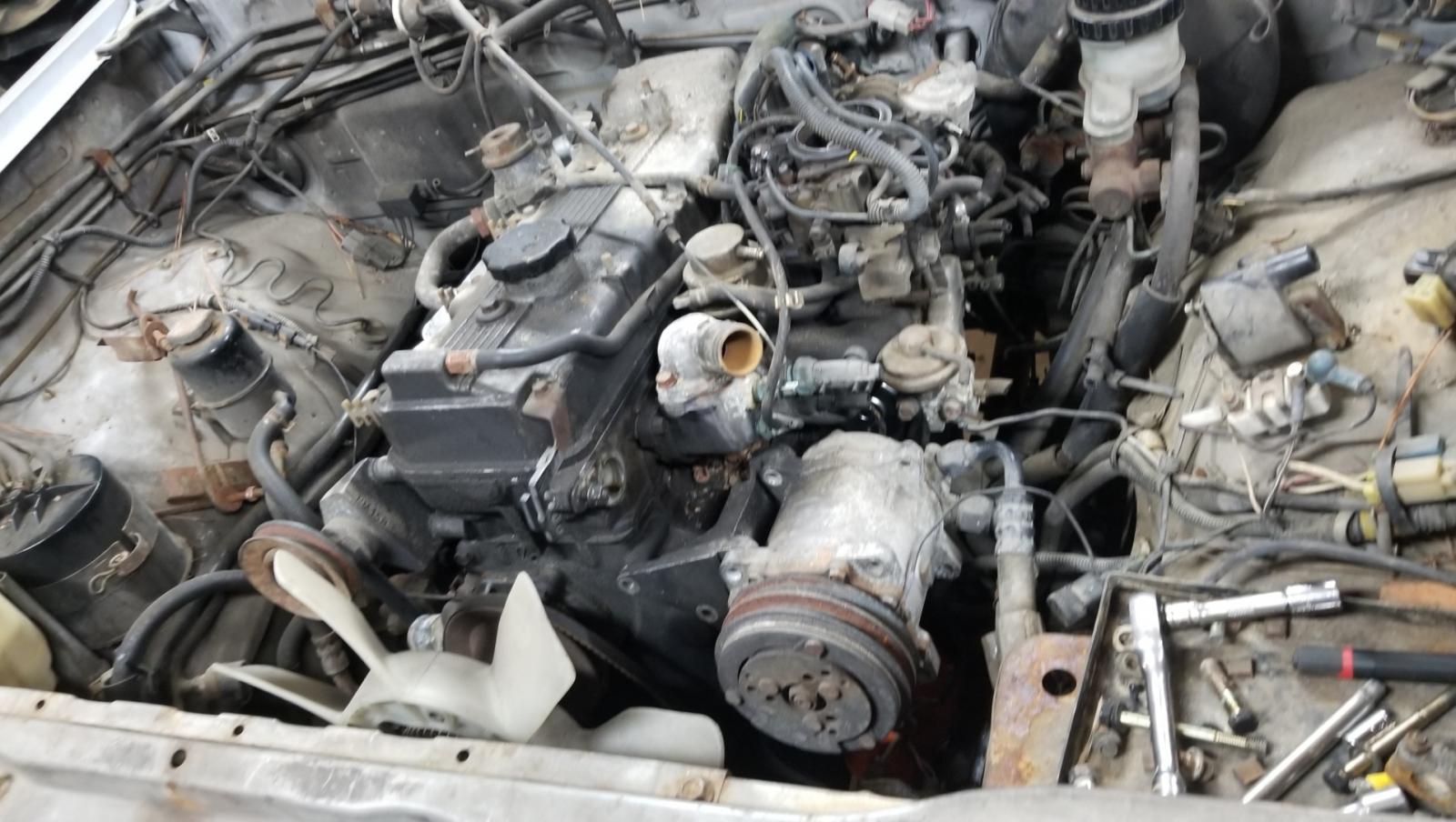

I am gonna redo it all, gaskets oil pump water pump alternator belts distributor plug wires plugs and the 87 intake which was better flow I think. I got the motor out today, I missed a ground strap. I'll splice it when the 82 motor goes in, no biggie. It was the one under the block.Screenshot_20200118-214945_Messages.jpgScreenshot_20200118-214906_Messages.jpgScreenshot_20200118-214831_Messages.jpgScreenshot_20200118-214719_Messages.jpgScreenshot_20200118-214706_Messages.jpg
The second photo it was on Jack stands, that's how I want it to sit when I am through with it. It sits really low in the front now, that's gonna get fixed when the bed is back on and the torsion bar are reset, as well as a possible lift up front

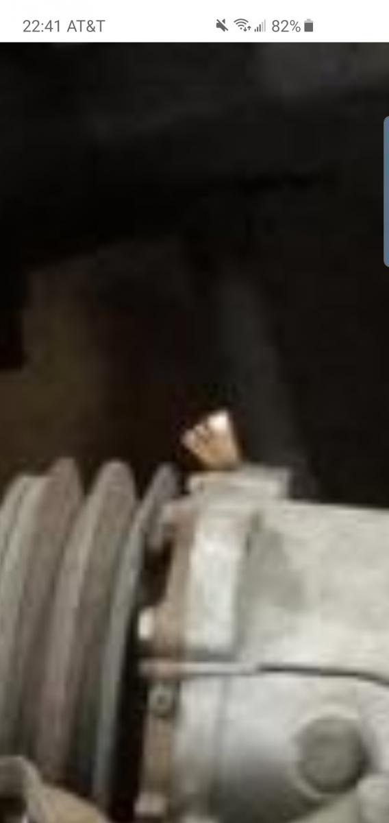

You can see the frayed wire behind the ac condenser hereScreenshot_20200118-224145_Chrome.jpg
