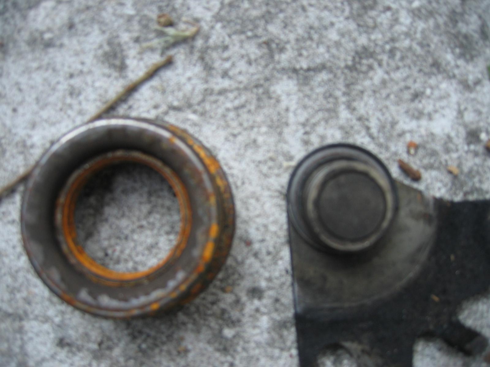

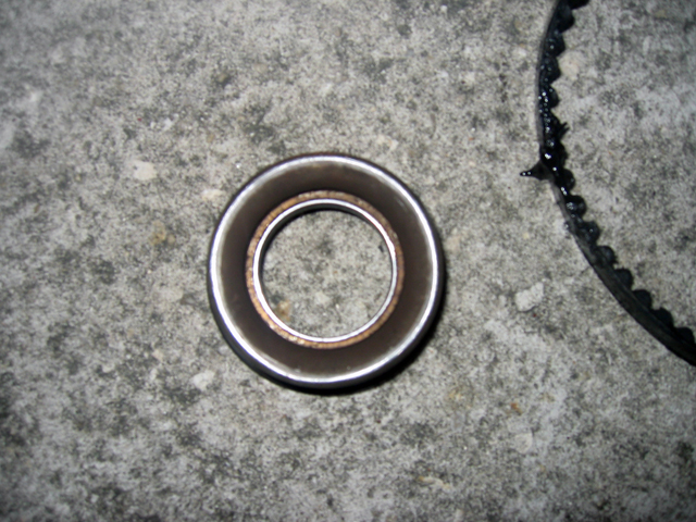

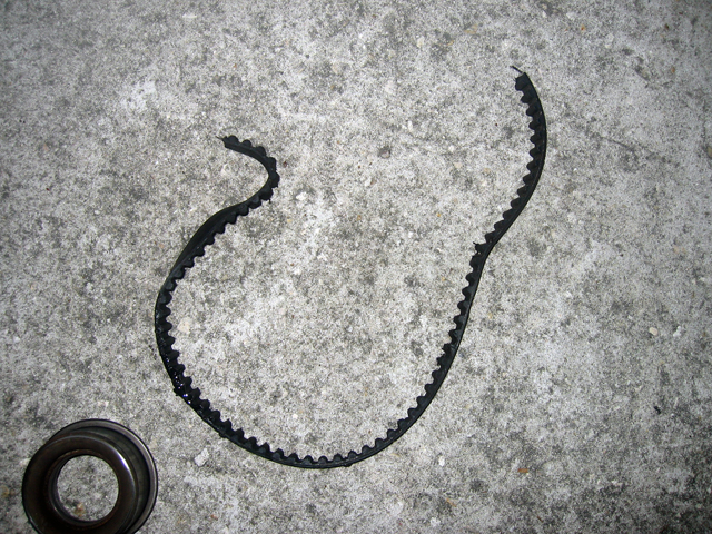

    Well it turns out my guess was correct. Balance shaft belt snapped off.. and the tensioner ended up completely separating off, from its base. Crazy stuff.
    Ordered a new balance shaft and timing belt, along with a new tensioner for both too. There goes $115 more dollars I didn't have to spend. I'm a little optimistic as far as the valves being okay though, I think this was the only problem.. at least, I'm really hoping so.

    That damn balance shaft belts/tensioners, hopefully no valves or anything are bent and that is it. When I bought the eclipse that I used for the 4g63, I had been driven in it by the guy that I bought it from and also drove a few people in it before I pulled the motor. Well turns out when I pull the motor I take off the timing cover there is a broken balance shaft belt. Luckily it somehow did not get caught on the timing belt or any of its components and broke it and bent my valves, I would have been one pissed off SOB lol. Well sorry for the rant anyways hope you can get it going without too many troubles

    It explains why when I was driving it, it felt as if a load had suddenly been put on the engine, as if an a/c compressor kicked on. I'm guessing the balance shaft belt broke, getting caught up into the timing belt. Just not sure how the timing tensioner snapped off the way it did.. very weird. That's what I get for not doing preventative maintenance on it and taking care of these when I was replacing my water pump. The truck has 160k miles on it and odds are the belts have never been changed. Lesson learned.

    I also replaced both tensioners on mine when replacing the water pump and belts. The bearings in both tensioners sounded rough while spinning them, so I decided to nip that in the bud right then. Still had to take it all back off again, since my dumb ass had the balance shaft off half a turn.

    From the pics I can see it looks like the bolt that holds the balance shaft gear is beat up as well. Since you are already spending money....might as well get all the seals. Cam, Crank, and both balance shaft seals. All that oil down there came from somewhere.....most likely from the shaft seals which have never been replaced. If the seals continue leaking, they will ruin the new belts. Then again, might as well just install the belts for now and make sure you did not bend valves. The service info I have on this motor warns not to turn the cam or crank with the belt off, this would indicate that it is an interferance engine, yet I have seen quite a few instances where the valves went untouched. Various circumstances control this such as rpm at the time of failure or how far the belt jumped timing.

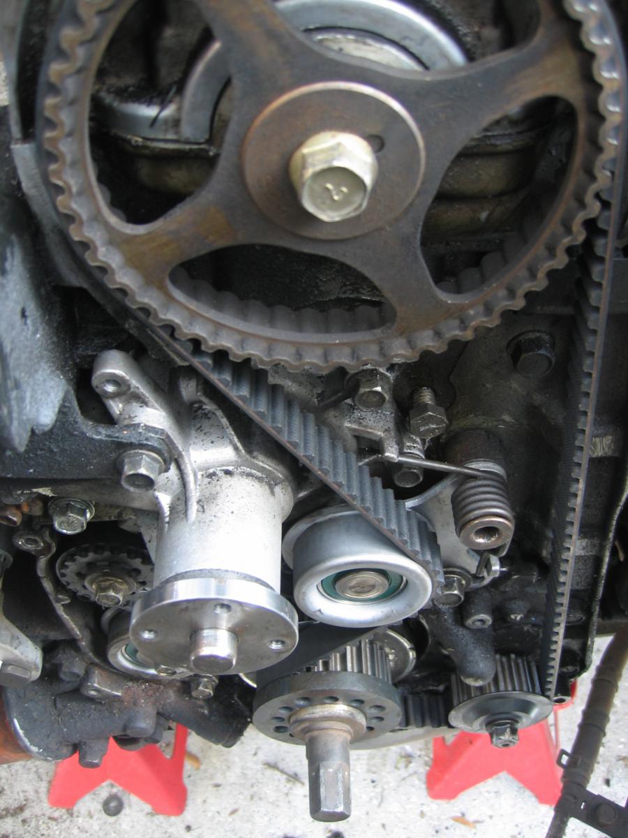

    Good news! This motor is not an interference engine! I confirmed this by turning both the crank and camshaft, one at a time. The valves never touched the piston. Got the new belts and tensioners on, and she fired right up. Couple pics for your entertainment..
    All put back together:
    Another pic of the timing tensioner for shits and giggles:
    Unfortunately, she shakes like a washing machine on spin cycle

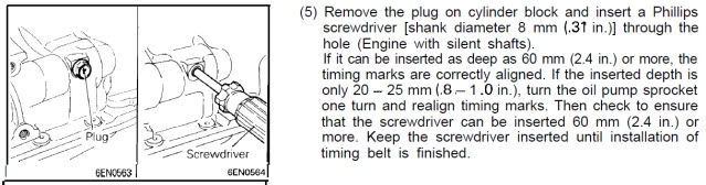

    I'm thinking it might be because of the oil pump sprocket.. am I correct in thinking that there's a balance shaft behind it too? I was pretty sure there was 2, but not sure. I spent alot of time on the other side that has the balance shaft belt. I aligned the oil pump sprocket with its timing mark.. But that was it. Didn't think I really needed to do the next step.
    I'm going to try to play with it more tomorrow, so in the mean time, can anyone tell me where exactly this bolt is? I looked on the drivers side of the engine and saw what I thought to be it back towards the starter. Just want to make sure that's it. A little confused about this part too.. I'm supposed to rotate the sprocket until I can fit the screw driver all the way in.. well, are the timing marks supposed to be aligned then too? What if they're not? Does the balance shaft only turn one full rotation when the sprocket is turned twice? That's the only logical thing I can think of..

    Alright, well to answer my own question.. yes, there is a bolt back by the starter on the block. That is the access hole to the determine if the balance shaft is aligned properly. Skipping this step will only cause you headaches.
    After doing that, I got everything aligned up properly, and started her up. She still ran like crap.. then I realized I had #2 and #3 spark plug wires crossed. Swapped those around, and all is well! She purrs once again. Next project is to swap out the front struts. Won't be getting around to that until next week probably, so if any of you have some tips or tricks for those I'd appreciate the advice.

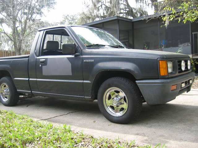

    Slight update here..
    A couple weeks ago, my water pump gasket decided to blow out.. Wasn't too difficult of a fix. Now the new one doesn't leak in the back like the old one did, where the heater line hooks up. So that's nice. It is however leaking/buring coolant somewhere. I practically have to top it off every 2 days of so, depending on how much I am driving. Plan on doing a leak down test on each cylinder as soon as I get a new air compressor, as our old one finally crapped out. Aside from that, my alignment is still rock solid, tires are still looking great. Motor is still running good and strong. Has been quite nice actually.
    Today I decided to clean her up a bit. The truck itself will never look very good with the craptastic paint job it has, but man do the wheels shine now

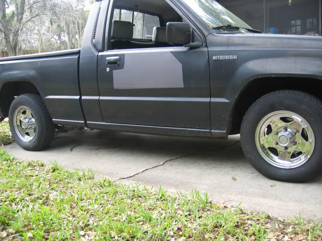

    Decided to try painting my door yesterday and today. I'm pretty good with a rattle can, and have done fantastic jobs on smaller parts. This is my first time trying to rattle can something on a "large scale." Came out really good I think, chose a semi-gloss black. Was paranoid to boot about getting tiger stripes showing through. I've seen some horrid rattle can jobs done out there, and did not want to be driving around looking like a fool.
    Before (Previous owner, dont ask..):
    After:
    Now the rest of my truck looks super dull. At least it doesn't stand out too bad like it used to. Still gotta do the drivers side door too. Figure I'm gonna try to knock out one panel a week on my 2 days off. Sand and prime the first day, paint and enjoy it the next. At least, as long as she stays running for me that is
