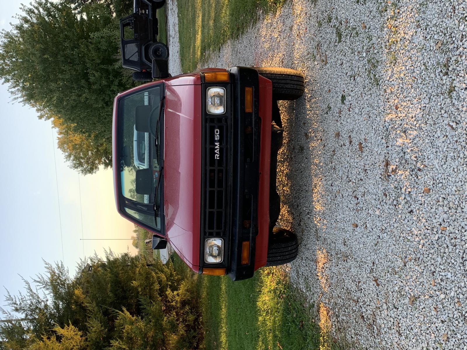

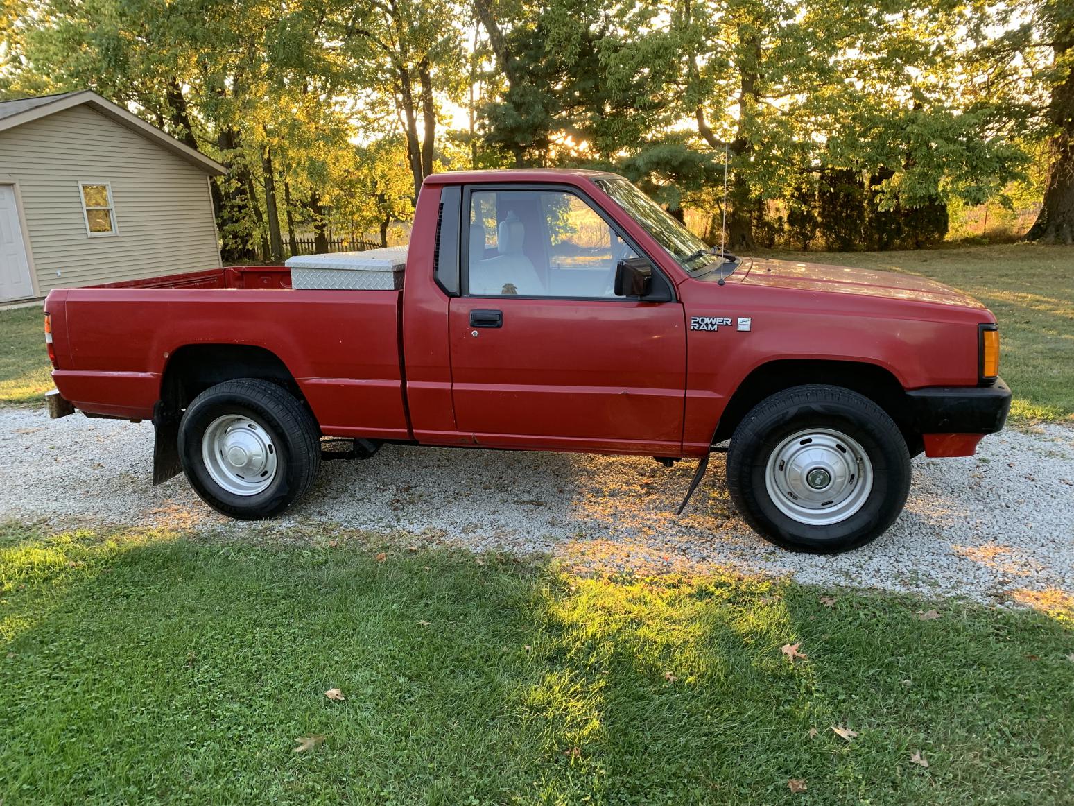

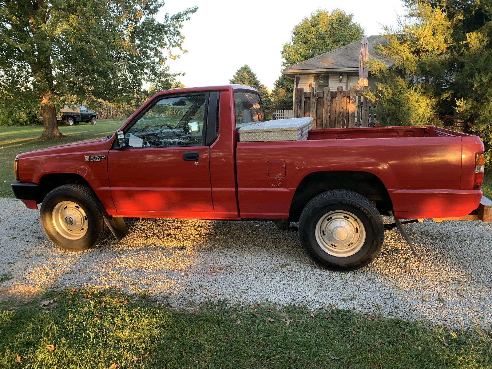

    IMG_0423.jpgIMG_0424.jpgIMG_0425.jpgIMG_0431.jpgIMG_0430.jpgIMG_0428.jpgIMG_0432.jpgPZWX7926.jpgIMG_0433.jpgIMG_0736.jpgThese are all the Photos I could find. Last one is after the paint job. All ideas are welcome! I'm just glad I found this forum! Not much info on these things. Thank you geezer101 ive looked into all that and im worried it will turn into a HUGE project with only gaining a little bit of pep you know..

    Nice truck.

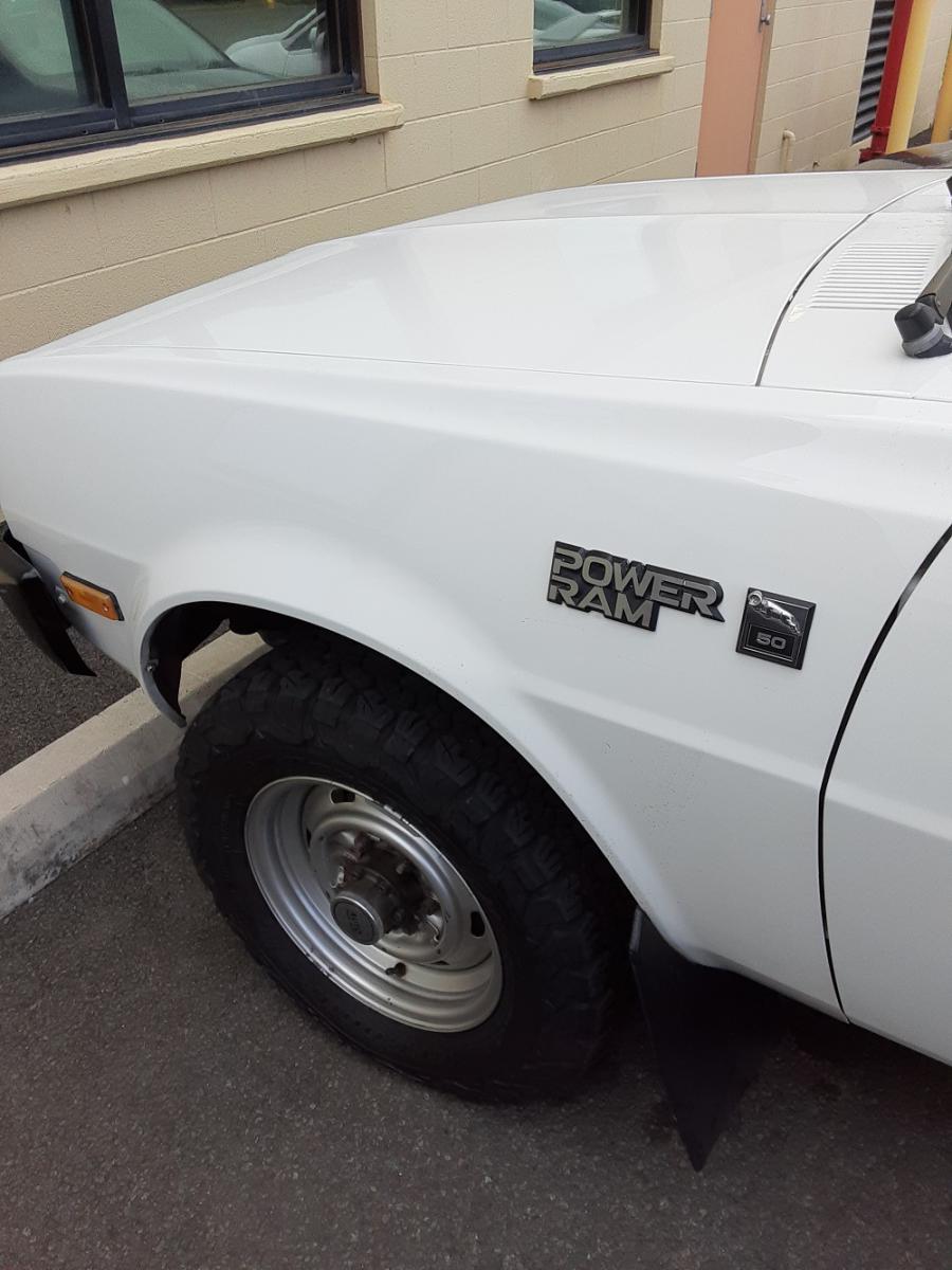

    Welcome, enjoy that truck, it looks great... The last photo 10 of 10 (painted truck) has the POWER RAM 50 logo correctly applied in original configuration...

    That's a very nice truck! My vote since you're asking to keep the original engine or do a swap would be to keep the truck stock since it is very very nice but that's just me. You might go with the recommended carb swap or at least check out the vacuum diaphragm for the secondary at least to make sure it holds vacuum since they often go bad causing a lack of power. your other post mentions possible blow by and original exhaust. I would if it were me, check out the compression and possibly the exhaust for restrictions. I know my cat disintegrated and plugged itself up. 77k miles isn't much though so the blow by does seem strange. I wonder if the truck has sat parked for some time and the rings may have just gotten sticky/fouled maybe? I once pulled the head off an 84' dodge 400 (same engine as these trucks, well mostly) that had something like 50k and it had lots of carbon build up in the head and on the pistons like it just got driven many short trips which didn't burn off the carbon. I kinda wonder if maybe an oil flush and some seafoam in the oil and fuel and an hours drive may clean things up? how do the hydraulic lifters sound are they noisy? looks like your truck is a base model like mine. I have never seen one with the cigarette lighter delete still there before! the radio looks like either a dealer add on or an aftermarket unit which may be repairable if you wanted too or there are many factory and non factory options that go right in, hopefully yours has the radio brackets to securely mount the radio, if not they are easy enough to get but you will want them even if you go with an aftermarket deck to keep the radio from hanging on the brittle bezel. hope all of this helps!

    And lastly, sorry xboxrox but I think you're mistaken about this:
    The side badge was correct before the paint job, on the last photo is out of order....

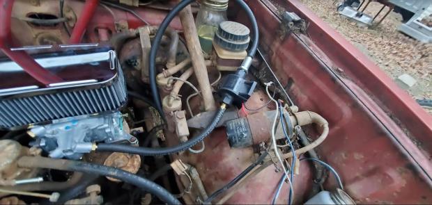

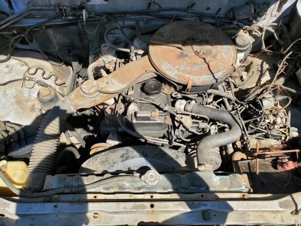

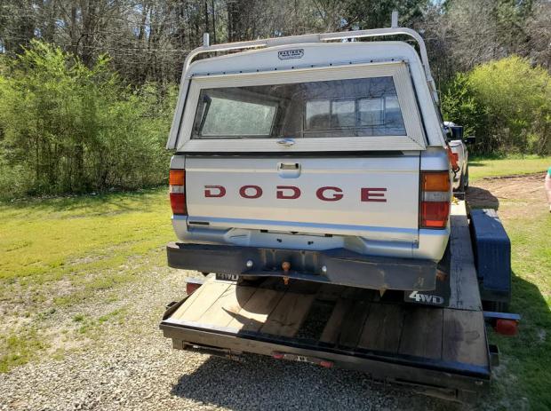

    I have a 82 8V motor in my 87 4x4 (will include pics) mine wasnt *MINT* but it was in some good condition. The original owner has a custom camper top with a boat rack installed, he also took it to Ga. to have the whole underside sprayed in a protective coating. he had the head go out on him in 99, and again in 03, it happened again on 06 and he gave it to my uncle. my uncle put a 82 head on it and drove it until the water pump belt broke, and it popped a freeze plug and i think the block cracked. it has one hole in the fender, an aftermarket radio, etc. because my uncle put an 82 head on it he went with a towing cam. thats coming out and going in the 82 motor, and then its going in the 87, of course after i replace all the pumps, belts, timing chain (its at 59k so its about time) gaskets and wash all the mud off of it. i have the weber 38/38. its a syncronous carb, which meand both barrels open at the same time thanks to a gear set on the throttle plate. i had a bunch of jets laying around, and a 115 worked best for me. i have a header that eliminated that egr crap, a swell as the car, and the res and tractor muffler is gone too.
    the 82 had some wagon wheel style 15" rims i really liked, so i had them sand blasted and painted, and for christmas dad wrapped them in 235 75 15 M/T tires. (29 x 9.25) which is like a quarter inch taller and wider than the 225 that were installed factory.
    here are a few pics:driver_side_view.jpgdriver_side_view_1.jpgengine_bay.jpgengine_bay_3.jpgdriver_side_quarter_view.jpgdash_cluster.jpgpassenger_floorboard.jpgpassenger_seat_1.jpgrear_view.jpgwheel_offset.jpgpassenger_front_quarter_view_distant.jpgmikuni_280_carb.jpgengine_bay_2.jpgchristmas_stuff.jpgFront_passenger_quarter_view.jpg

    MrPaco, I just posted a big reply 'n it disappeared, so here is a shorter reply about the emblems...
    Internet photos show Ram 50 trucks have emblems placed all sorts of different ways (did the Japanese not follow instructions..?) Full size Dodge Ram 150 pickup trucks of similar years pretty much all have the same emblem placement (Made-in-USA by Americanos)... My truck seems wrong on the Left side and 88powerram's truck seems same as a full size truck correct on both sides... But not until after it was painted, someone changed the Right side emblem placement on his truck... My truck emblem photos today: Thanks for pointing me in the Right direction MrPaco
