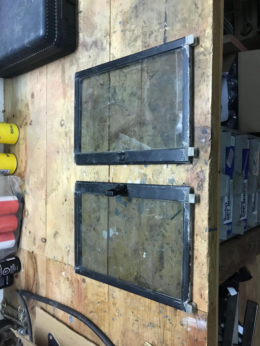

    Thanks StarquestMan. Both of the sliders on the first widow are broken. The second window has both sliders but they are not exactly the same as the sliders were in the first window. These have a full aluminum frame around them that is bigger than the sliders in the first had. I took them out to see if they would fit in the first frame and they won't. I'll put a pic of the sliders up after I get home from work today and you can decide if it will work for you.

    My gasket was new when the auto glass place tried to install it. They actually ruined the first new gasket I supplied trying to get the window in so I had to get another one to reinstall the fixed window. I'll put some pics of both frames up after work today so you can see the difference.

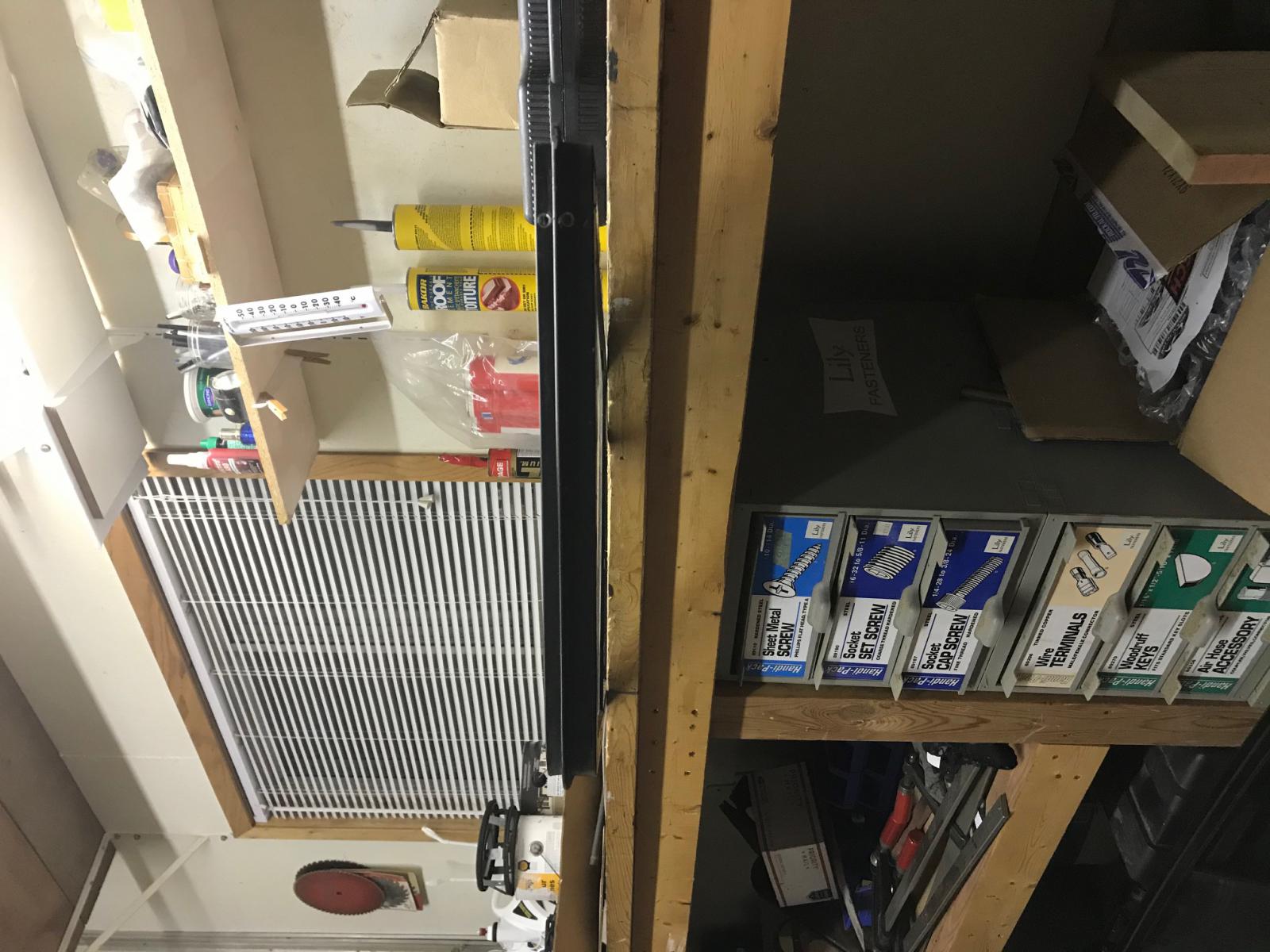

    I took some pics of both windows and the slider panels. The first five pics are of the window I ordered from the salvage yard. I put the measuring tape in so you can compare to the original that you have. I notice that the track is wider for the sliders as the aluminum frames on them are almost 1/2 inch thick. I also notice that there is not a slight curve to the frame when viewed from the end as there is on the original.
    These are pics of the original frame that came out of my 1988 ext cab 2wd

    For some reason some of the pics got rotated when uploaded.
    My money is on something had bent the frame on one of them right on the centre support. It probably had been pushed out of the cab panel by someone not being careful with it.

    Thanks for thinking about that but I have a new seal on the window in the truck and I still have the old seal from the window that came out. The window with the contour is the one that fits, Its the straight one that won't go. If you look at pic #2 you can see that the part that goes into the seal is only about 3/8 of an inch deep. The other windows part is about 1/2 inch deep. I believe this is the difference that won't allow the seal to roll over the window hole in the cab.
    Lon Moer says he moved a window from a regular cab to an ext. cab with no issues albeit the years of his trucks are newer than mine. I don't have a regular cab truck so I can't compare the window openings in the cabs. I see that there are a few windows on Car-Part.com and they don't specify reg. or ext. cab so perhaps there is no difference. I just don't want to buy another window to end up with another one that won't fit.
