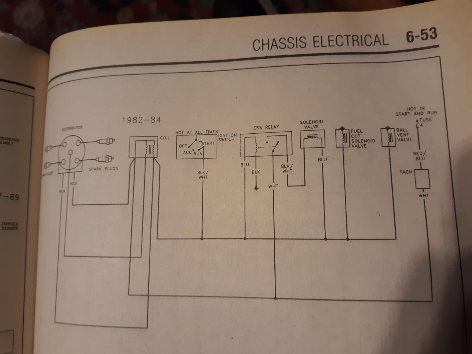

  25. #50
    08-29-2016
    253
    Siskiyou County, CA
    Sorry it took me so long to find my Chilton book, but better late than never i guess. Here is a picture of 82-84 ignition wiring. I see a device labeled "solenoid valve" that is most likely that black vacuum device near the coil. it is controlled by a relay labeled "ESS relay". Ill study this diagram later tonight when I have some time and see if I can come up with any scenarios that would cause issues with anything shorting something out. Giovanni has great points on the coil compatibility and the vacuum advance sticking etc.
