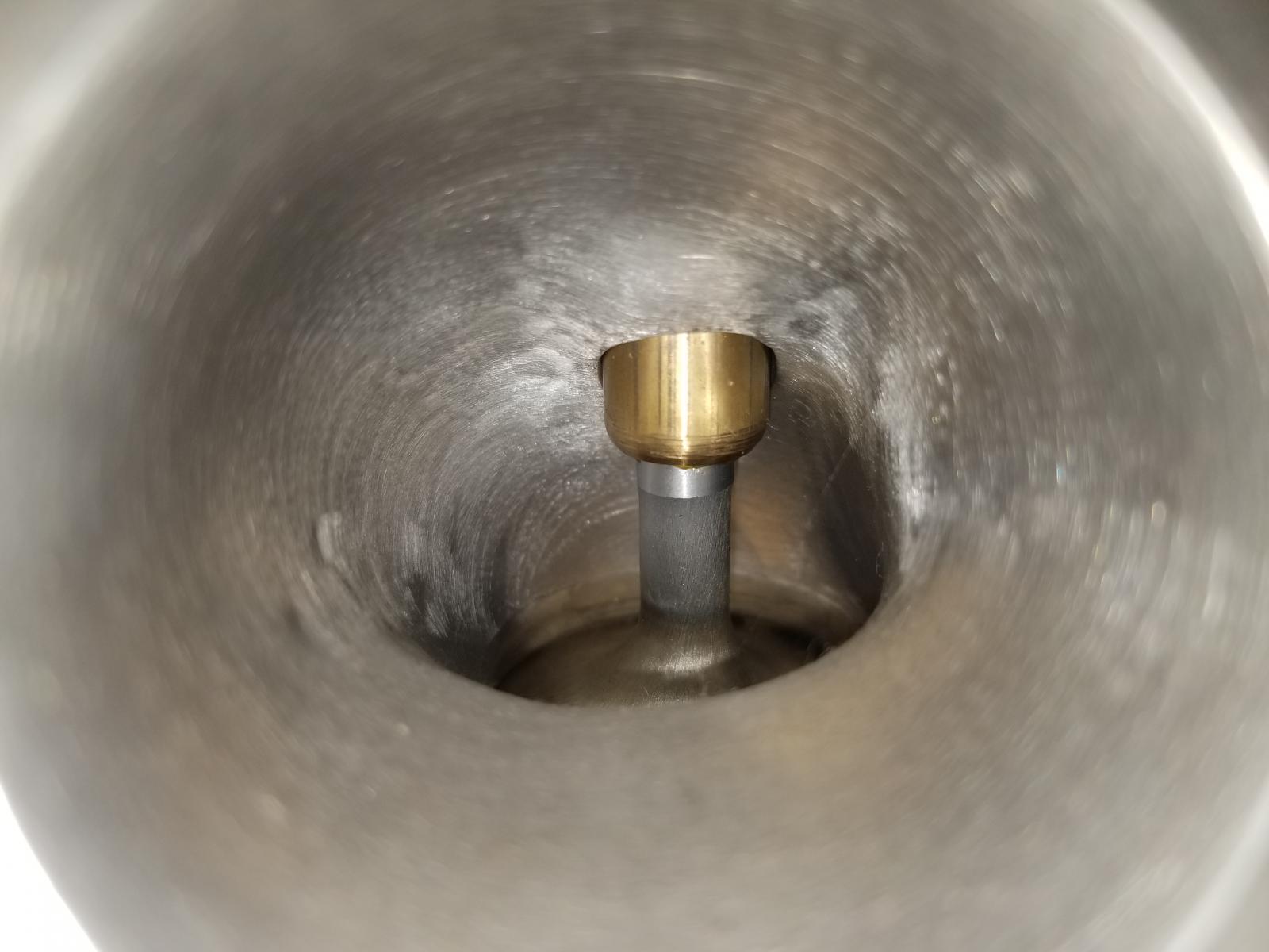

I may be getting a 2.0L valvetrain sooner than I thought. Looks like the rocker arm pedestal is cracked right at the cam gear. Going to upload a picture. I'm going to put it all back together, and just send it until I find one. Head gasket was blown at a coolant port, so atleast the head looks good.

Should I be really concerned about this? Never seen one crack here before.

I don't think they're cracks, more likely expansion lines from when it was cast. These are only cosmetic and you'll see them on the thinner cast alloy parts.

Good to know! I did find a small knick about a 1/4" long and a little deep in cylinder 3 between half way to 3/4s the way up the cylinder wall. It isnt enough to say it is a chip. Quite unusual. I'm not worried too much about it, as the engine was running well even with a head gasket issue aside from cold starting.
The question is how well it will hold up to boost. Either way I'll have a spare complete engine on standby before I hit it with a razzle dazzle engine tassle.
Motor turns very easily though. No scoring of other cylinders. And aside from a lot of carbon build up, it was surprisingly clean.
Ordering a timing kit, as the belt looked factory, then putting it back together.
