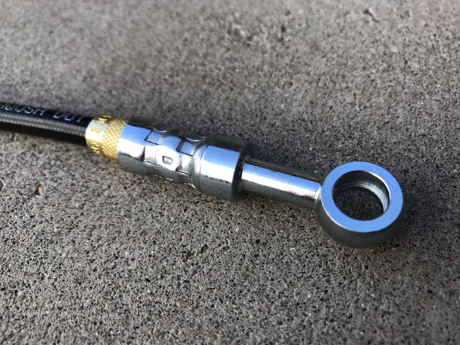

    Having nearly 30 year old brake lines on a truck is dangerous and makes for some spongy brakes. OEM rubber lines came with some fade from the factory as its inherent with all rubber lines. The advent of Braided Stainless technology has made it so your brake lines wont deform/fade under pressure and with the internal PTFE (Teflon) liners they last longer than you or I. Luckily I have access to the proper tooling, fittings and test equipment to make these lines.
    Decided to fix our 4x4 V6 Truck this weekend. Here is how we started with all stock minus the Gen2 Moni calipers.
    Luckily I dont live in the rust belt, so these came off pretty easily. Only one or two put up a fight.
    Some of you may not know this but the 4x4 Max uses 2 lines on each front wheel. Made each line, then pressure tested to over 3,000psi to exceed DOT spec. All passed.
    Two new lines for the front Passenger vs the two old lines.
    All plumbed up and installed on the fronts. Added new retainers as well.
    Tackled the rear axle next. Fabricated them about an inch longer to make sure I had additional room for flex. Quite a bit faster to do than the fronts.
    Wrapped it all back up, flushed out the old brake fluid, bled the system and took her out for a stroll. Brakes feel much better and firmer. I get greater feedback from the pedal and I also don't feel like i have to press as far, or as hard to get the brakes to start biting.
    For how inexpensive an upgrade this was its worth every penny. Sure, we all want to go faster, but do we think about how much faster we need to stop our vehicles? Also if any of us have swapped out the factory wheels and tires for bigger ones, your brakes now have to work harder and your truck takes longer to stop due to that added sprung weight.
    Anyways great upgrade all around.

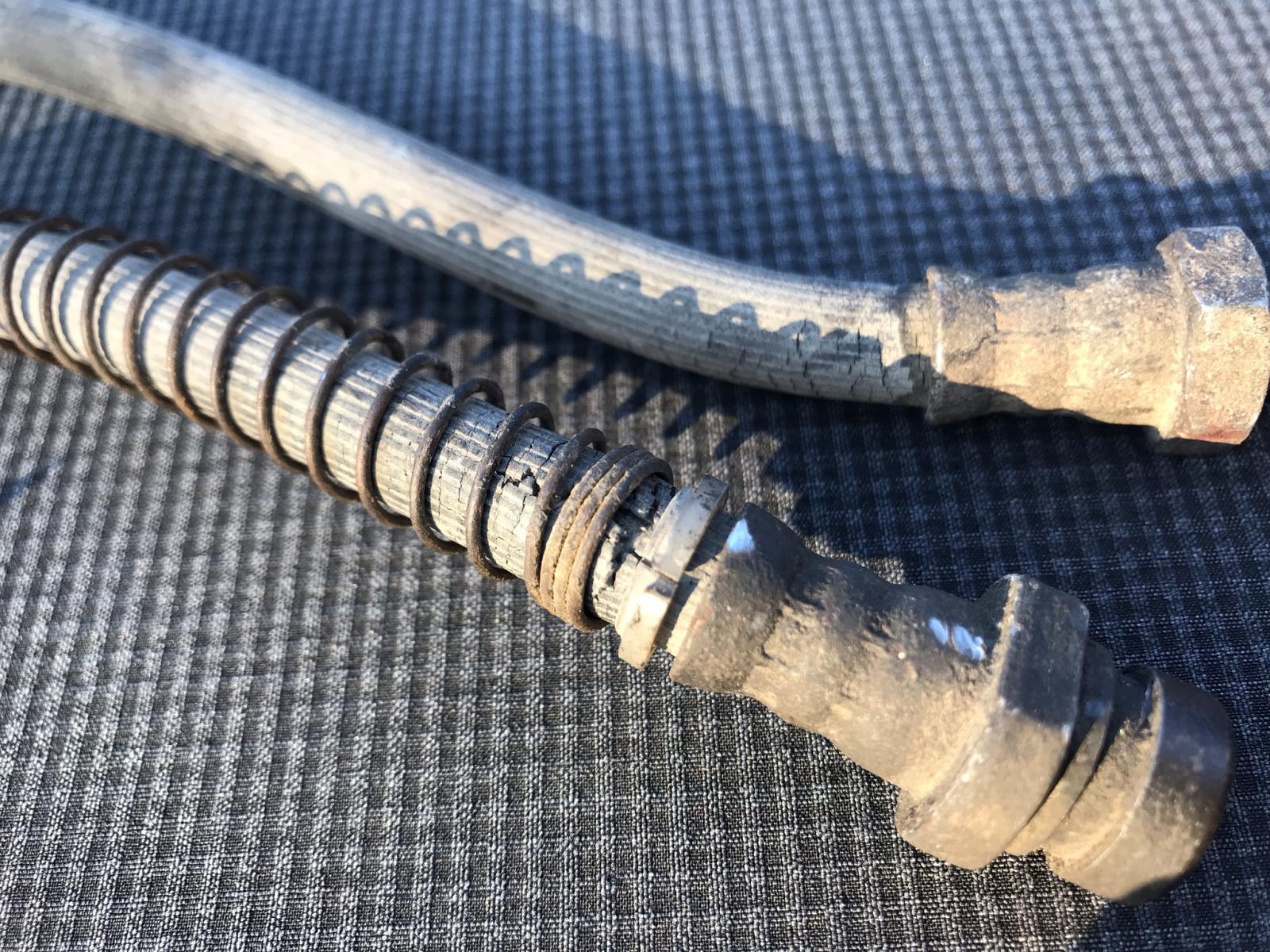

    Now to help put in perspective how old all of our lines are, this picture below what age does to rubber. You may not know it, but everyone's trucks on here are at least 25 years old and up to 41 years old. Rubber lines are only designed to last up to 7 years. They are considered a consumable part and must be inspected and replaced as necessary. I was a bit shocked to see the lines below, and yes they had a slow leak. These lines are also from a part of the country where its not overly wet or humid, so they would be considered better off than most. I imagine these are best case scenario for most 30 year old lines. Be safe out there.

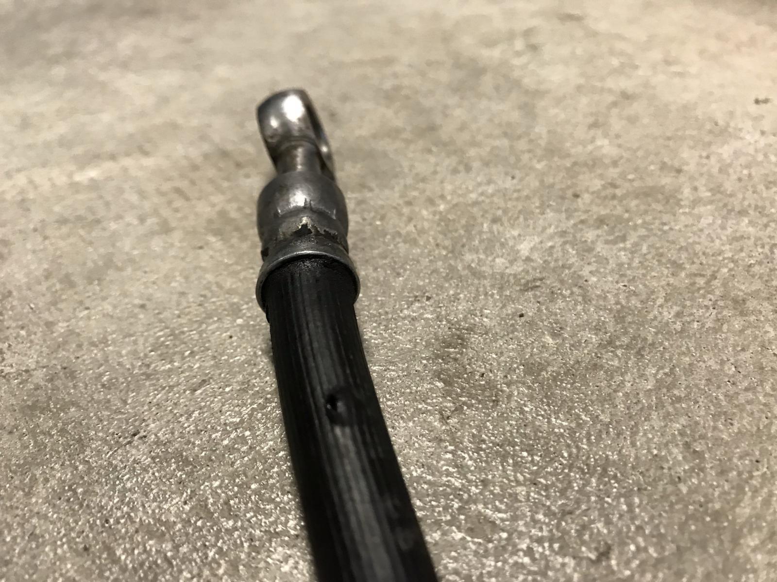

    Another Update:
    All of you 1990-1995 4x4 V6 owners now have a new Hydraulic Clutch Line replacement. We were inspecting our 91 4x4 and decided to tackle this project as well. Good thing we did, because this line was already showing some severe cracking in the line as well as right at the fitting. What is worse is that there is some bubbling in the line from heat. Yes, it got so hot that it caused the rubber to liquefy. We are confident this is due to its proximity to the exhaust and its excessive heat.
    Good news is we have the correct solution and replacement. One that wont deteriorate.
    You will need to reuse your banjo fitting clip and bolt, but we will get you new retainers and brass washers.

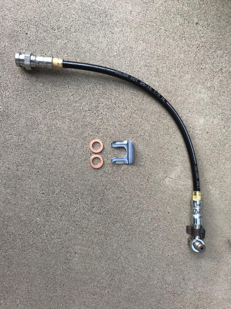

    Again, what you will receive when purchasing one of our 90-95 4x4 V6 Truck Hydraulic Clutch Lines (except the dirty banjo retainer and bolt that will need to be reused).

    New banjo bolt included ???
    Thx.

    No new banjo bolt or retainer clip. Reuse your original. Please see above.

    With respects, I have replaced many overtorqued banjo bolts .
    generic 'web context' example
    ???Maybe provide an 21'st century banjo bolt upgrade to go along with 21'st century lines???
