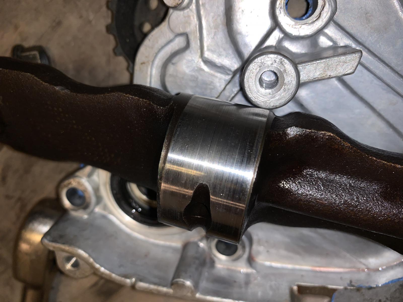

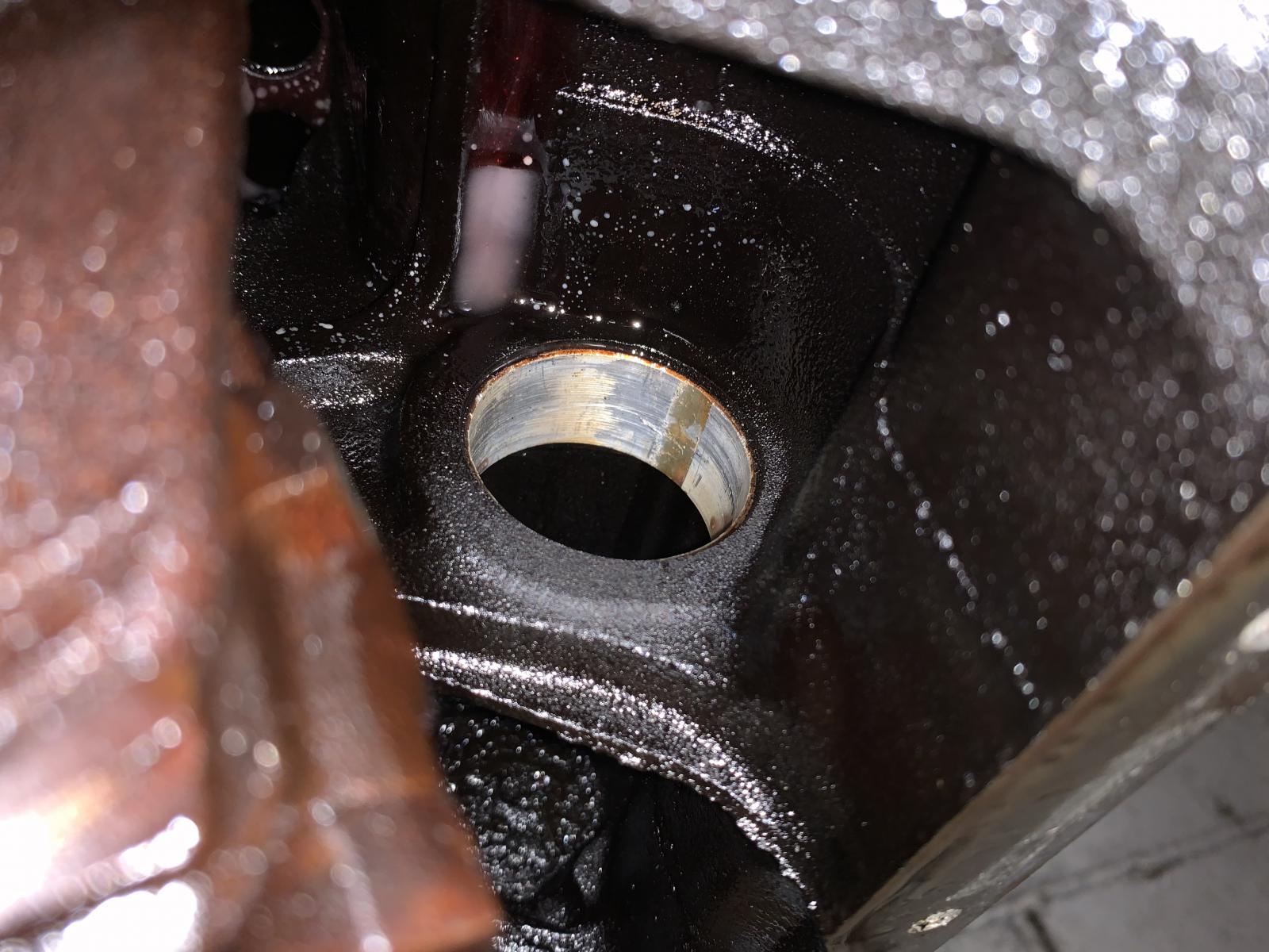

    Here is pictures of my silent shaft and bearing. It turns smoothly without the pump just thought I’d ad this in
    I think that was a wise move. Let's say hypothetically you installed this pump and straight up started the engine and the pump shredded metal for some reason - it would've potentially killed your engine in minutes. Hope you can get in touch with the supplier and get this sorted out.
