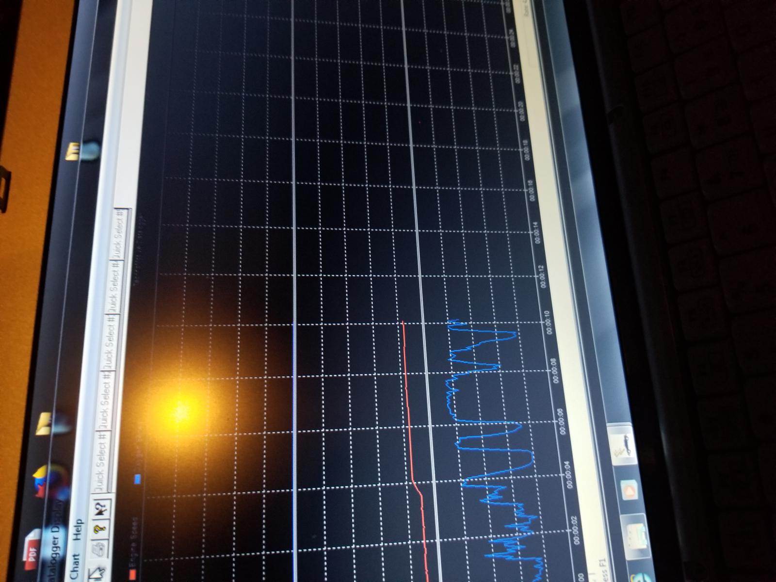

    I was able to datalog and read trouble codes on my truck using some old software and obd1 cables

    That is pretty cool - can you post up the source for the software and what code reader you used to run the diagnostic?

    I was using the software called tmolog that was almost 20 years old,but i'm trying to use my phone to read the data,i can read the data but not the codes

    Im using aldl droid on my andriod phone to get the data below still working reading codes here is the link to the software for the phonehttps://www.aldldroid.com/
    Attachment 23755Attachment 23756

    - By way of curiosity, ?? DRB II interface & Graphing on a laptop ?

    The tmolog had a DRBII features or emulator built in, I was able to shut off individual injectors as the car was running, also showed the reason for a had start one of the two trucks I tested on was a coolant temp sensor reading negative 60 degrees. Still trying figuring all the features
