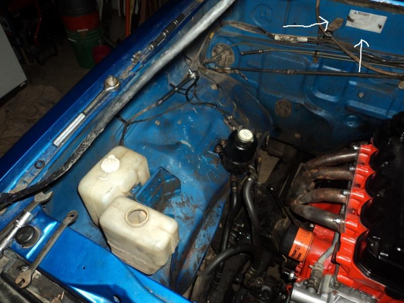

    there should be a silver plate at the back of the engine bay right here (see picture)
    that will tell you what the transmission is. plus, if you ever need to get the truck painted, the color code is also on that plate. as well as other sometimes useful numbers. welcome to the site.
