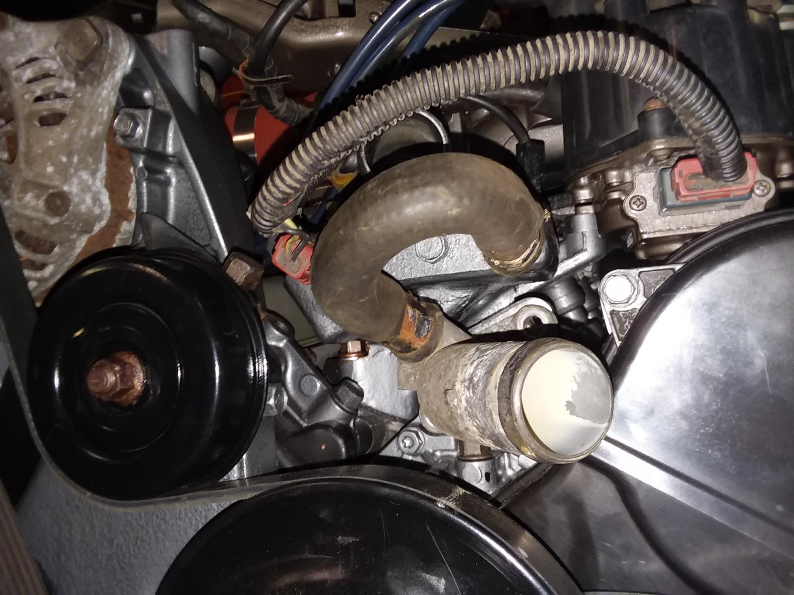

    sooo, i had to fab a new radiator hose inlet for my engine to use the
    new radiator i have.
    my question is regarding this silly little U-shaped hose that seems to act as a bypass
    from the thermostat housing around to the radiator hose inlet underneath it, pictured here:
    Is this bypass hose important??? the new inlet i made without a nipple for this hose,
    i just want to be sure that capping off the remaining nipple and eliminating the hose
    altogether is NOT a bad idea.
    should i weld on a nipple to retain this hose routeing in the system or am I cool to delete it???
    any thoughts or insight would be super awesome. thanks fellers

    Staring and thinking about it more, its got to be a pressure by pass that just let's coolant
    flow round the thermostat when its closed, obviously.....
    I think I'm gonna in bolt it for the 3rd time and weld that nipple on, just so everybody is how it was.

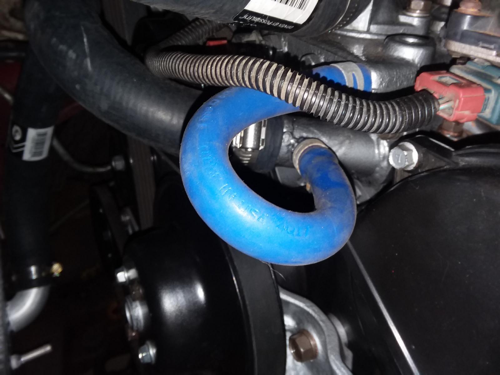

    i recieved the truck with the little U-hose on those two nipples, just routing around the t-stat/radiator
    from, yes, the upper Intake mani (or under the thermostat) down to the water pump inlet that pulls from
    the radiator outlet, down at the bottom of the rad.
    this is how it was only with a new piece of hose and my new water pump inlet:

    so its exactly like i received it, and i never noticed any overheating issues or whatnot, drove it for a year or more daily
    like 100miles a day....
