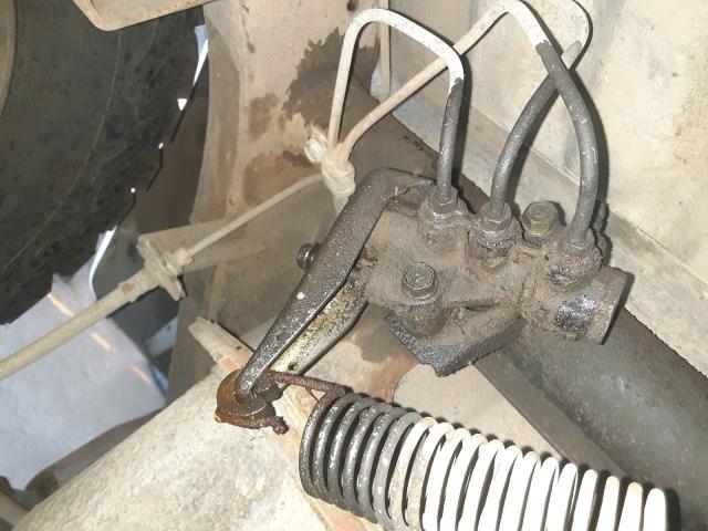

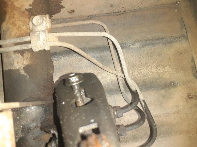

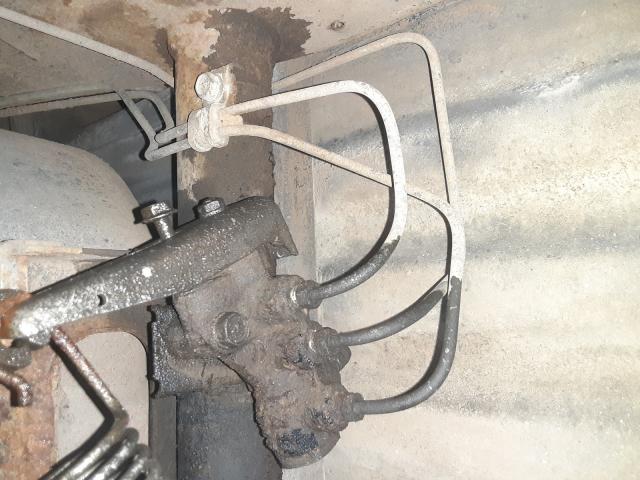

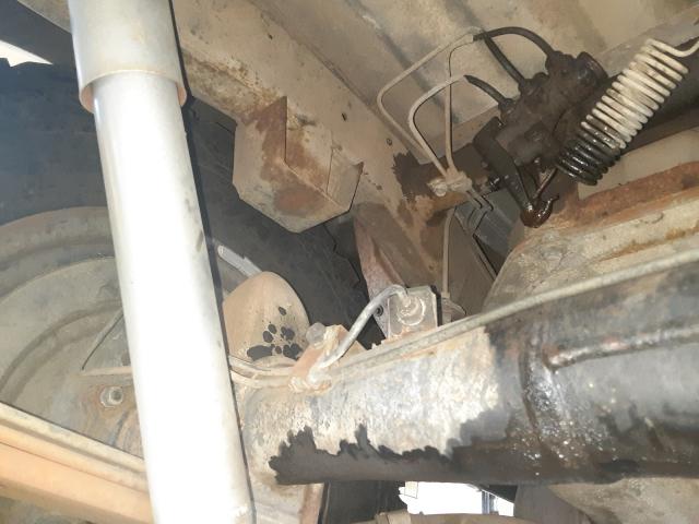

    I been chasing a brake fluid leak problem ~ found the leak at this LSPV load sensing proportioning valve ~ I've never known that pickup trucks have these valves ~ learned something... Anyway, I went with ebay (Jeff Bezos is wealthy enuff IMHO) and ordered the L200 version as it looks the same ~ they all come from China; there musta been a bunch of L200 trucks produced & bunch of failing LSPV for the Chinese to mass produce these valves..? I did notice the seller increased his price by $20.00 after my order of $49.00 + tax $51.00 free shipping ~ I went with this seller because they have the fastest shipping item due to arrive Dec 6 to Dec 20... X'ing fingers that it will arrive & fit properly...
    LSP & BV (good info): https://www.toyotavantech.com/forum/...d-Bypass-Valve
    Am pretty sure the Chinese valve photo shows a white plastic clip holding the spring to the valve lever ~ my original clip is metal ~ ordered from this seller: https://www.ebay.com/ipp/27304032363...2047675.l48352
