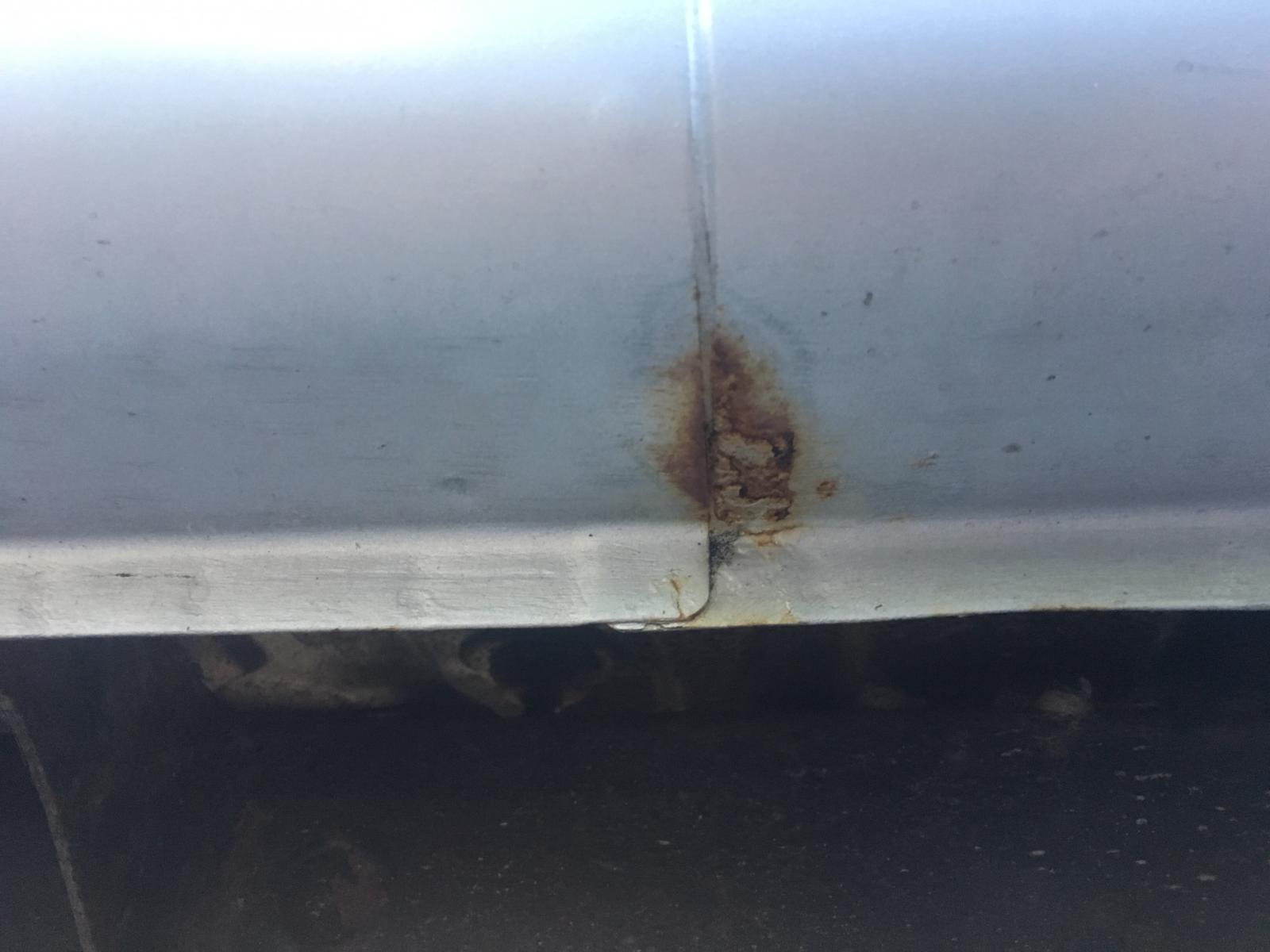

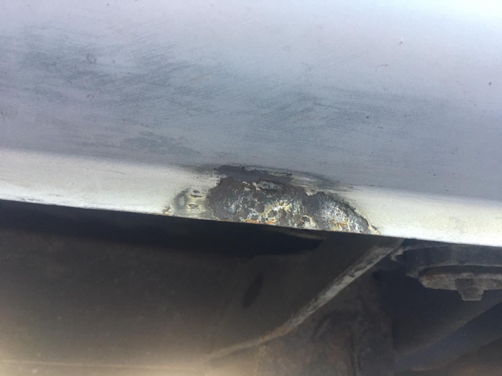

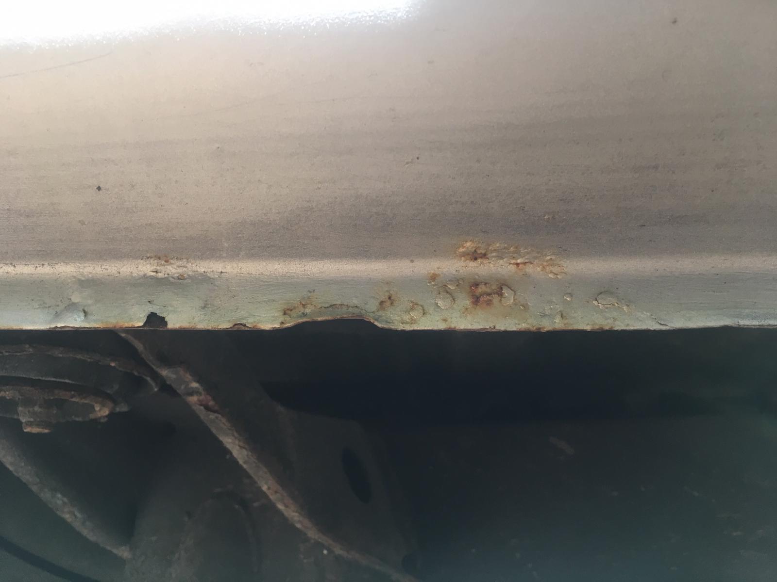

    I have a little bit of rust at the bottom of the rocker panels and want to address it before it becomes an issue. I already tried it once, but the rust came back. I have a new idea I'd like to try, but want to get some opinions from others with experience on rust and body work first.
    The rust is at the very bottom of the panels, I previously stripped off most of it, and some of the paint around but since the metal is thin in this area I was afraid of ending up with holes if I stripped too much. I stripped as much as I felt comfortable, then I hit it with loctite rust neutralizer, then primed and painted. It took about 2 months for the rust to show up again through the paint, so it didn't work.
    I'm thinking about doing something different this time: Stripping the paint down to the metal on a 1" strip down the whole length of the panel, making a clean cut. Then leave it uncovered so that it rusts a little bit and and when it does, hit it with rustoleum rust converter so that it creates that black surface that becomes rust proof. Then cover that with rustoleum undercoating, or maybe spray on bedliner.
    The rocker panel would end up with a black 1" strip at the bottom (mine are silver), which I think will look fine, and the new surface would be more chip and rust resistant. That's the theory anyway, can you tell me if this could work or if it's a stupid idea?
    Thanks
    Some of the rust spots after they came back (the last one is what it looks like after stripping most of the rust off):

    It looks like the rust converted to iron oxide to me. That is the black color. And it looks like he's cleaned it up to get rid of the loose rust. My experience is that if it is dry, degreased and he seals it that spot won't rust again.
    If you get rust in the area again it means you left active rust behind.
    1,219
    This will be caused by rust coming through from the inside. In this case between where the inner and outer sill join.
    Because it's already started (and the majority of it is not seen) it will be difficult to stop, but you can buy some time. Flood the sill with your rust treatment (phosphoric acid, that's what turns it black) and then flood the sill with cavity wax. Do this till it drips out all over your garage floor (get the wax hot so if flows better, a nice summer day is perfect along with keeping the can in hot water) it will wick into any panel joins and seal it from moisture and air.

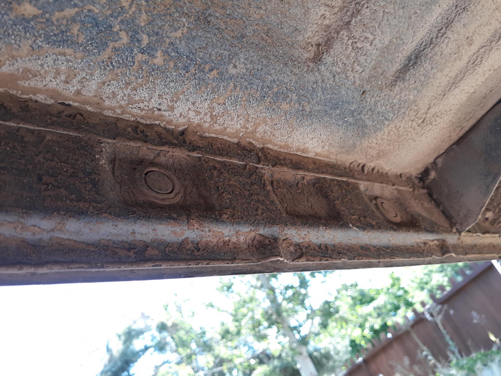

    tortron and 85Ram50's posts reminded me about these plugs that i saw on my 2nd gen truck. they run along the bottom of the back side of the rockers and should give excellent access for adding the acid and cavity wax.
    one thing that comes to mind about applying this cavity wax is that it may be a good idea to temporarily plug the weep holes along the bottom of the pinch weld to help the wax run the length of the rockers and then unplug them so that future moisture can drain properly so it doesn't fill up and rust above where the wax is? since there is rust holes that needs to be repaired and we are on the subject what do you guys think of body solder? i know eastwood sells it and i have often thought of using some for some of my projects and it seems like a very permanent way to repair rust or minor body damage that may be a good fit for rocker panels that take more moisture and abuse? that is very interesting BTW about your Dakota having bondo and rust under the factory primer 85Ram50.

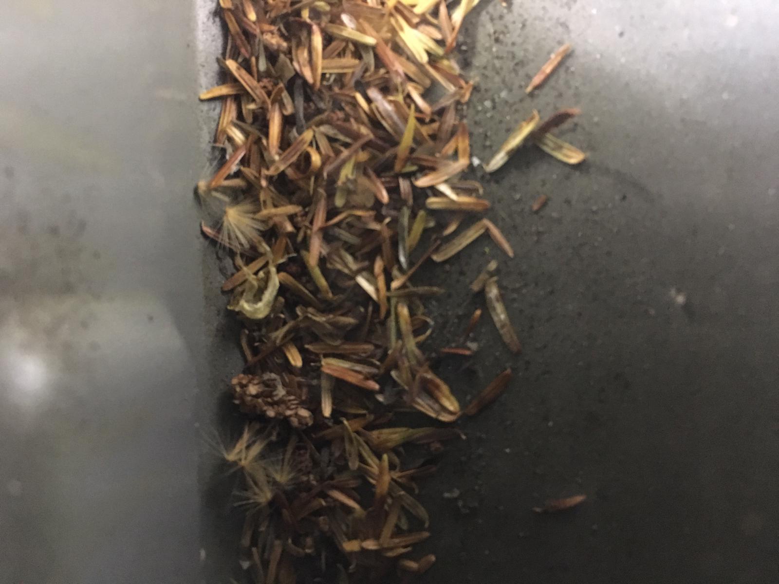

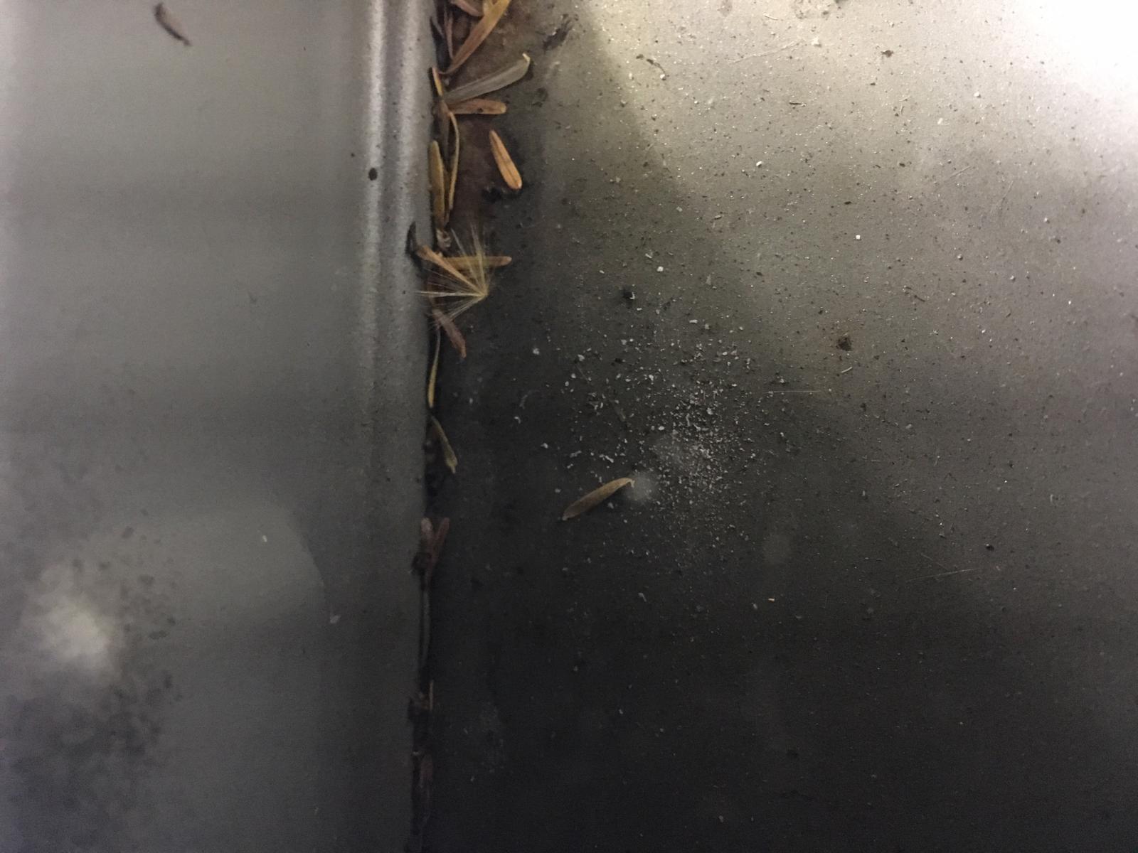

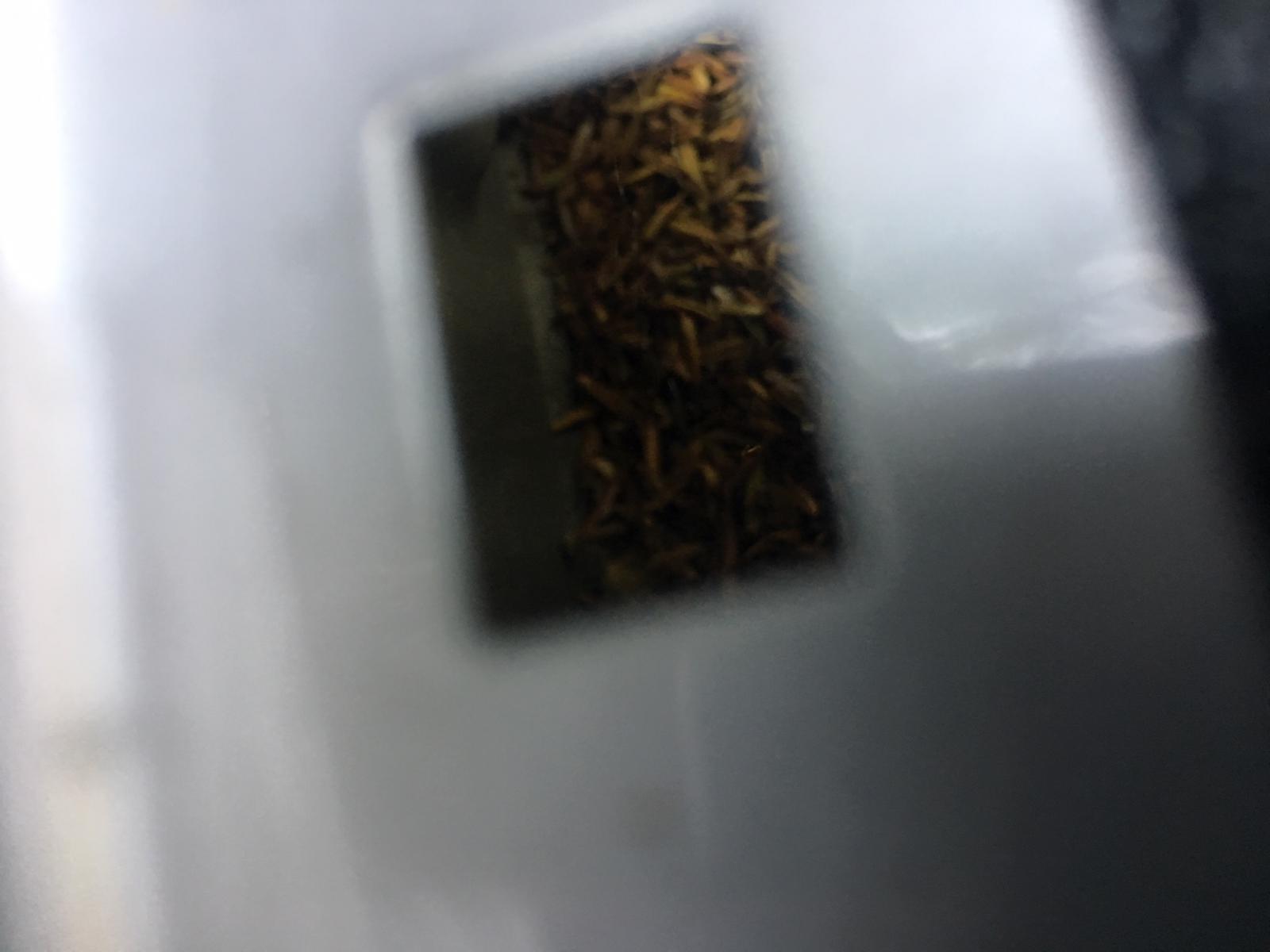

    I was able to take a look inside the rocker panels by removing one of the rubber plugs on the back side, shining a flashlight into the panel and looking in from the square holes on top where the scuff panels screws in. Thanks to starquestman and tortron for pointing out those openings.
    The good news is that there is no rust in there, so I don't need to worry about threatening that area. Just need to figure out a lasting solution for the surface rust issue on the outside that keeps coming back. I think I'll treat it with the rust neutralizer again but hold off on painting for a while, until I know for sure if it worked.
    I did find a lot of pine needles inside the rocker though, so I have to figure out how those are getting in (my guess is through the front, from the runoff drains of the air vent cowls next to the windshield wipers), and how to vacuum them out of there so they don't collect moisture.

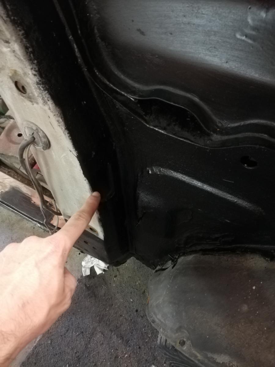

    Water would normally drain from one of these two vents
    Oops can't see it but there's one in the a pillar where my finger is. It appears to be fully sealed so water/dust wouldn't normally get to the sill from here.
