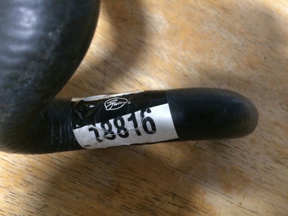

    Where can I get this hose?
    I replaced the ruptured OEM hose on my truck with a straight hose. The original hose was curved, but when I went to the auto parts store to get an exact replacement, they didn't have it. So I used a straight hose instead, thinking it wasn't a big issue. While getting my truck ready for my new weber carburetor, I got a better view of the hose after removing the mikuni carburetor and it looks awful. I can now understand why the engineers decided to give the hose a curved shape. So that the water can flow better. (I'm such a dodo bird.) The straight hose I put on the truck looks like a kinked water hose. I can't believe the truck didn't overheat with such awful water flow. I theorize this might also be the culprit of why the heater doesn't work? Since I have easy access to the hose, does anyone know where I could get an oem replacement? Rockauto has some curved hoses but I don't remember exactly how the profile looked. If anyone can help me replace the straight hose with the proper hose, that would be awesome. Thank you.
    Mystery Solved, thanks to MrPaco! The hose is part number: GATES 18816

    Thank you very much MrPaco! Your pictures helped me confirm that the CONTINENTAL and Gates 18816 are the correct hoses. I ended up getting the Gates 18816 from Rockauto only because it has a lifetime warranty compared to the Continental's 12 month warranty. I'm sure they both will work just fine though. Heck, they probably are the same hose, possibly just rebranded. Strangely enough the Gates 18816 isn't listed under the Mitsubishi brand, nor the Dodge brand on the Rockauto website. The continental does come out under the Dodge brand on Rockauto, but not the Mitsubishi brand. I learned if you can't get a part under the Mitsubishi brand you can probably get it under the Dodge brand and vise versa on the Rockauto website or any other website. They are the same truck I believe just different brands. I took the continental part number and googled its alternatives. The gates 18816 part number then came up as a similar alternative. Out of curiosity I searched for the Gates 18816 on the Rockauto website and bam, they had it! https://www.rockauto.com/en/moreinfo.php?pk=1883I ordered it and the hose just arrived today. I put it on the truck and it fit like a glove. Thank you MrPaco for the help.
    If I were you I would replace your rotting hose immediately. I remember when my hose ruptured, it left me stranded on the street because the engine almost overheated to death. Luckily I wasn't too far from the autoparts store and was able to get a hose, albeit not like the oem one. At the time they didn't have the oem hose or it was just not under the Mitsubishi brand on their system, so I had to get a straight hose as I didn't have a choice. I needed to get my truck back home.
    Now I have the oem hose, which is so much better then the straight hose I had to forcefully bend 90 degrees to fit. As I said previously, this was an awful idea, as it restricted water flow tremendously. It's like taking a water hose and bending it 90 degrees, you will end up restricting water flow or stopping it all together.
    Just out of curiosity MrPaco, have you ever replaced your hose or is it still the factory hose? These hoses last a long time. I believe that my truck had the original factory hose and I was the first to replace it. That was like a 30 year old hose if it was never replaced by the previous owners. It looked factory though, I remember that the hose had "water hose" in blue printed on it with a triangular Masonic looking logo next to it. If you ever get to replacing your hose, it might have the same blue text as mine assuming the hose I replaced was the original. If so, may you please take pics, just to ease my memory. Below are some pictures of the hose:

    Here is a picture with all three hoses and their part numbers next to them:
    I got the Dayco hose a long time ago and if it ever fails I will replace it with a Gates hose. I believe the Gates alternative to the Dayco is part number GATES 21757. https://www.rockauto.com/en/moreinfo...sn=260&jsn=260 The pictures on the Rockauto website look similar to the Dayco hose I have installed on my truck and it shows up as an alternative on kakapart. I search for part alternatives on http://www.kakapart.com. Just search the part number you want an alternative to and it'll list the different manufactures. In my case, I searched for Dayco 71231 and a number of different alternatives showed up. It's a really cool website for searching part alternatives.

    WOW, thank you very much for your update. Glad you got the job done. Looking at the picture you took of the hose, this is the hose I was remembering about. Thank you for the confirmation. I can ease my mind now. Now I have to get back to working on my truck.
