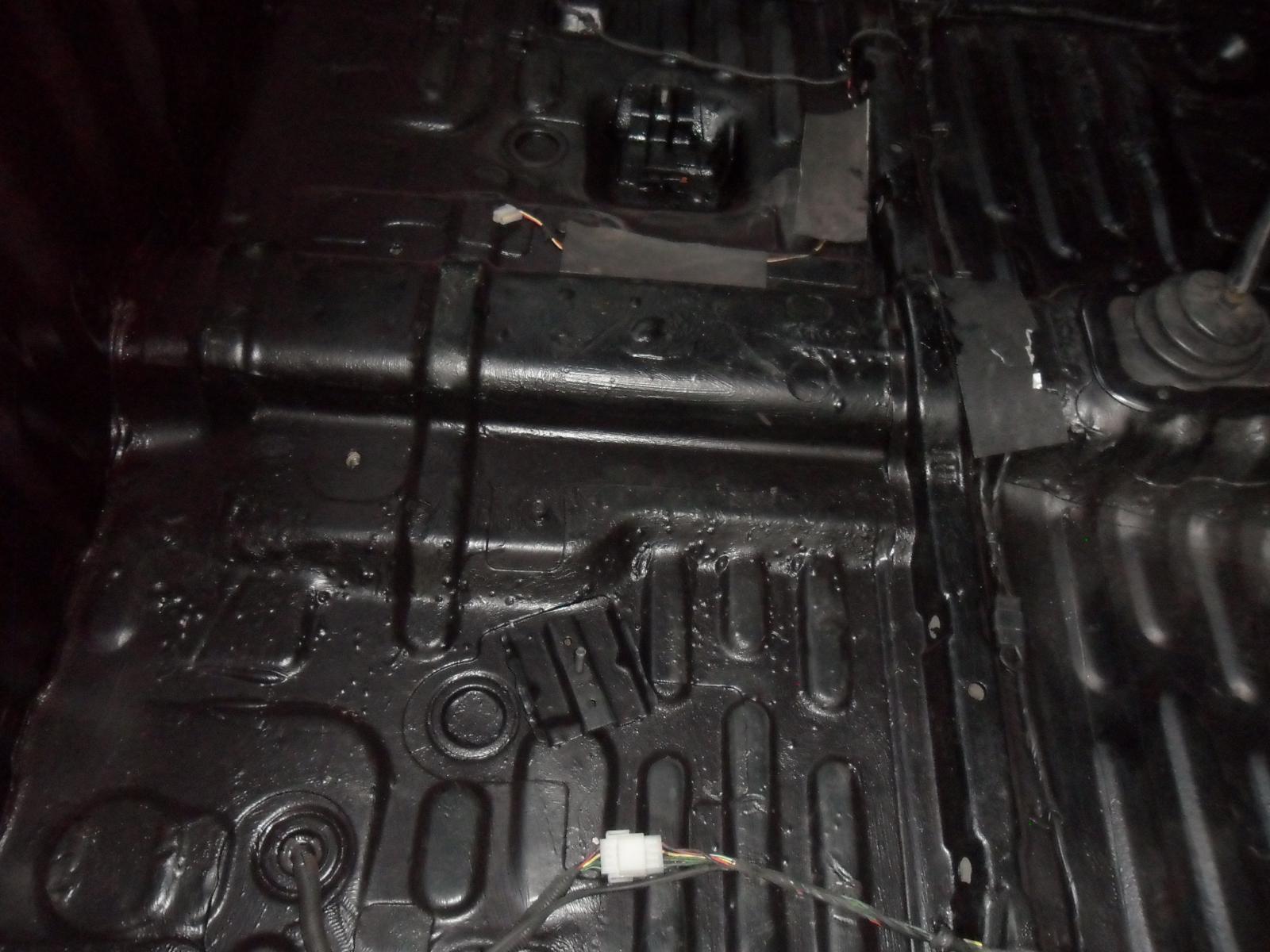

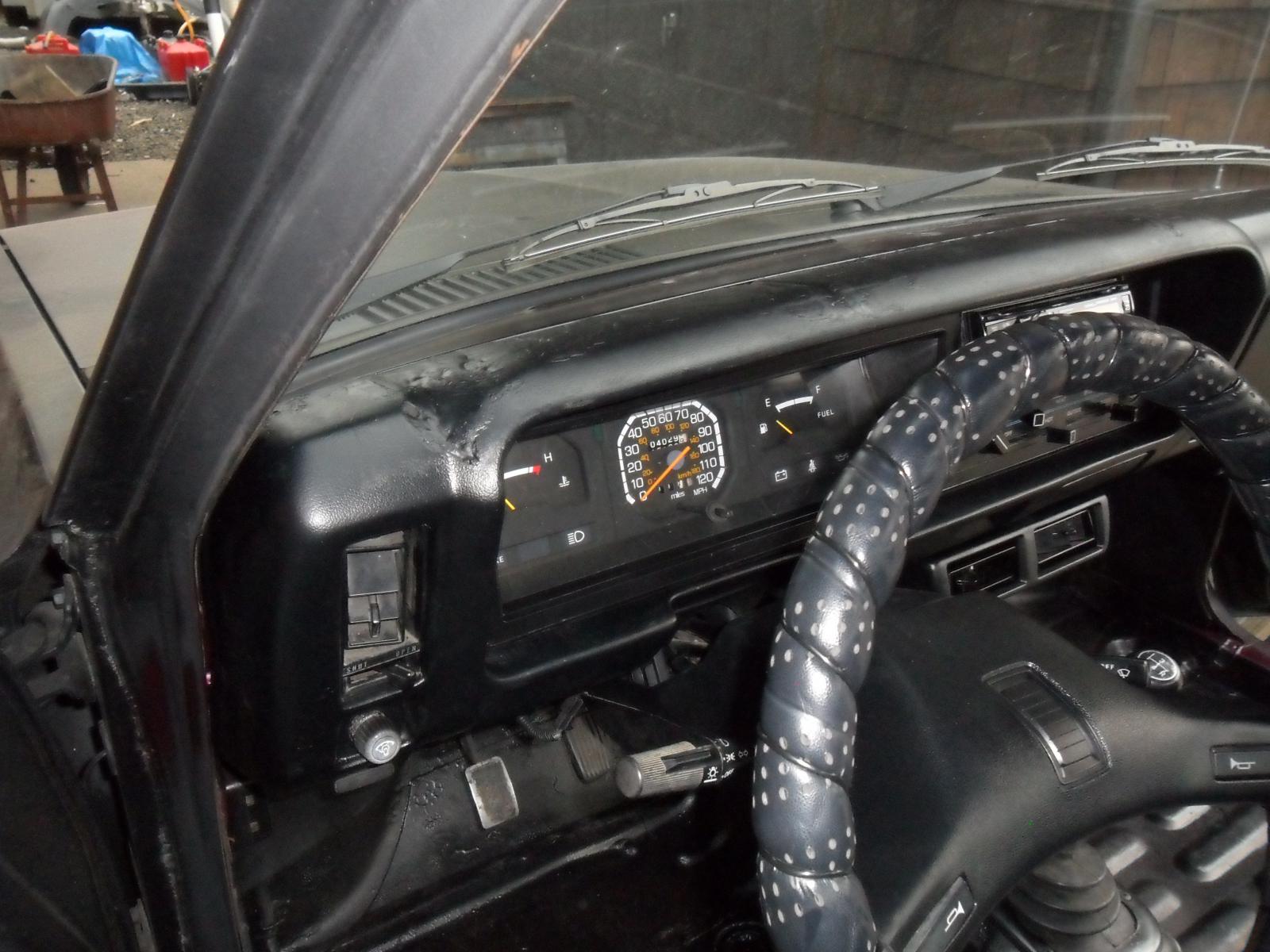

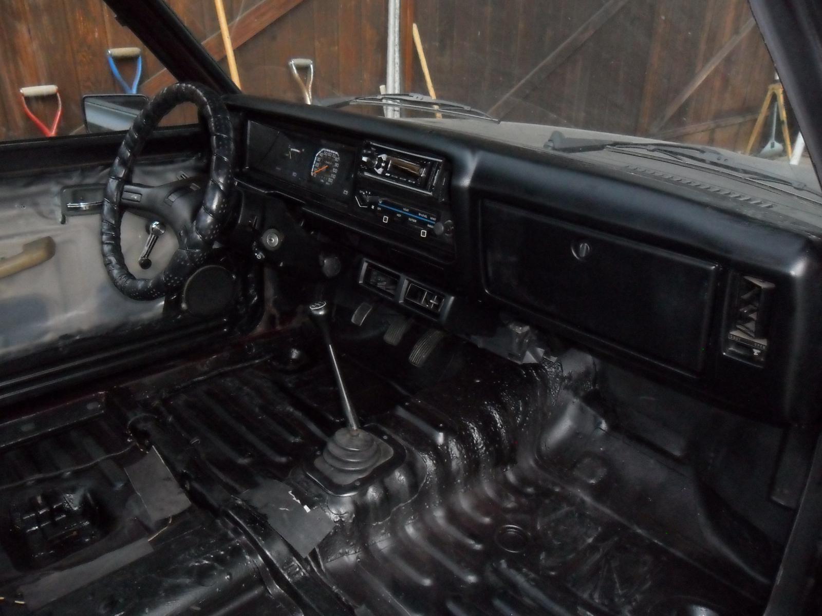

    I have finished painting the interior and putting it back together. You can see the top of the dash pad is solid but obviously it has seen better days. When I get around to it a coverlay dash cover will do it nice. The floor is painted with bedliner the dash and steering column/horn cover and mirror with vinyl paint. I picked up those wires and had them up until it dried. The seat upholstery is paid for and carpet ordered.

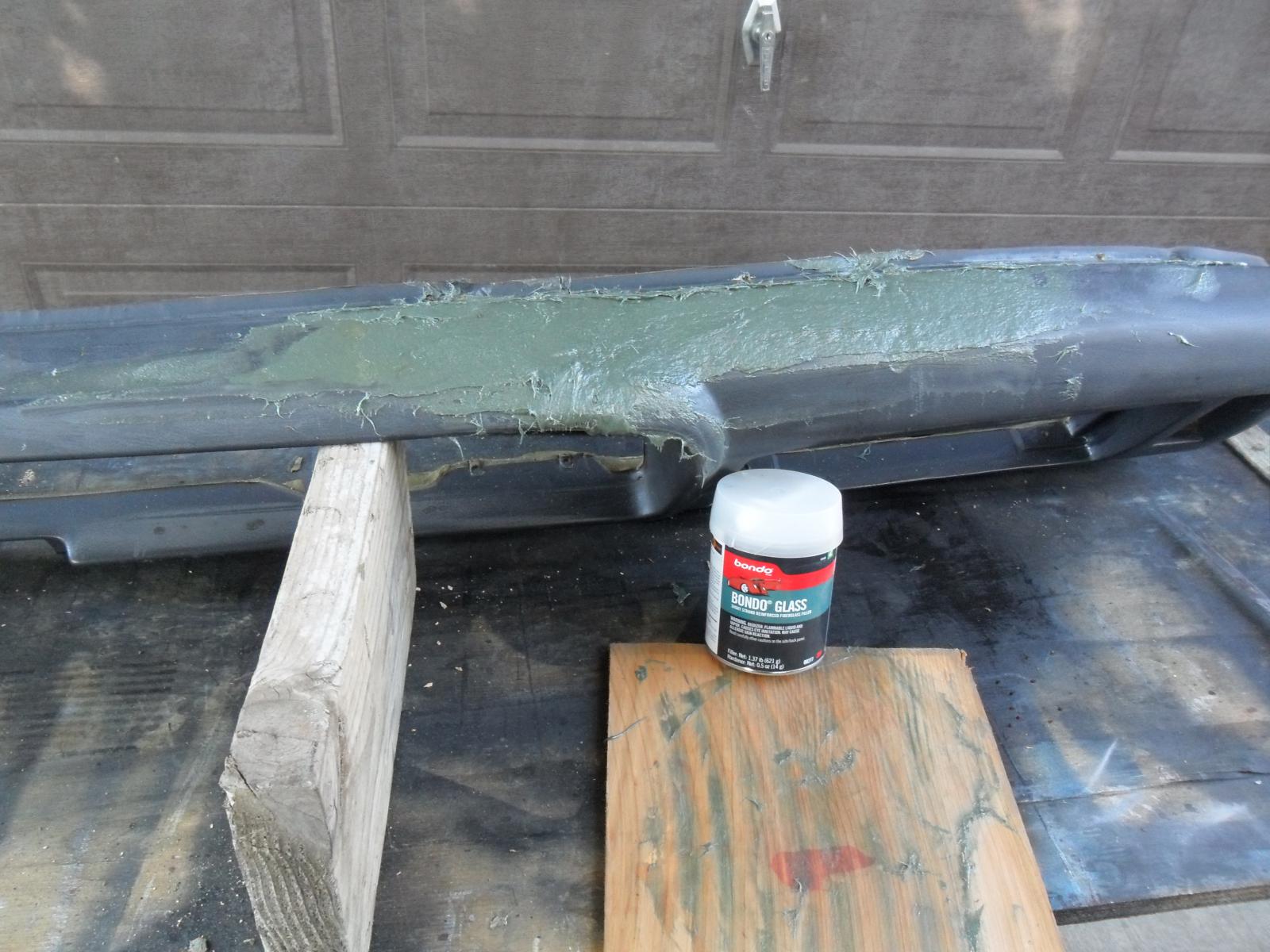

    OK here is a picture of the experimental pad with the bondo glass before I ground it off. too much hardener.jpg

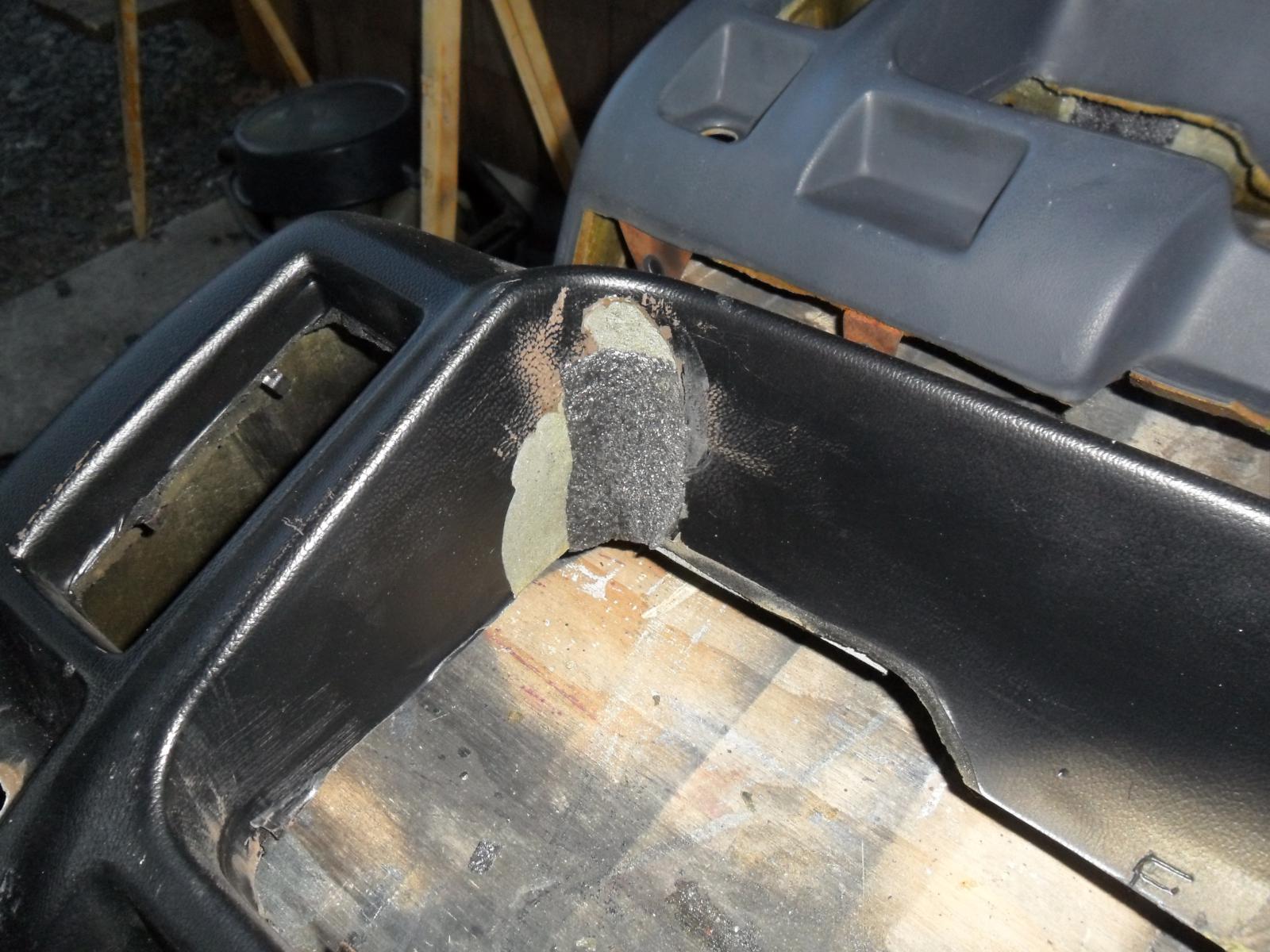

    Inside corner repair of the dash pad that is in inside corner OE.jpg I ground a lot of that off before I put the Shoe Goo on it and it was still very tight for the instrument surround.
    Here is a picture of the top of that experimental pad after I did some repair before the bondo glass incident previously shown practice pad.jpg
    EDIT- I grabbed a lot of screws and bolts that weren't rusted while I was on my JY runs to get this stuff back together right.

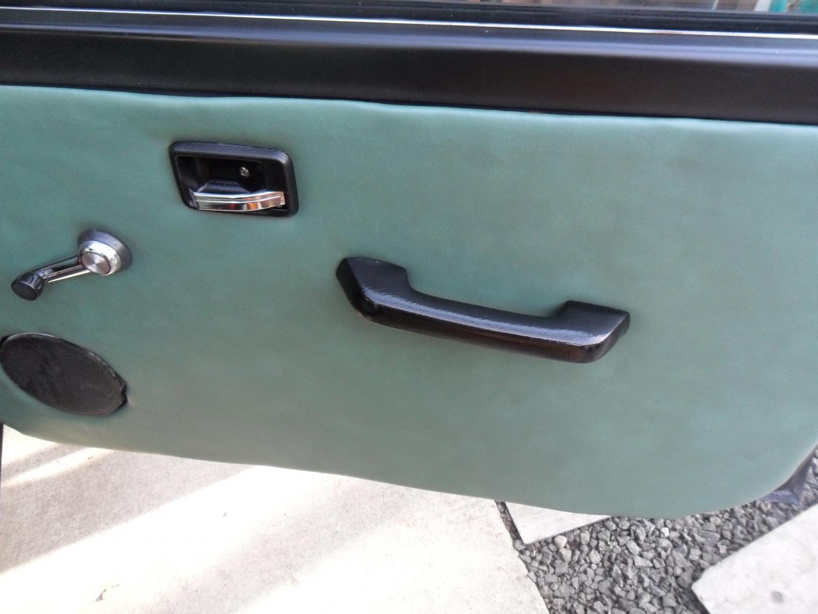

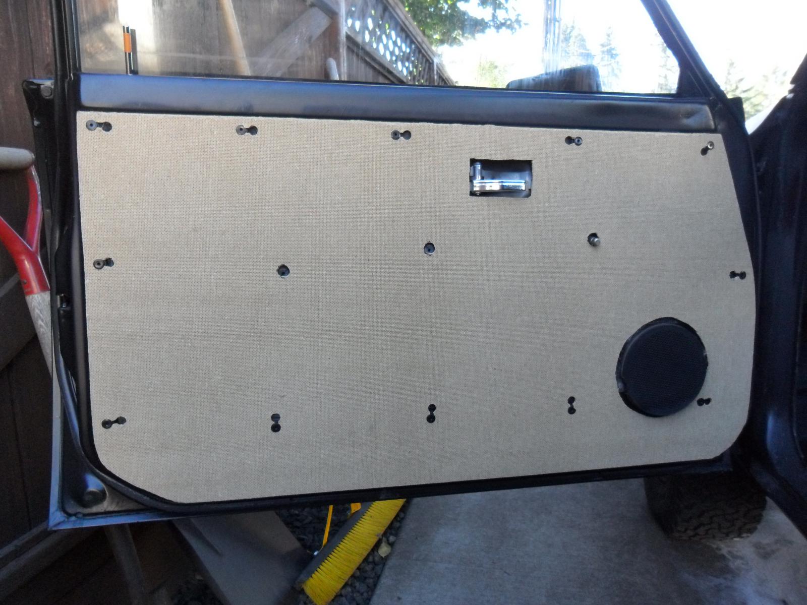

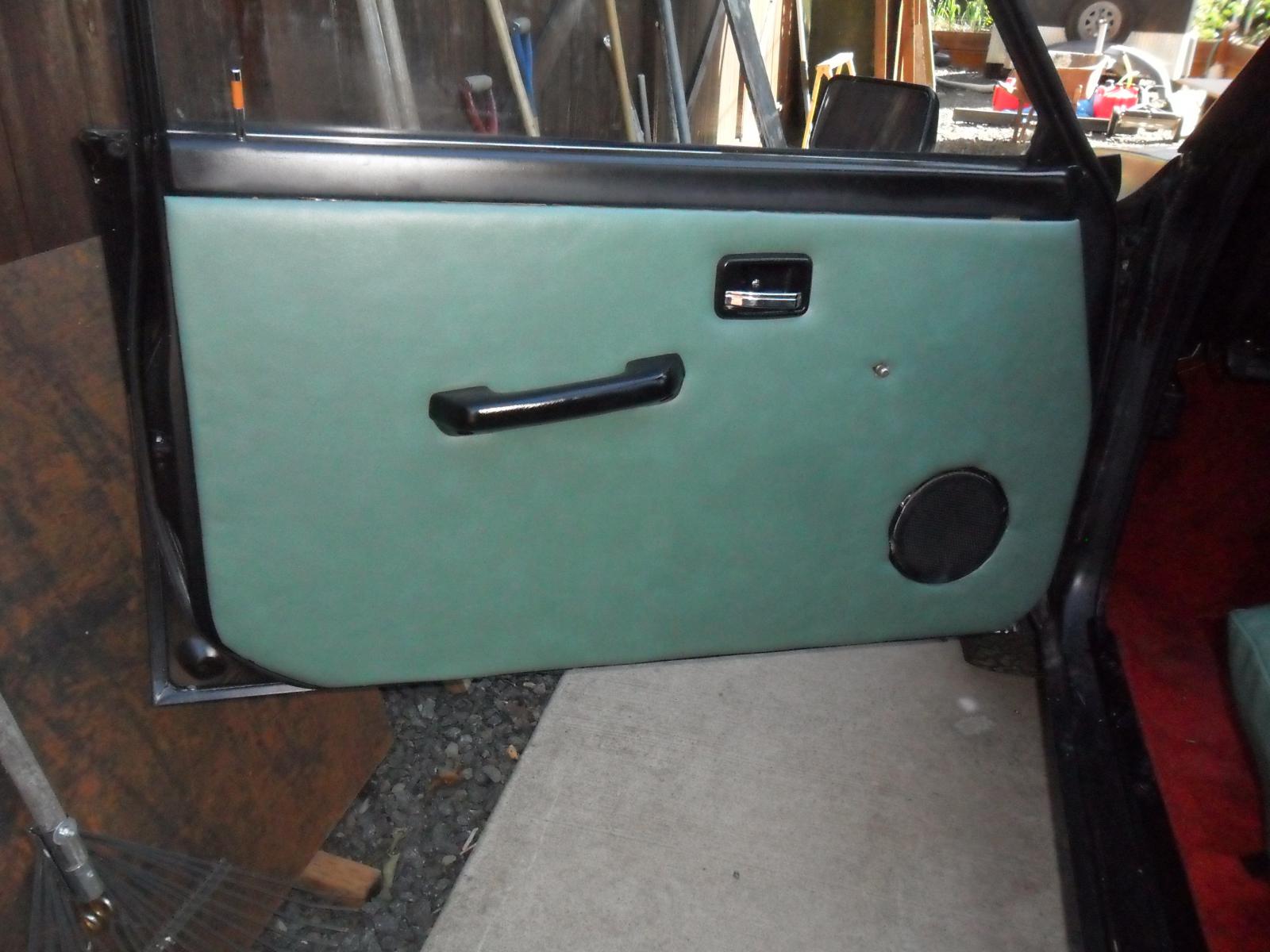

    If this I am proud! I made new door cards. I used the old connectors as I could not buy new ones locally. I had to glue in a couple of the inserts the tabs pop into on the door as they were coming out when I removed it. Get a plastic too for doing this it's too riskytrying it by hand. Even new this stuff isn't as string as you'd like it to be. I took an old doorcard from the JY not as warped as my own. I made it fit my cutouts on the door and traced it onto new card stock, 1/8"x4'x8' sheet $13. the cards I got were from a better model than mine and I did not grab the arm rests or the screw inserts for it which are longer so I had to use my old card to get the arm rest holes right. I have it covered in headliner foam now and I will either get the same vinyl from the guy making my seat cover or some dark leather color I saw at the fabric store when I got the foam.
  7. #32
    Nice work It's not as easy as it looks either. The good thing is you can buy the plastic threaded mounting lugs to replace the originals, but I've found that some need a little sanding to fit into the knock outs in the sheet metal as they can be really hard to press in. A word of advice - don't use spray glue to attach the new material if you have foam padding. It will leave permanent dents in the door trim the minute you touch it.

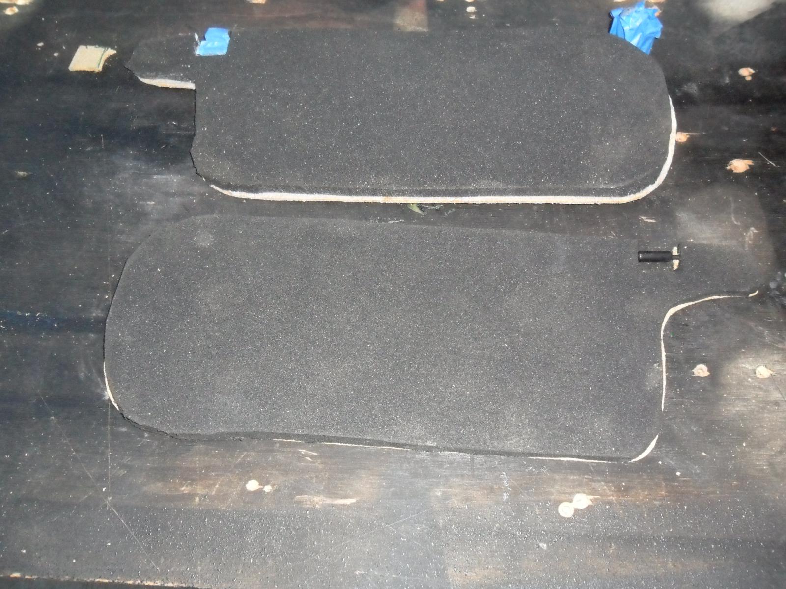

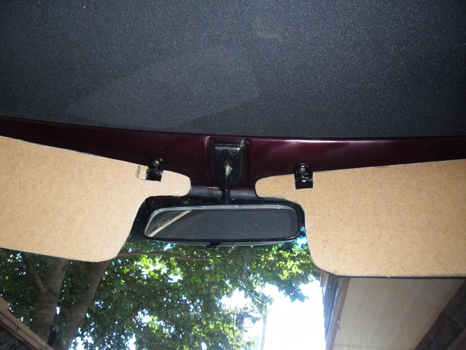

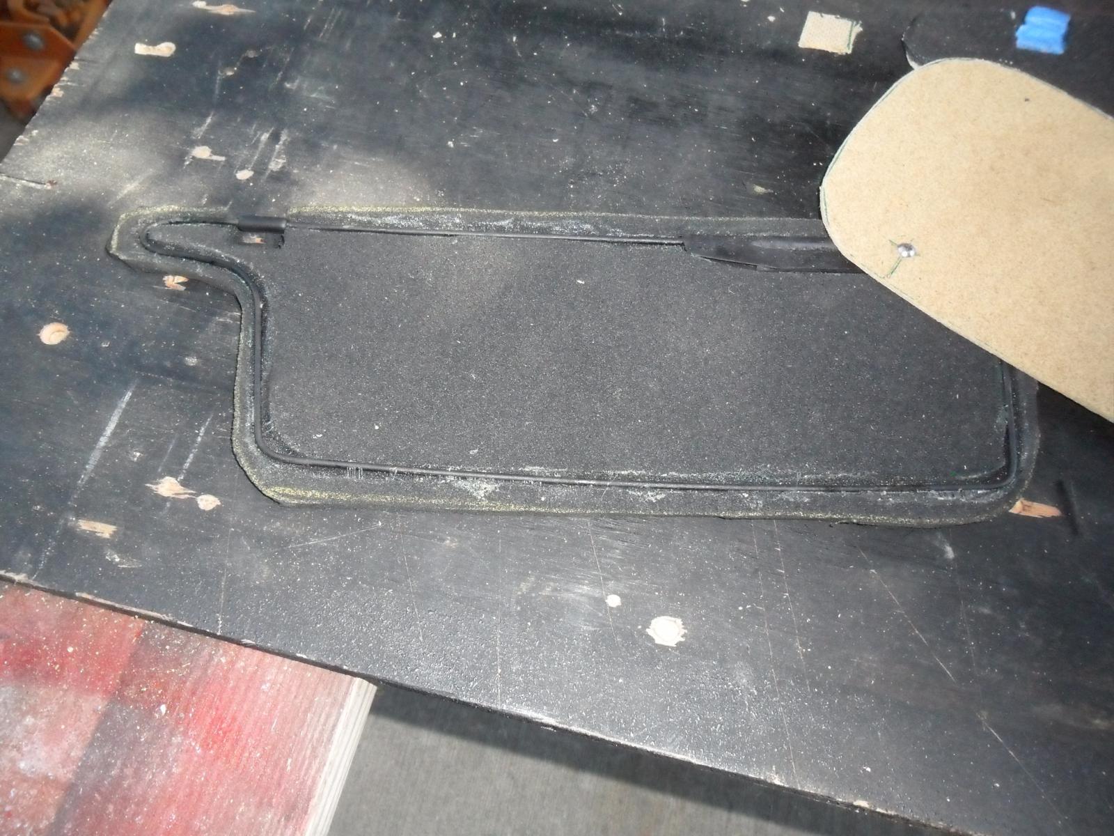

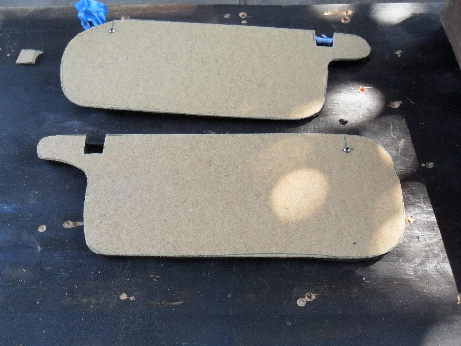

    Edit-I made new sun visors. not yet complete. the one that works is glued together, the other is awaiting me finding one at the JY which is closed for labor Day. I will cover them in headliner cloth and eventually if I can manage it vinyl. The middle picture is of the inside where I glued the frame into some foam rubber. The board side will be the side that faces inside where you hand will be putting pressure on it. The black stuff is a kind of expanded foam rubber, Basically a fullly petro product with no rubber in it at all. It smells like recycled tires.

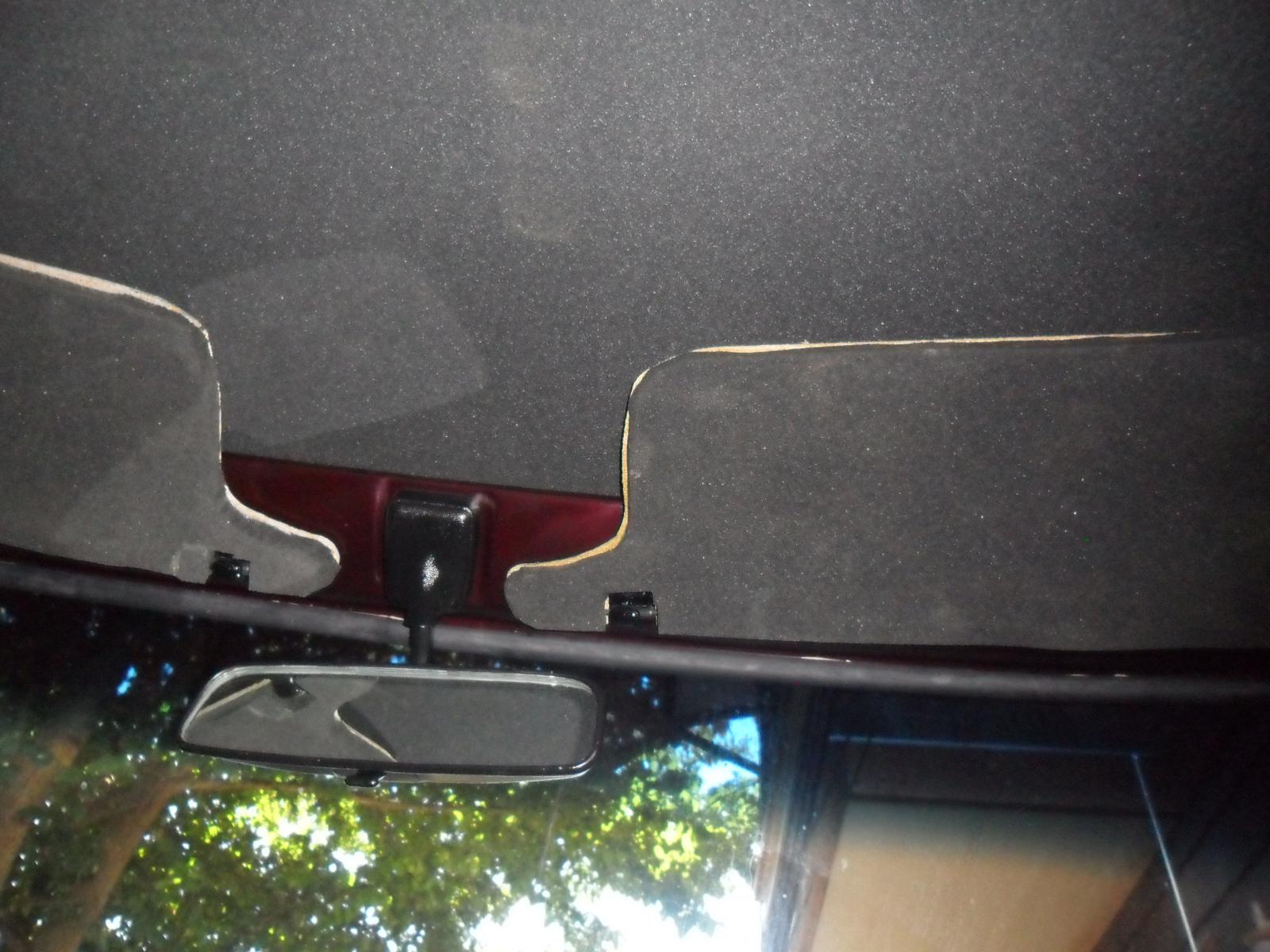

  11. #36
    10-29-2014
    1,286
    Earth, the Solar System
    I have not covered them yet but I got the parts fixed and installed them to make sure they fit right. had to adjust one. Ignore that paint color. It was on sale for $3 and change a can and it looked a lot more like candy apple red than whorehouse purple on the computer.

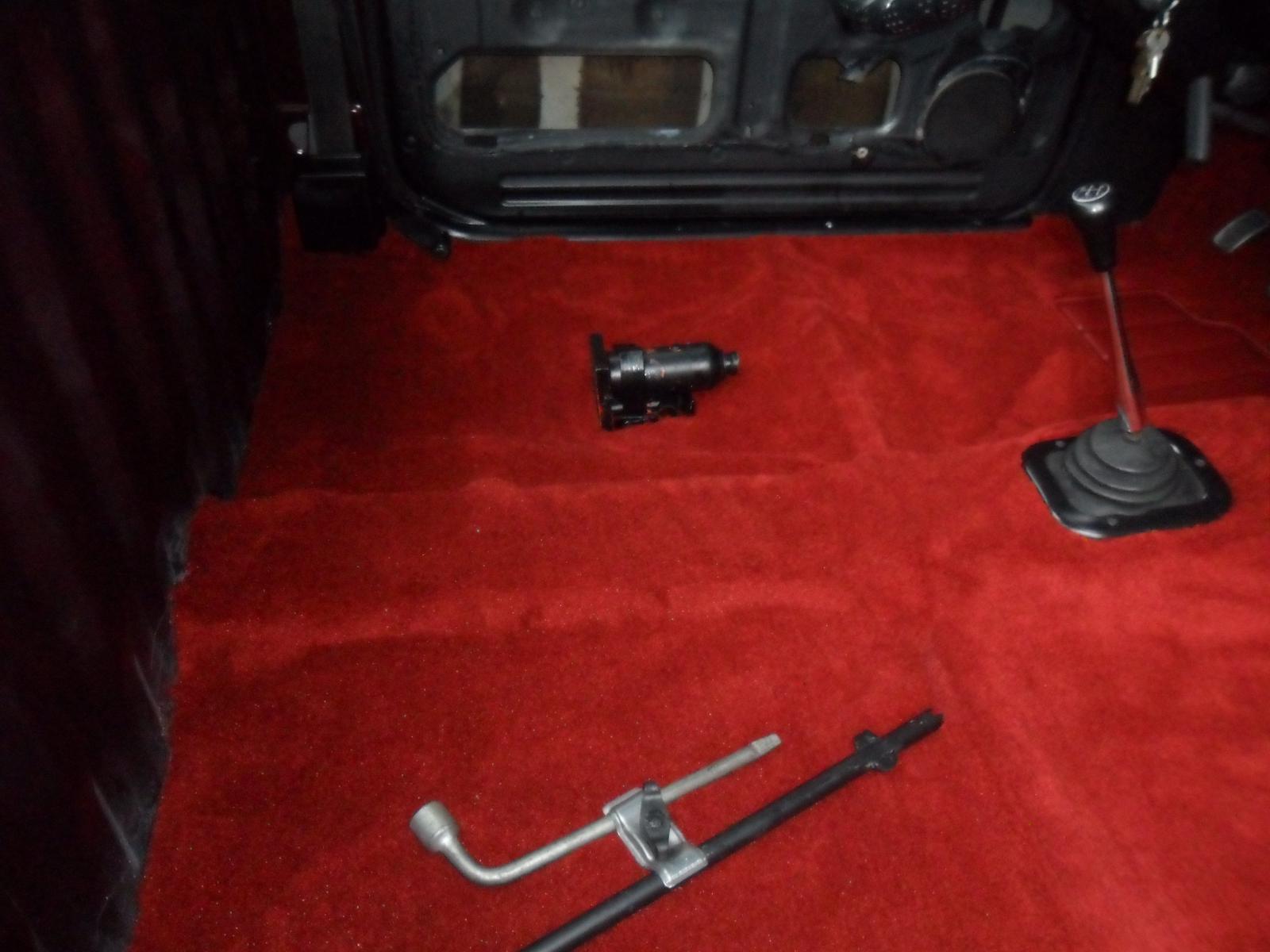

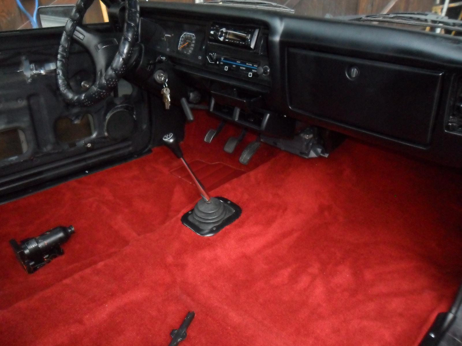

    Carpet is in. got the cheapest one off RA. It still had mass backing under where your feet go. Most of the cutting is along the back & sides then for the steering column. and gas pedal, and a small cutout for the heater mount on the bottom passenger side.Not my best work but its nicer than it has been since I owned it I guess I'll have to call and ask about when the seat cover and roll of vinyl are shipping on Monday.

    Thank You Royster. The cards are iffy. Driver side nice passenger side I got to tricky when I should have just made another one. It is in right now. The top cut line was a bit wavy so I used some corner bead to make the line straight. The bead did not stay flat and it gives a visible second edge. The driver was fine so I did not do that again. I need to get a clip for the window crank and the doors will be done. Next stop gluing up the vinyl on the headliner. Should have done that before installing teh seat and carpet I'm still not sure how I will do the visors. I may go to a seamstress or upholsterer to get them covered.

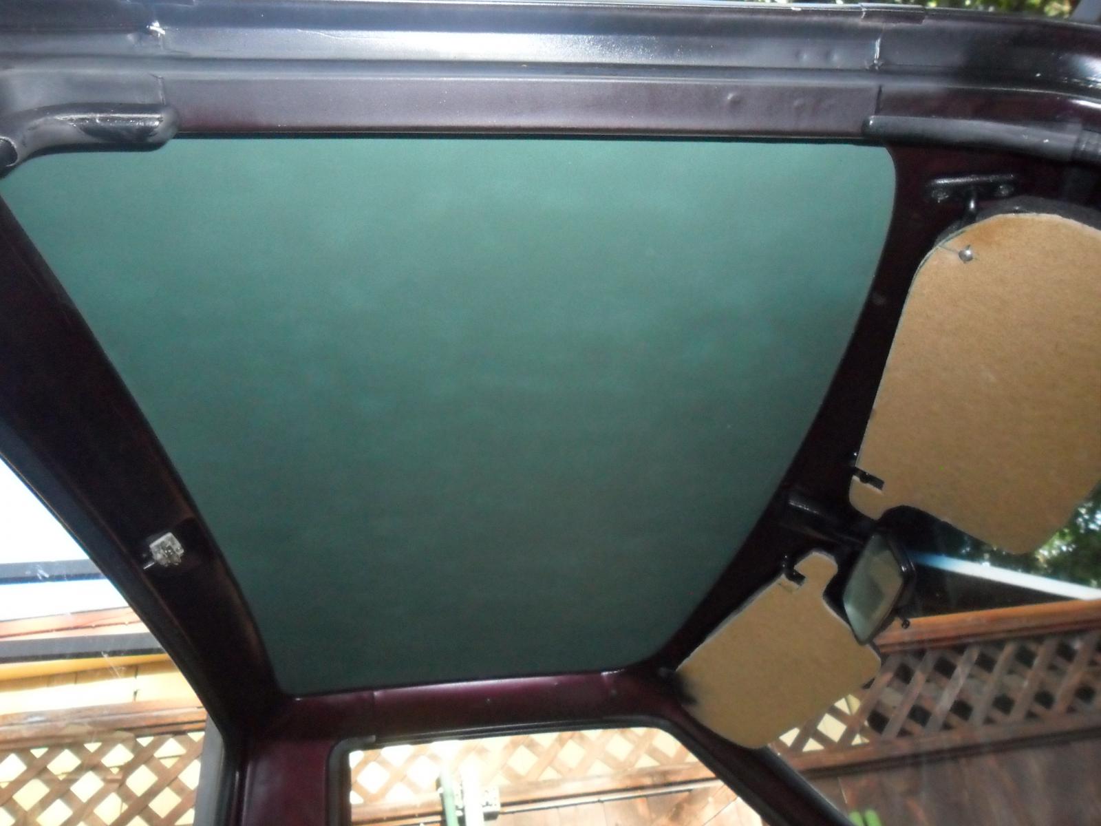

    Everything except the visors is done. The professionalism on the bench upholstery is mostly due to the manufacturer who made it. I just installed it. I ended up trying and succeeding in removing the corner bead I used along the top of the passenger card. I used my mothers Iron to smooth out the line it made in the vinyl. Used a doubled towel and steam to do it. You can see the wobbly spot I was trying to hide above the handle. Nothing left for me to do now but make the motor run right. Maybe next summer. Lots of yardwork to get caught up on.
