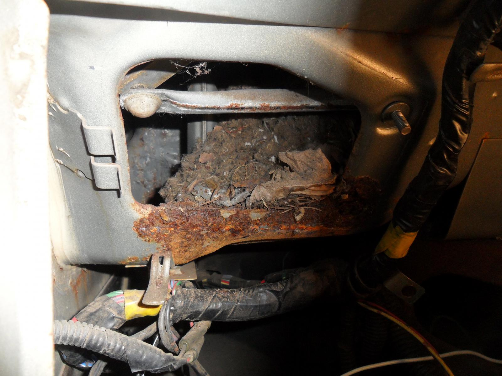

    It was me who paid to get the mouse nest removed. The PO told me about it he did not know where it was. The shop I paid told me it was in the heater. He lived in the forest and it had been parked in a car port for a while. It is basically repaired. I have a piece of sheet metal cut and fit with the bottom bolt stuck through it. I have a rag soaked in Ospho sitting on the rusty stuff. I need to get more Ospho and I will really soak it until its black then I'll attach the sheet metal.
    I've taken out the heater flushed the core with vinegar let it soak a bit then flushed it real good. It seems like it was flowing OK to me but IDK how much it should take. Any way there was a lot of dirt I could not see when I grabbed it and installed it. Those compression clips are no longer rusty anyway. I cleaned it of all dirt and I forgot to remove the little coil thingy and messed it up. The fan quit on me while I was refilling the radiator.
    I'm going to a JY tomorrow that has one of these I hope there are enough parts to make the drive worth it.
    EDIT- IN the FSM its called the Heater Resister in the diagram of the heater.
    Anyone got a part number for the blower motor resistor?
    EDIT2- I solved the problem. I got another used one that was not damaged.
