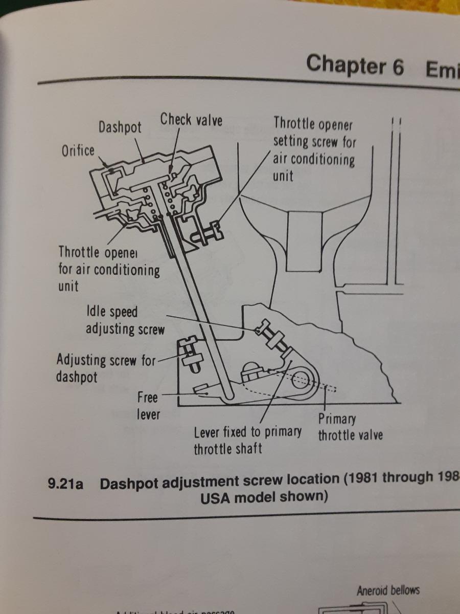

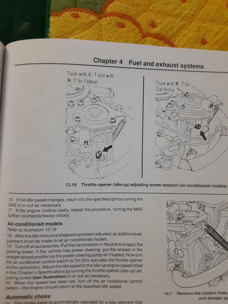

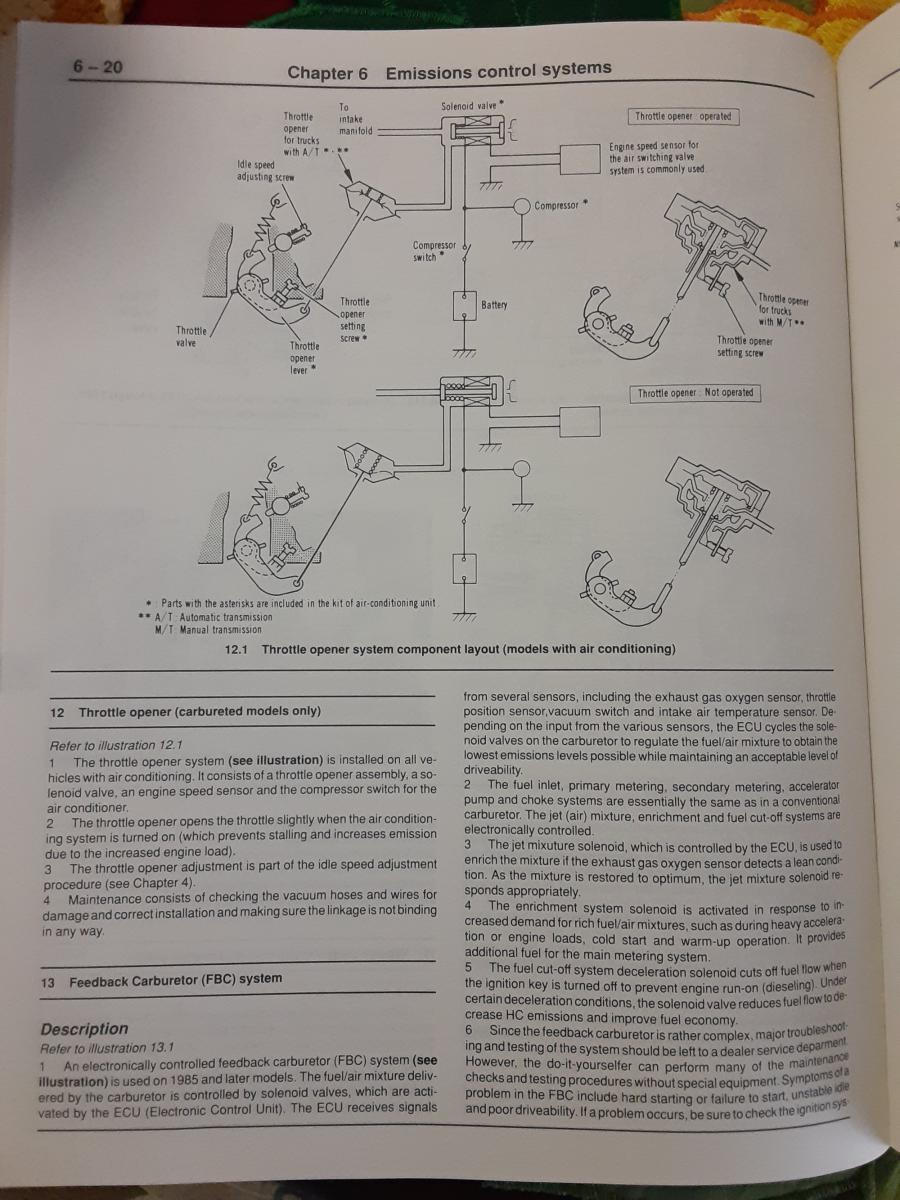

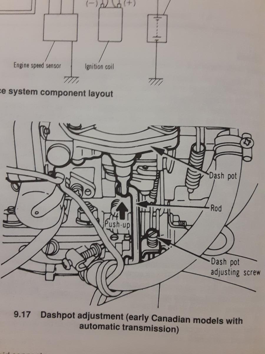

    xboxrox thanks. It is running OK and starts right up as long as I remember to start it every third day. I was hoping the electric fuel pump would cure that problem.
    Its mostly for hauling stuff to my house. Definitely nicer to drive and I'm still not used to that. Gas gauge is moving, not sure its accurate as it went below F then back up to F on the last trip and I'm only at 40+ miles on this tank. It tends to drop fast once it hits 3/4. I am going to have to make some time to try setting the timing again to see if that stops the idle from increasing as it gets warm.
    It just occurred to me. If this thing had an OE AC what or where is the setting that would turn the engine idle up ? I'm pretty sure the PO told me he removed it among all the other stuff he took off.
  9. #59
    1,582
    Here are some photos of the dashpot idle adjusting from the Haynes Manual: (I dunno if that's the cause but you could check)

    Thanks Xbox but that is all Greek to me and too small for me to see. I doubt it is the cause since this thing only has a very few wires connected to the motor.
