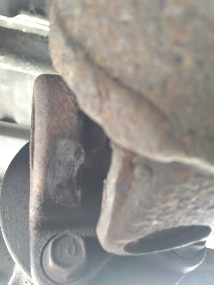

    Hello all,
    I am looking for the name and hopefully a part number for this part I've looked at many diagrams and the part is shown but not labeled. I did look at the Haynes book on the site and it is listed as a Flange yoke but I am unable to find it under that name on parts store.
    As you can see in 2nd image I have a nice chunk missing

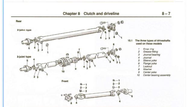

    In this diagram from Haynes book it is part number 6 that I am looking for.
    Thanks in advance for the help :D

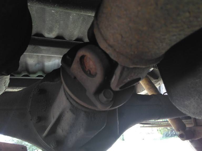

    Look at the diagram here. If you are trying oin person print it out to show the parts people. http://www.mightyram50.net/d-50/Fact...e_u_joints.pdf
    also known as the pinion yoke - there are 2 sizes. One for small u joints and one for large. Small is on the 2.0 trucks and some 2.6 auto extended cabs, and the rest are large.
    *a side note on something I found out. The small universal joints and yokes indicate 0.5 ton load capacity - the bigger joints and yokes are for 1.0 ton trucks.
