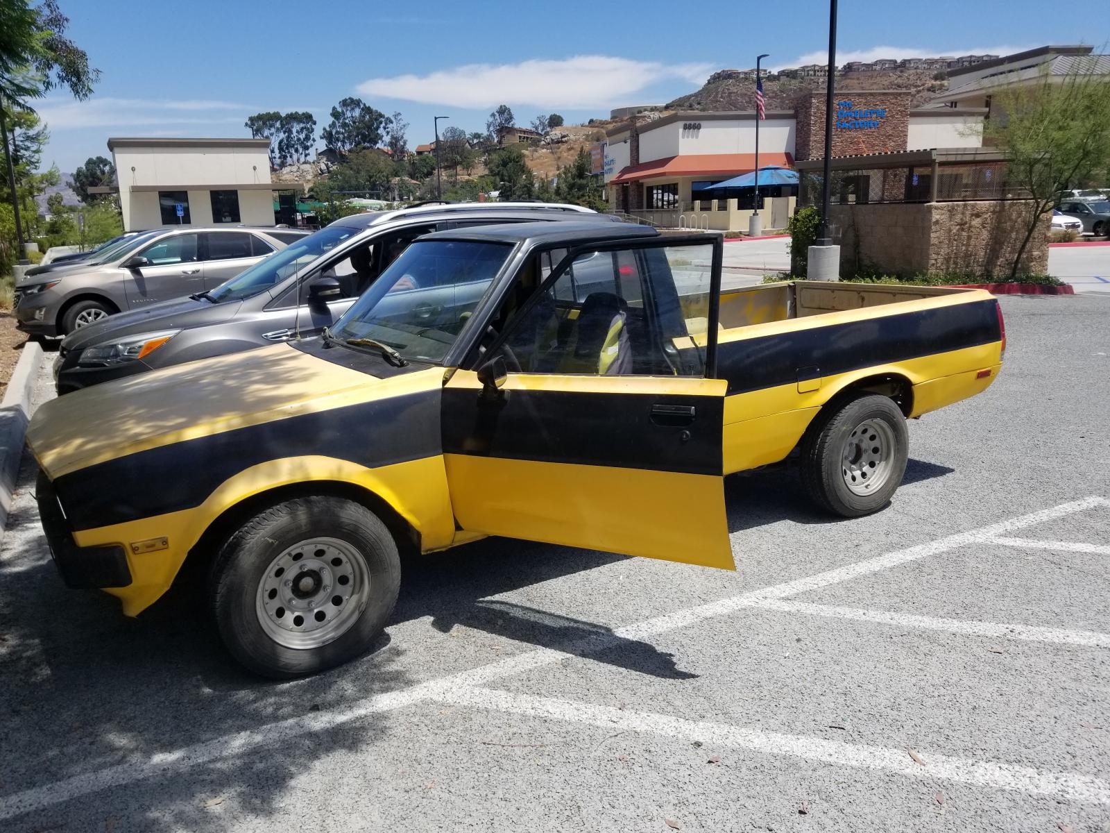

    On a side note the previous owner loved this thing and gave it the name bumbledee! It's pretty fitting huh? 20190804_132202.jpg20190804_132202.jpg

    Welcome to the forum! Do keep us posted on your progress, and definitely post more pictures. (Note the forum has a Gallery, too, where you can post a photo album).

    Share some more pics when you have a chance, from other angles too.

    Wow I'm not making a good impression, lol. I was tired yesterday and didnt realize that the tire was dirty so it looks like 185 but it's really a 195 too. They're all the same. I'll go do a photoshoot and make an album titled the bumbledee soon.
