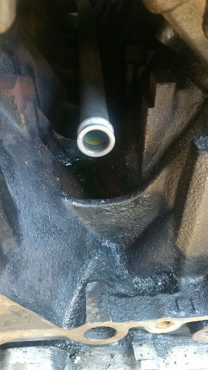

    I'm changing my timing belt which broke on my MM, and I can't find a parts house that correctly identifies the O-ring that is on the tube that goes to the back of the water pump. The tube is in between the two banks of cylinders under the intake manifold.

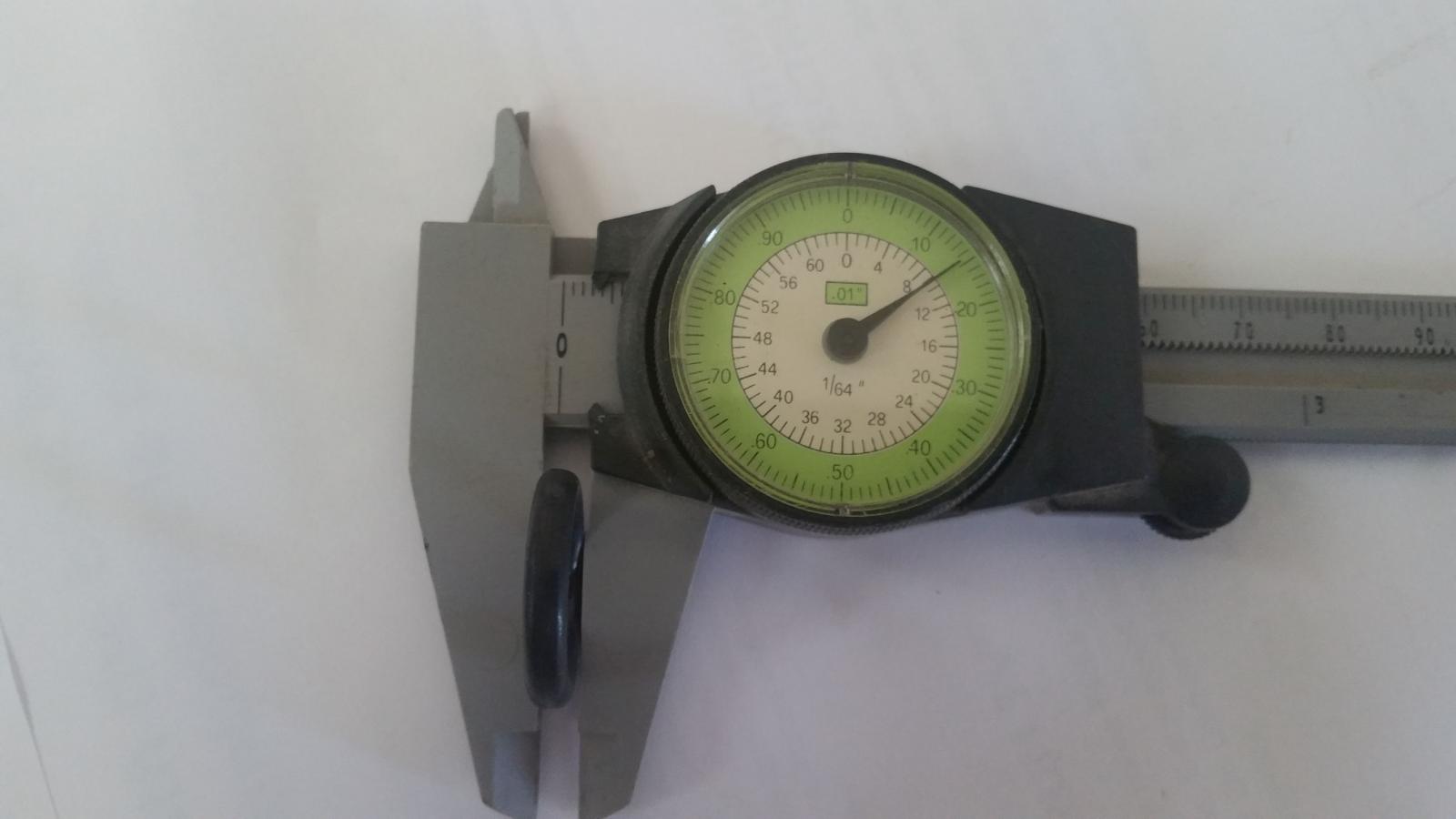

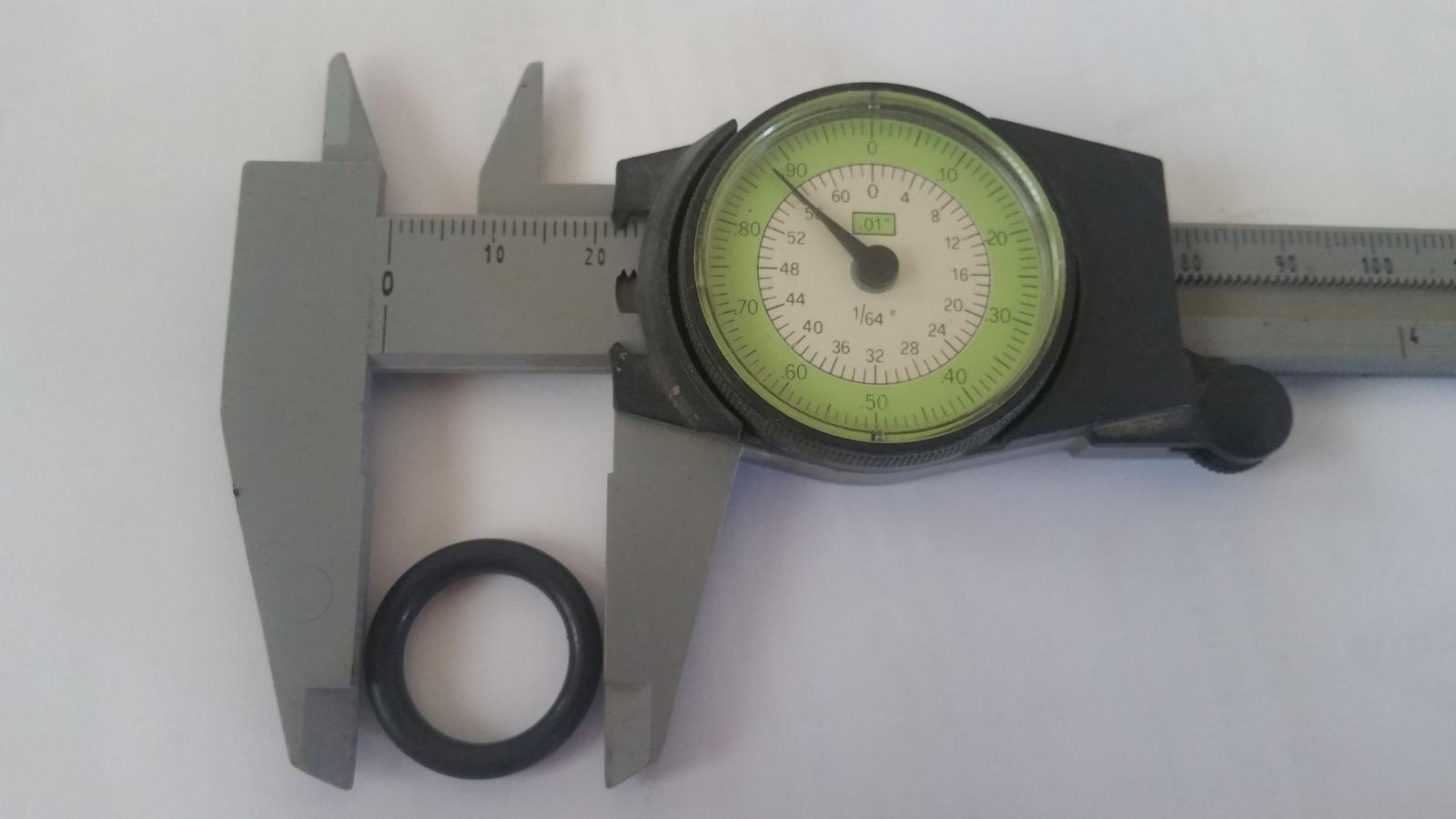

    The O-ring is about 13/16" outer diameter and 1/8" thick.
    I have included pics to show detailed dimensions with a measurement caliper and where it is from in the cooling system.

    I got that, I was asking so I could ck the pipe part #'s between the auto/manual
    equipped vehicles as there are 2 different #'s.
    Your good to go, only the auto# is obsolete.
    Now onto the o rings, (really like the caliper btw,metric,thousands& 64ths all in one!!),
    I 'think' I have located a non -Mitsu source, as My dealer connect has not gotten back to Me...
    Could I impose for an I.D. measurement ? ,
    Thx!

    I found out o rings are 'sized' by cross section (cs) & inside diameter(id).
    Makes perfect sense as different cs with the same id = many different
    outside diameters .
    Edit,
    8-10$ each # MD030764 or
    V4.00X016
    $1.88 each.
