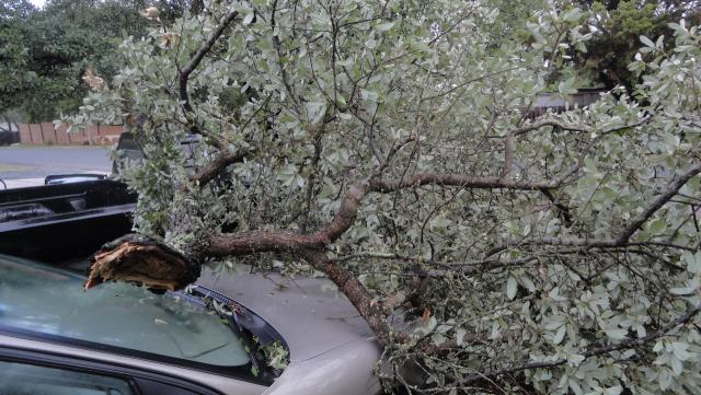

    Tree in the drive way lost its top ( good thing it did not take the power lines with it ) and fell on Single and the wife her car. No damage to either vehicle other then saw dust and such after I sawed my way through.

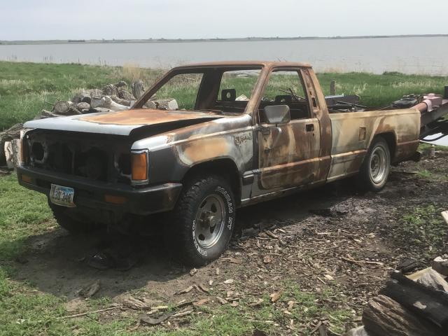

    You think you have problems? LOL 6 grand up in smoke from a brush fire.

    damn, thats a shame, mines about the same, but jsut from being parked outside here where its always wet enough to runs lol

    Owshy That is a shame Law Dog. Mine are losing paint on the outside and have plenty of issues on the inside or under the hood. It would still seem in that case mine are not that bad. Dont have enough rain out here to worry much about rust from that. Sun baking and roasting everything is a bigger problem here in Texas. Not had any local hood fires yet. Or the style of bon fire that includes a few houses.
