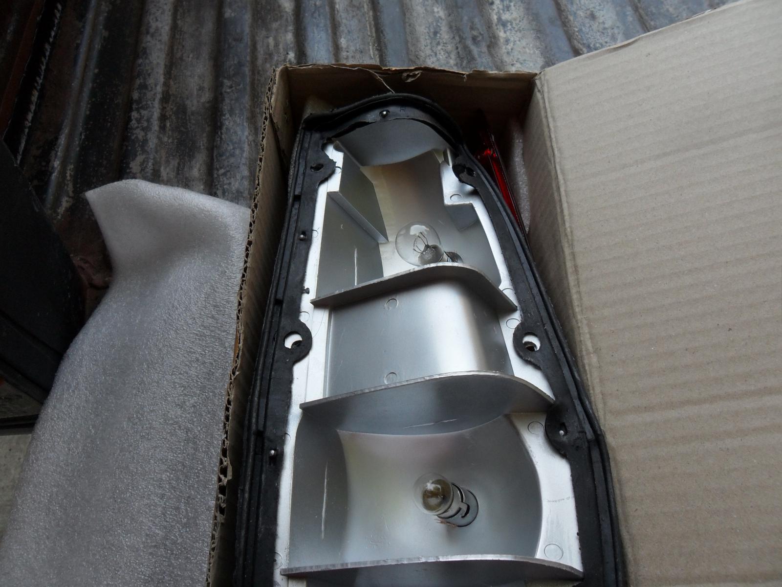

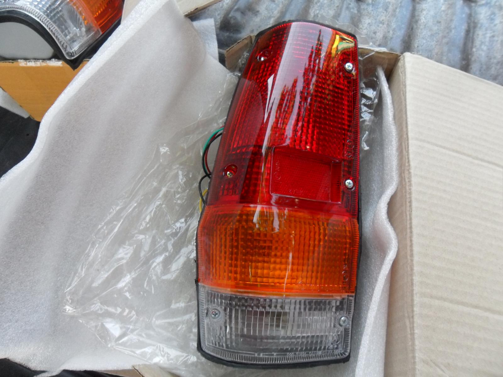

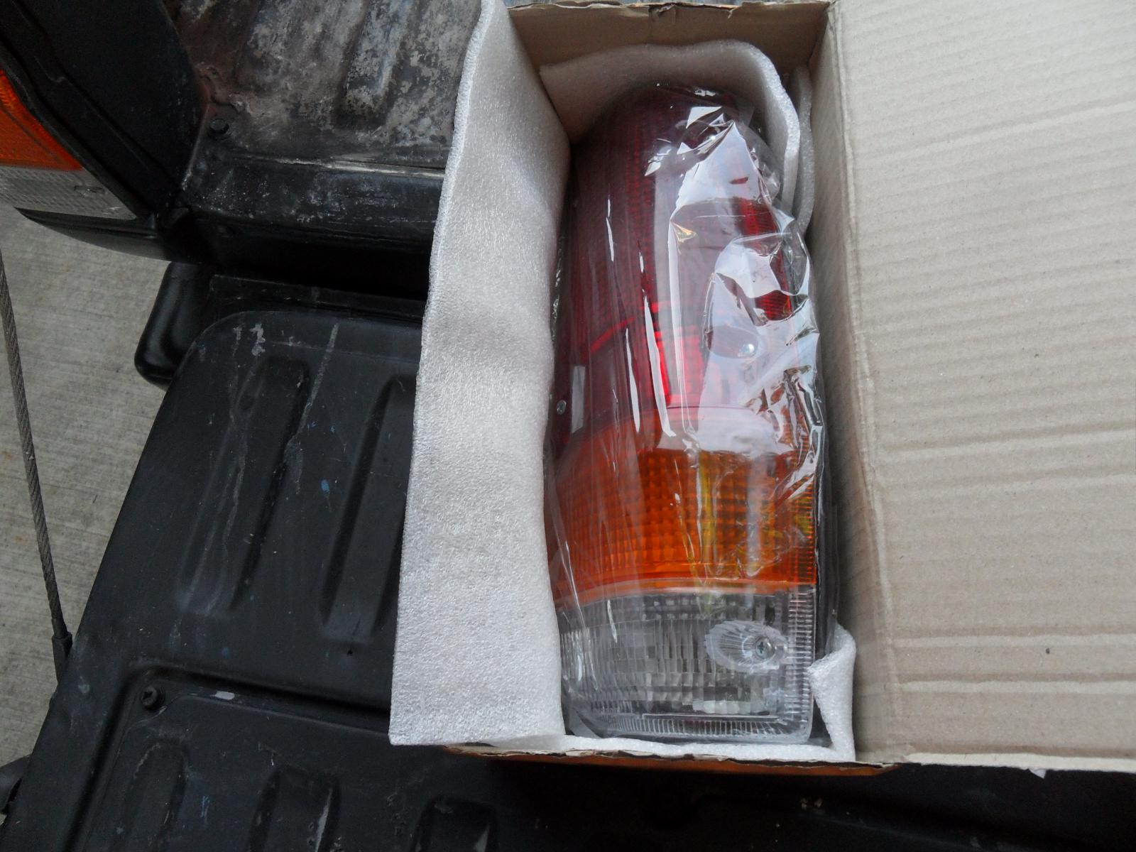

    They showed up just now. To be honest they feel more substantial then what I have in there. I guess that is because they are new. I can see what you mean about weather Tortron. I'm not going to install them until I finish fixing up with the bed. here are pictures. The wires seem small but are secure. I only opened one.
    lights.jpg open1.jpg open2.jpg back open1.jpg backopen2.jpg inside open1.jpg

    Well to install the tail lights I had to bang in that middle piece of metal that goes across the hole and it is still iffy. One black wire came loose. I had to pull the one it paired to and the blade from the connector then solder them together and put the blade back into the connector. One backup light didn't want to work when I started to remove the screws it came on?
    So I probably did not get a good deal. Here are some pics of the fit. I might contact the seller to inform them about the fit and the wires.
    Yep the repro tail light lenses I bought have the same issues. The chamber dividers don't fit properly, the rubber seal around the casing doesn't seal that well onto the edges of the lenses and they sort of don't fit that well once assembled and installed. This is how they are. I have both the OEM assemblies and a pair of old repros and the repros bulb sockets and wiring are pretty ordinary quality wise. I am considering cutting up the repro lights and modifying them to run LED panels in them (I'd feel bad about butchering OEM's unless they were already busted up)
