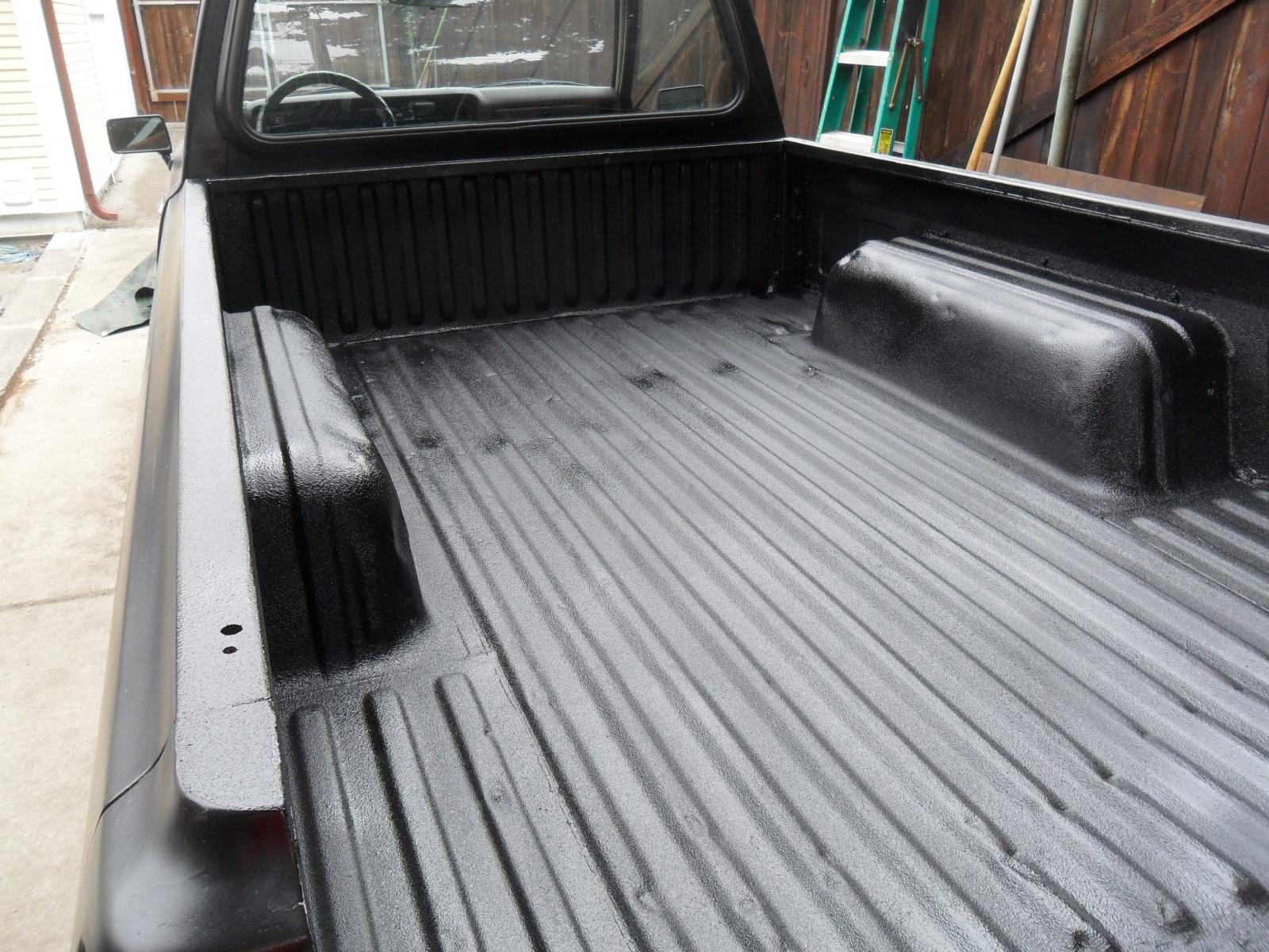

							Got all the skirts off. Have the holes plugged with JB weld. It is drying once I am sure it is sealed I will put the panels back in and clean it so I can spray the Upol bedliner.
			Masters Degree
							Got the bed done. I was not happy with the primer cans. They started spitting globs from the start and did not fully discharge. I was not able to coat the tailgate with the epoxy primer. The Raptor sprayed like a dream and I have no experience other than about 20 minutes of instruction on how to paint 39 years ago. The 10gal air compressor I bought for the job worked fine. It ran a lot but there were not hiccups. I never had to wait for it. I used a setting around 55psi+. The gauge is not broken down smaller than 10psi increments. So if any of you were ambitious enough to try it go ahead. The prep is the hardest part.
When it is dry I will get the lights back on and test drive it with my new fuel pump.
Edit- Well it is dry to the touch. 7 day cure, 72 hours stay dry and it has started sprinkling.
