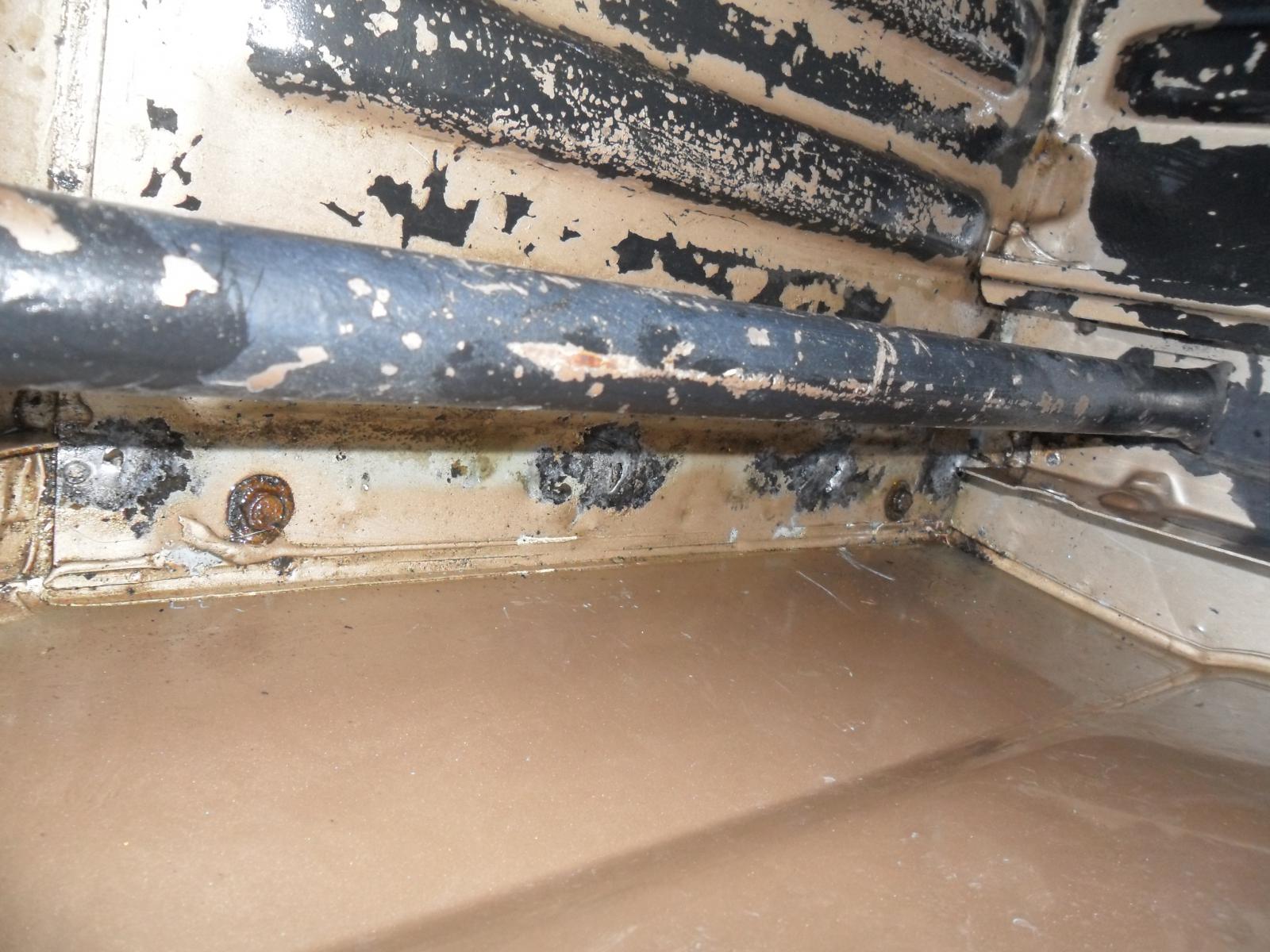

    Drilled the ones that didn't come out. Most just went to the bottom of the head and came loose with a bit of the thread shaft showing. the rest broke off with a chisel. Here are pics of the rust with the panels off. The rest looks surprisingly good for how bad this part is. the panels have surface pitting I should be able to reuse them. Does anyone know if these angle pieces are welded or installed with adhesive? Here are pics

    MrPaco, I had painted the bed with something that was supposed to be bed liner that wore off. It peeled off where I did not sand down the clear coat. As far as rust what you see on the bed is superficial. I would expect any rust reformer or converter, rustoleum, and regular paint would be enough. If you are going to use it for dirt and gravel you should paint something stronger on even though it will wear off. I have seen some kits in the parts store for around $70+ but I have no idea how good they are.
    Edit- I got something called Skyco Ospho that is supposed to convert rust to an oxide that is stable and is meant to be painted over. I have not applied it to the bed as its wet from washing and it is going to rain. I sanded the panels some and brushed them all over. I got it at Ace Hardware. I wasn't paying attention it cost me $19.99 for a quart and gallon is only $26. I'll post again tomorrow after I let them dry for 24 hours.
    tortron, I scraped and wire brushed it good and vacuumed out the junk. I have to wash away the dirt I couldn't brush off. I didn't notice any welds but I will look again. If I can't replace it I was going to treat it with a rust converter seal it with paint then rivet on a piece of steel. I could probably use some epoxy. I noticed that the reason it rusts in that area is that there is no seal along the bottom edge and as I type that I realize that means they used spot welds not seam sealer.! I will be sealing that.

    I would find a primer for rusty metal or get Ospho to convert the rust. Scrape the peeling paint and sand everything lightly so that there is something for whatever you are going to use to grip to. Wash it and make sure it is dry when you are done sanding and prepping before painting.

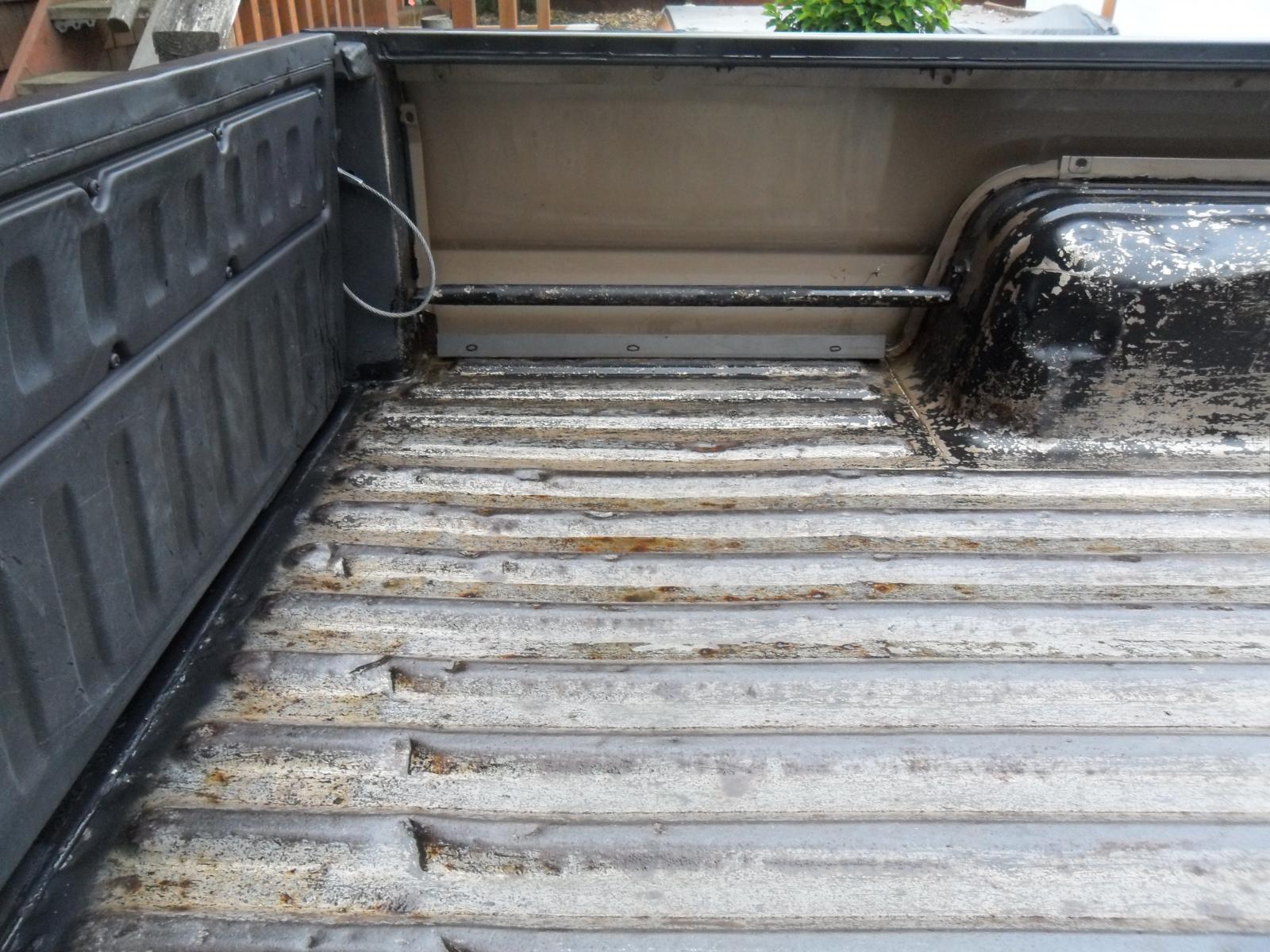

    Rain did not show and I got ambitious after realizing the difference in amount of work in polishing the turd or tearing them out and putting in new was about the same (turns out its much less to do it right) I took out the rusted brackets. 1lb ball peen hammer and 12 inch 1 inch wide cold chisel.
    Rain stayed away so I ended up painting the whole bed with Skyco Ospho. It leaves a white film and it may stain your concrete so... I hope it doesn't rain now
    OK I got some 1.25" 16 gauge steel angle iron. 1" would probably due. I have them cut to length. I will try to find some adhesive to attach them tomorrow then I will used the good ones to set the panel and mark for the holes. now pictures of the removed brackets. I made hole on the up front bracket as the screw hole had rusted out but the bottom of the angle was still strong except near the front end.

    The Skyco Ospho works OK. I had to repaint some spots that did not turn black.
    Edit-
    Still a couple spots that are on vertical surfaces are rusty colored. I tried mixing the liquid in petroleum jelly and putting it on. Everything else looks like it has converted.
    I plan to seal up with a good DIY bedliner spray the inside behind the panel and paint the bed to seal it good then put a good bedliner on top so I do not have to deal with the new coating wearing off.

    OK I haven't tried anything yet. I have it ready to clean up now but it is supposed to rain the next couple days. If it is too much of a pain to get at it with the orbital and sand paper I might go for the pot blaster. They have alum oxide, walnut shells and soda at HF. There is a Tractor Supply in a small town south of me if I got with it I will probably go there to get some media. Coal slag aint much better than coal dust for your lungs. Here she is ready to be cleaned.
