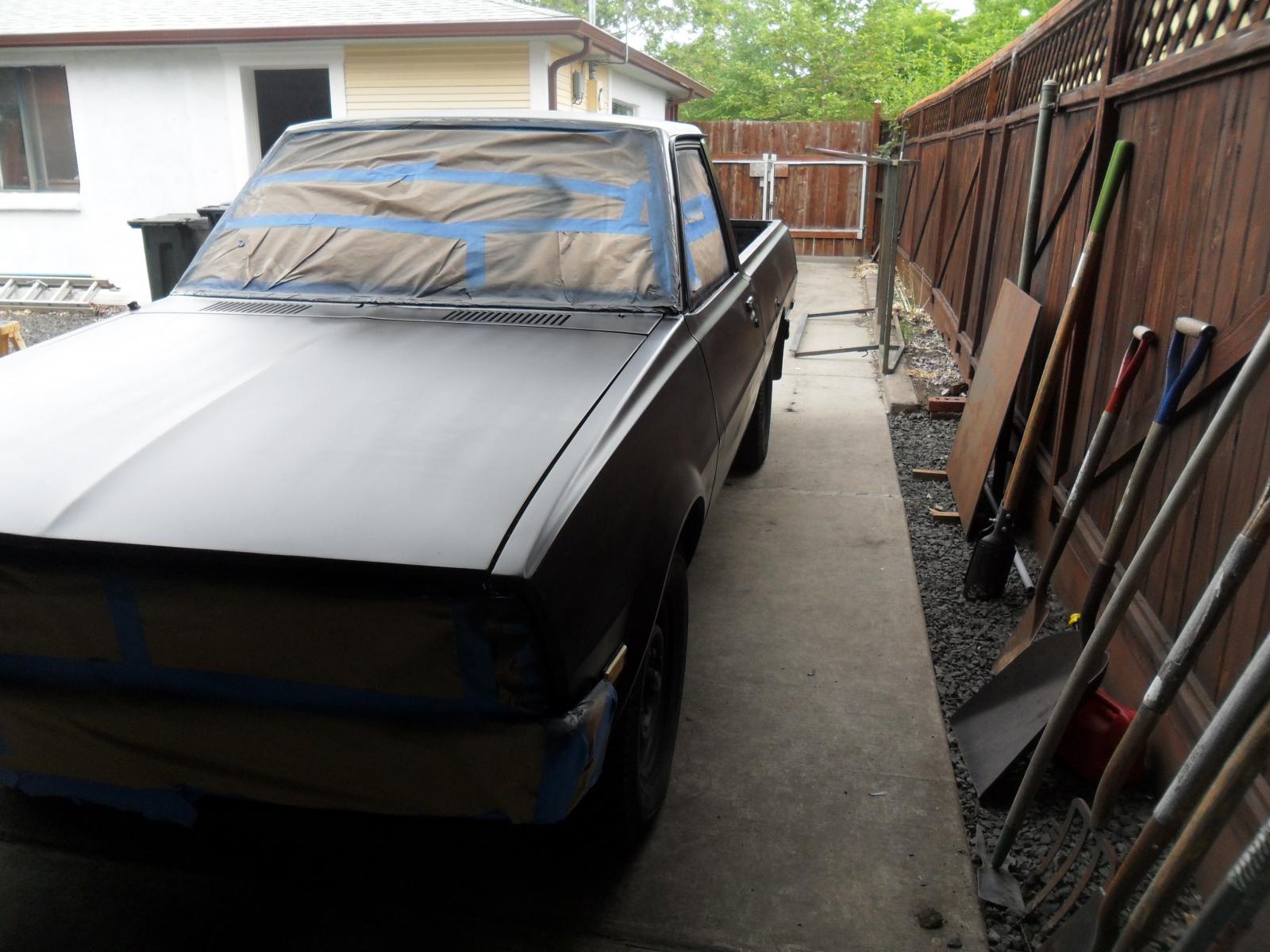

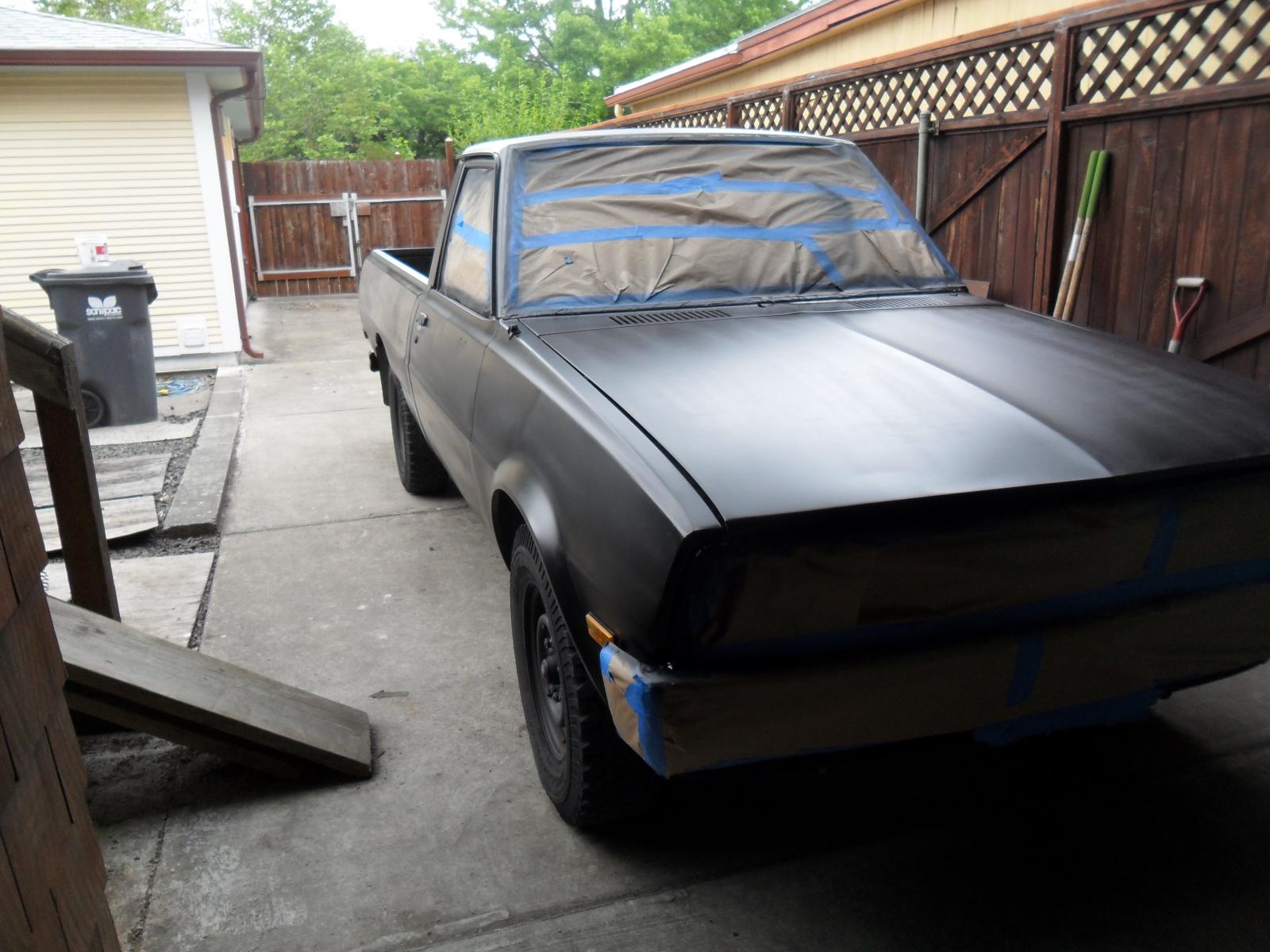

    I had the front bumper off a while ago and painted it when I finally got a new grill. I decided to go ahead and paint the rest of it since I had the lumber rack off. I just did a quick sand and wipe down (rust reformer on the rust spots) then black primer and clear coat from a rattle can. I still need more clear coat to do touch ups and the inside door jams. I did take the lights off.

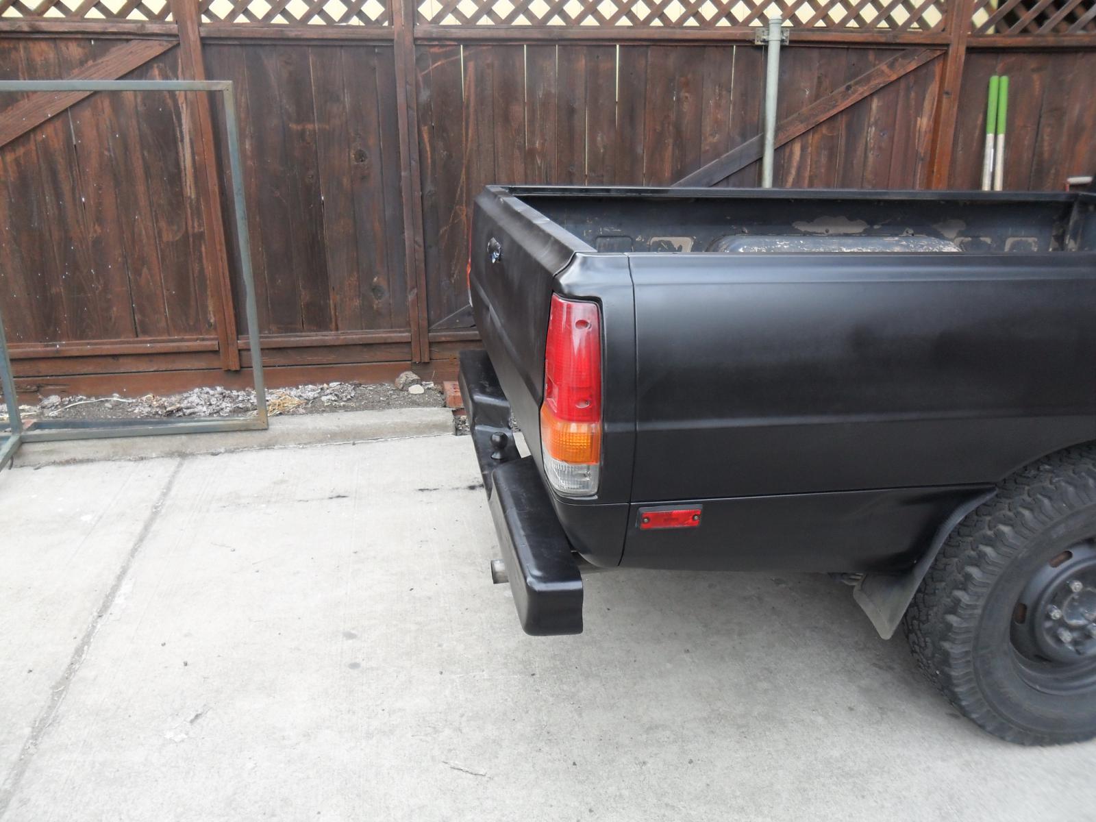

    The rear bumper cleaned up nice. I'll wait to replace it since i found out I will have to cut it off (Nice bruise) and get new mounts anyway.
    I'm debating with myself whether I should contact cement those "new" (put on about the time I got the grill) beltlines just for added security because they don't stay on by themselves and the new clips were really rusted when I pulled them off to paint.
    Pretty good for a driveway rattlecan job. Haters can hate until they've tried doing a full respray without all the bells and whistles. Better than scratches and rust!

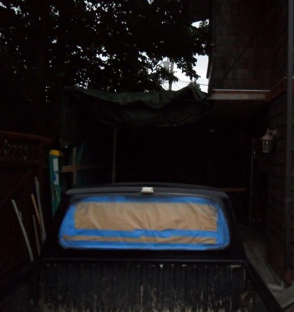

    Thanks Geez. I made a kind of paint booth really a wind break with some scrap lumber some new and some cheap tarps from Harbor Freight. I figure I only lost 4 of the 12 cans to the wind. I really need to remove the bed and do some rust treatment on the frame. But I think the motor and wiring should be my focus for tossing cash in the air now.

    I was lucky no bugs. Plenty of dust to give the clear coat some texture though. Now the inside really looks bad.
