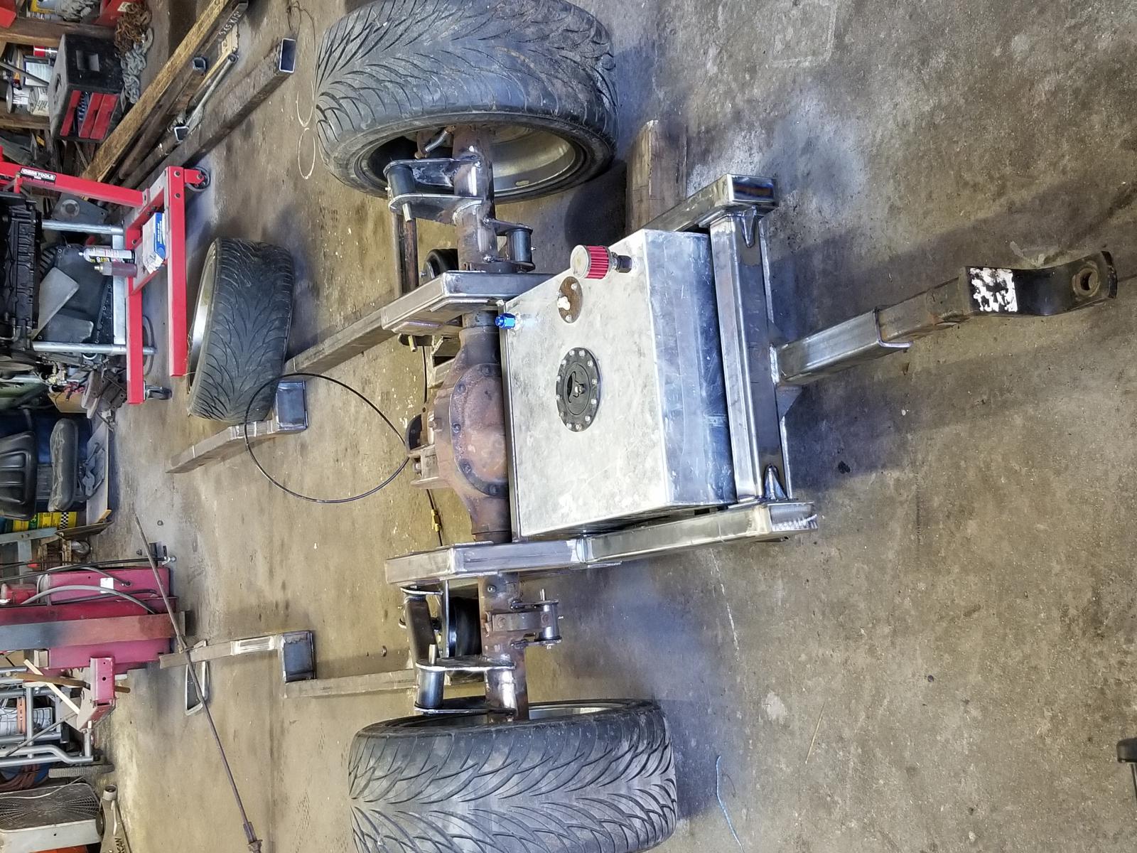

    Im still far from done with my project but i thought I would post a few pictures. Its an 89 ram 50 that originally cam with a 2.0 g63b. I built the frame from 4x2 square tubing, using a narrowed ford 8.8 rear end, 4 link suspension, slam specialties bags, 5.3 LS with a 7875 turbo and an AR5 transmission using a fabbot adapter kit

    The truck has an interesting story behind it. My parents in law got the truck from someone who owed them money for plowing, after they received the truck it sat in their yard untouched for 13 years. They offered the truck to me and of course after loving mini trucks my whole life I took it home with me. I installed a weber carb, new headgasket, plugs, starter, and bunch of other stuff and got the truck running. After driving it for over a year I decided it needed more. The truck had 93hp when it was new, no power steering, no AC, no radio, and it rode terribly rough. The cab and bed where still in great shape but being in NH in salted roads the frame was starting to get tender and the motor was getting tired. So I decided it would be easiest to just start over than try to fix an old frame that might not last. and the LS... thatll solve the 93hp problem

    Thank you! the wheels are actually off my old subaru, Due to using subaru front hubs, and the ford 8.8 (5x114.3) they bolt right up!

    I considered a ton of different engine swaps, I wanted to do something crazy like a duramax diesel, or a 2jz. After looking at the cost of engines and transmissions the LS was just so much cheaper. Complete engine for $500, trans for $300, Standalone ecu and harness for $1000. I tried to avoid it but considering the cost, parts availability, and reliability, it seemed like the best swap for my situation. I know i could have easily done a turbo 4g63 or something similar, but thats been done before

    Got some more done on the front end. Hoping to have the cab on by next weekend

    Got sick of tigging everything, going to mig together the rest of the front end, just have to build my upper control arms and it will be done

    Sometimes you just gotta go for it, I dragged my feet for 2 years wanting to do something cool with my truck. You dont need crazy tools to do something cool. Most of the work on my truck is done with a welder and a grinder/cut off wheel. Sure a plasma cutter and all kinds of other stuff would have helped me out but it's about working with what you have
